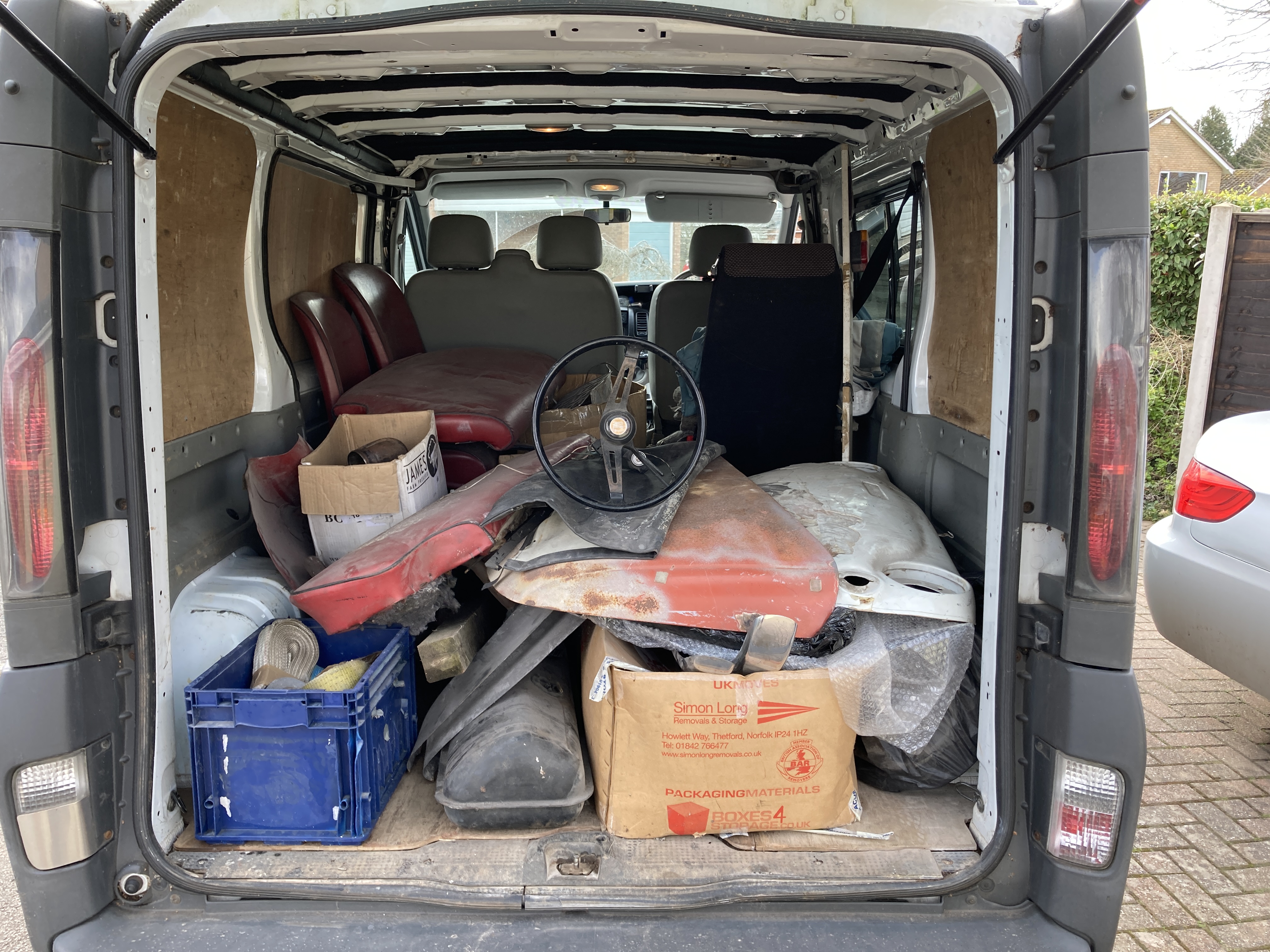

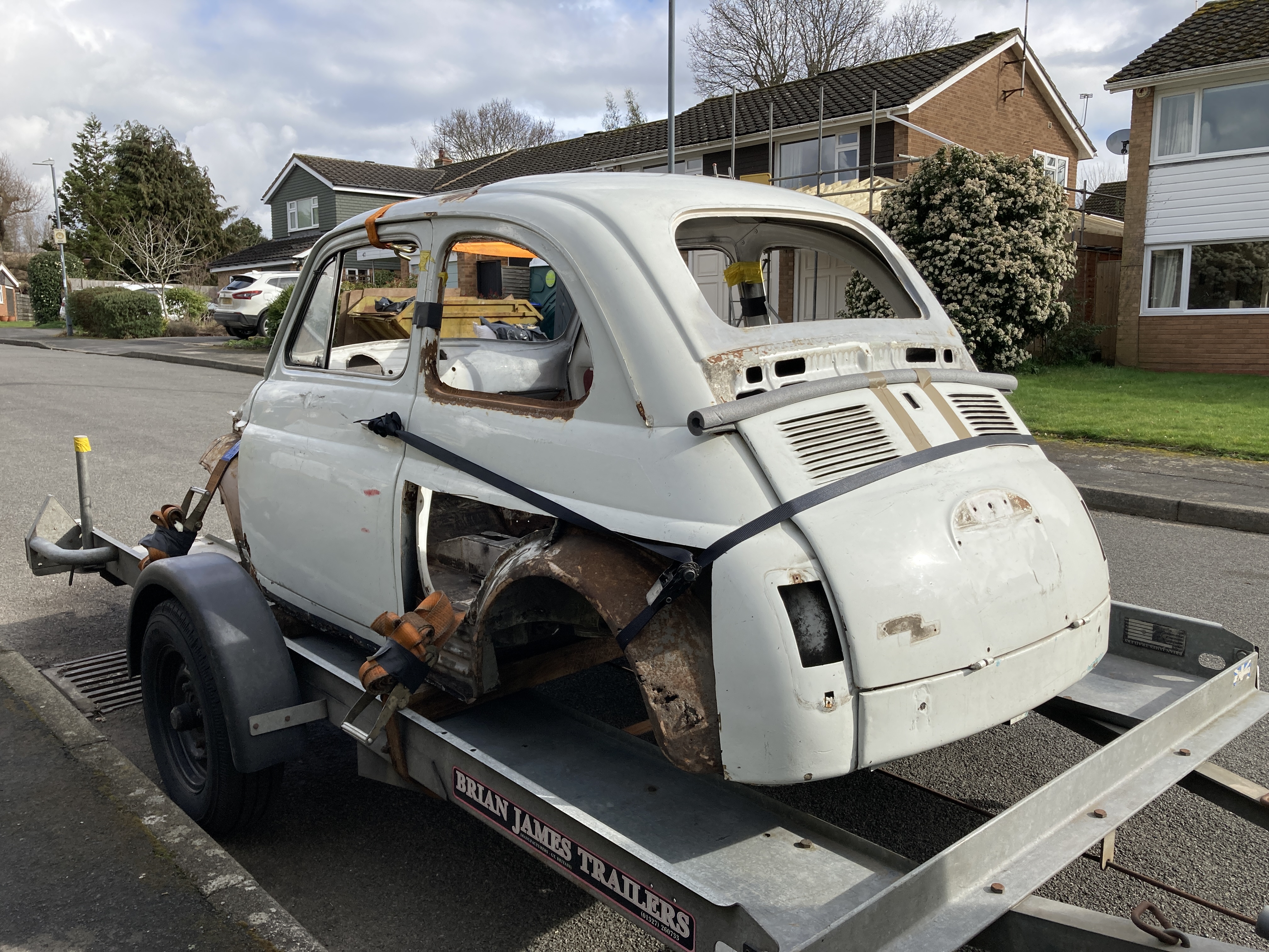

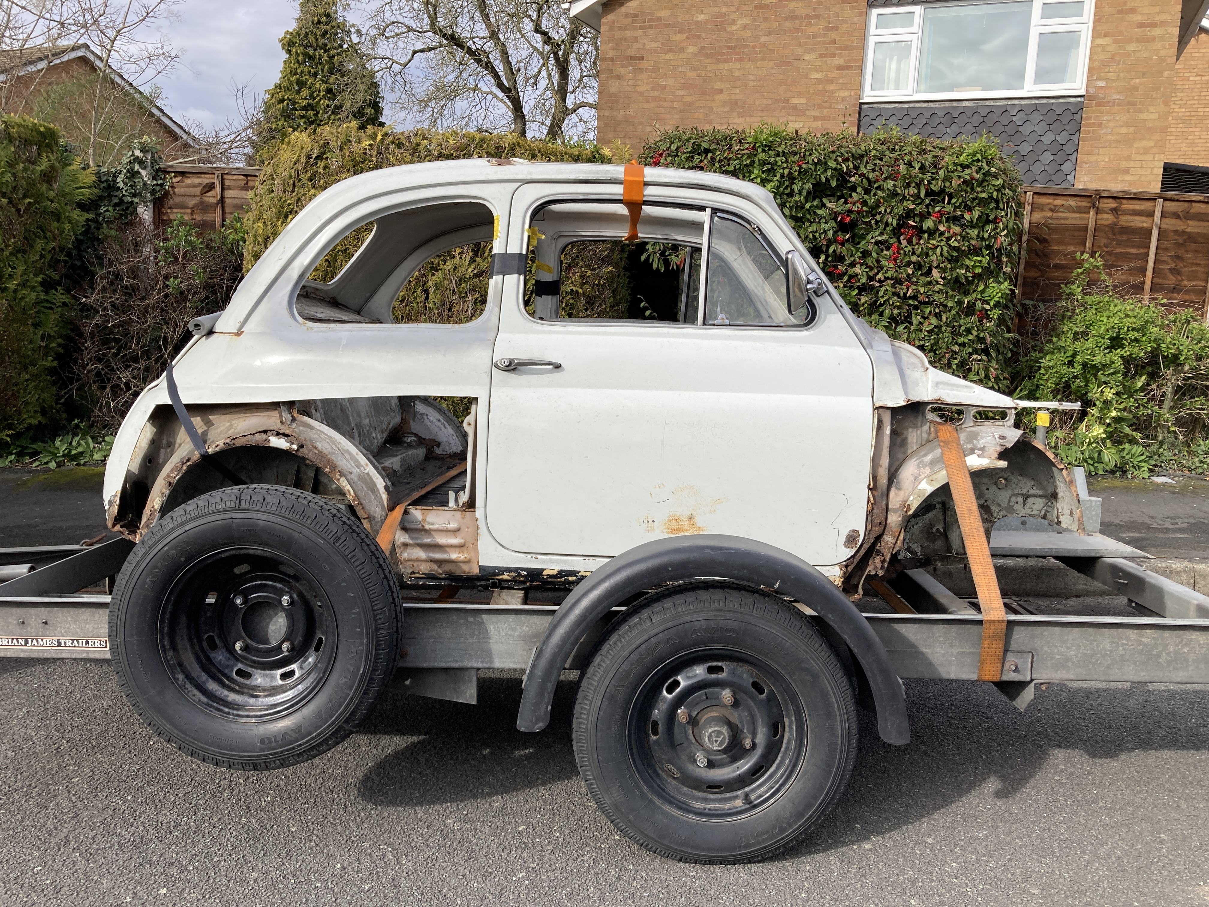

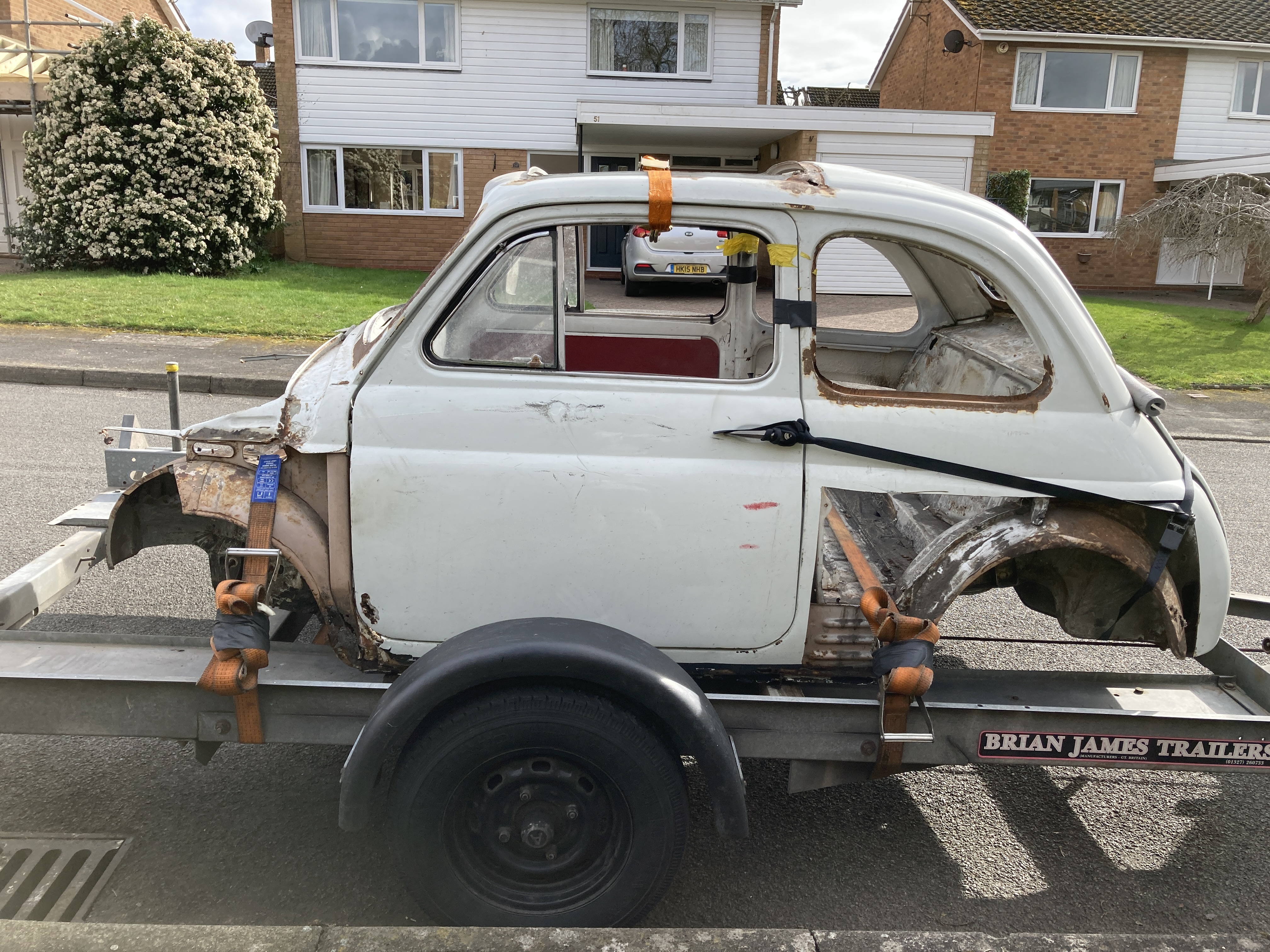

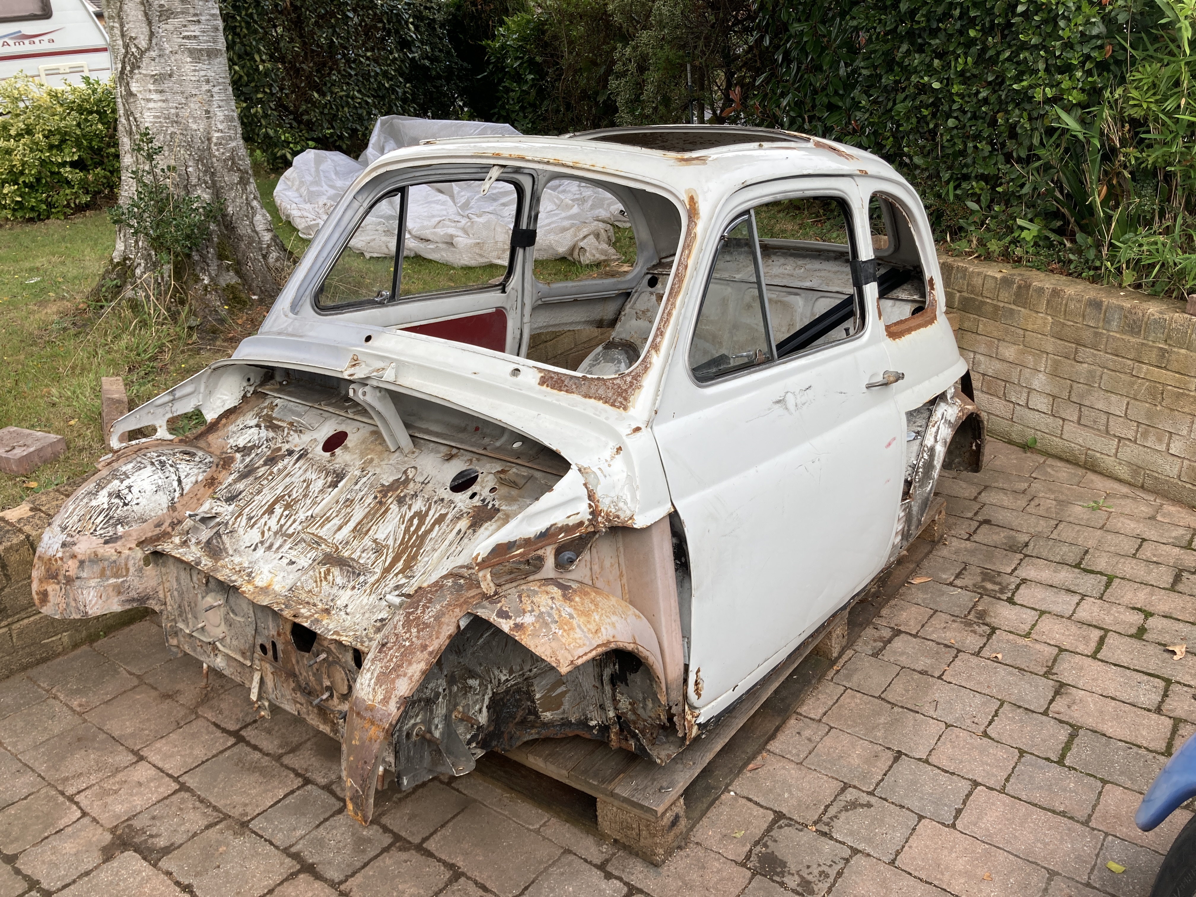

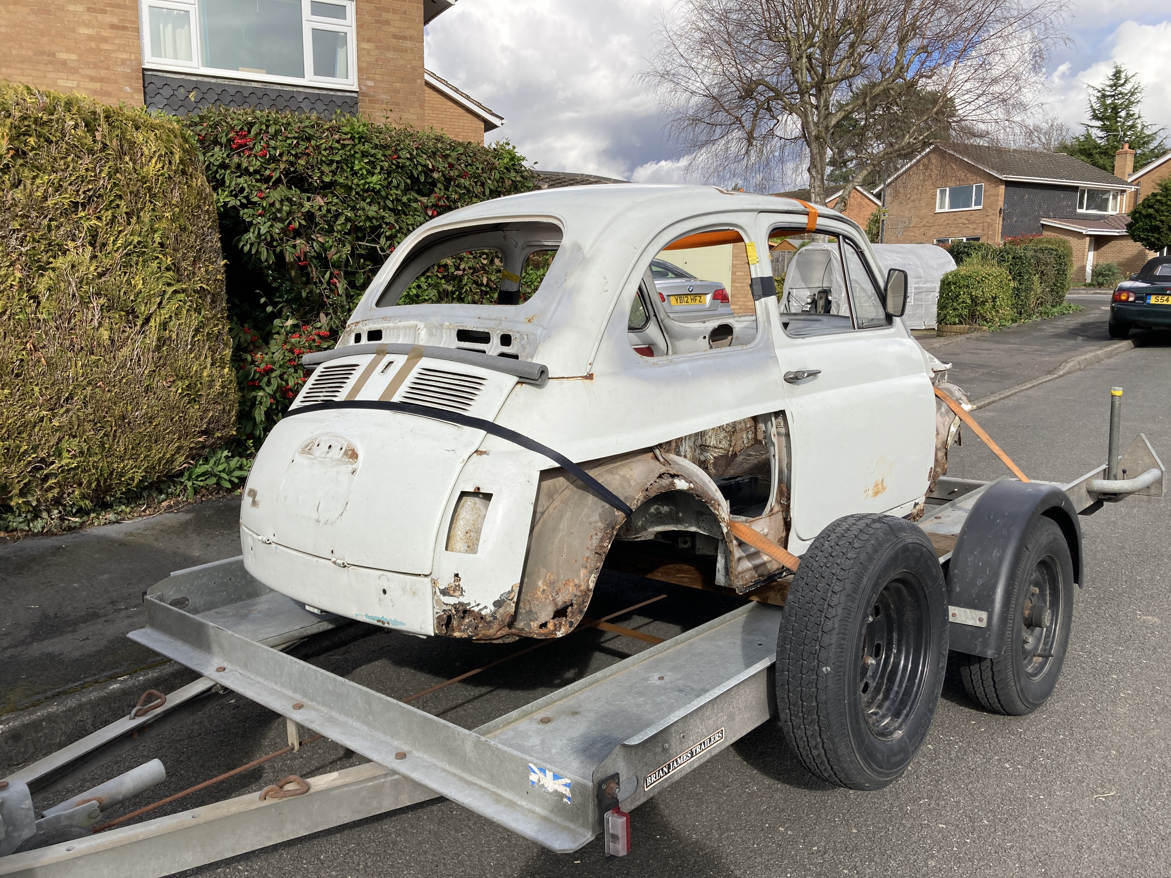

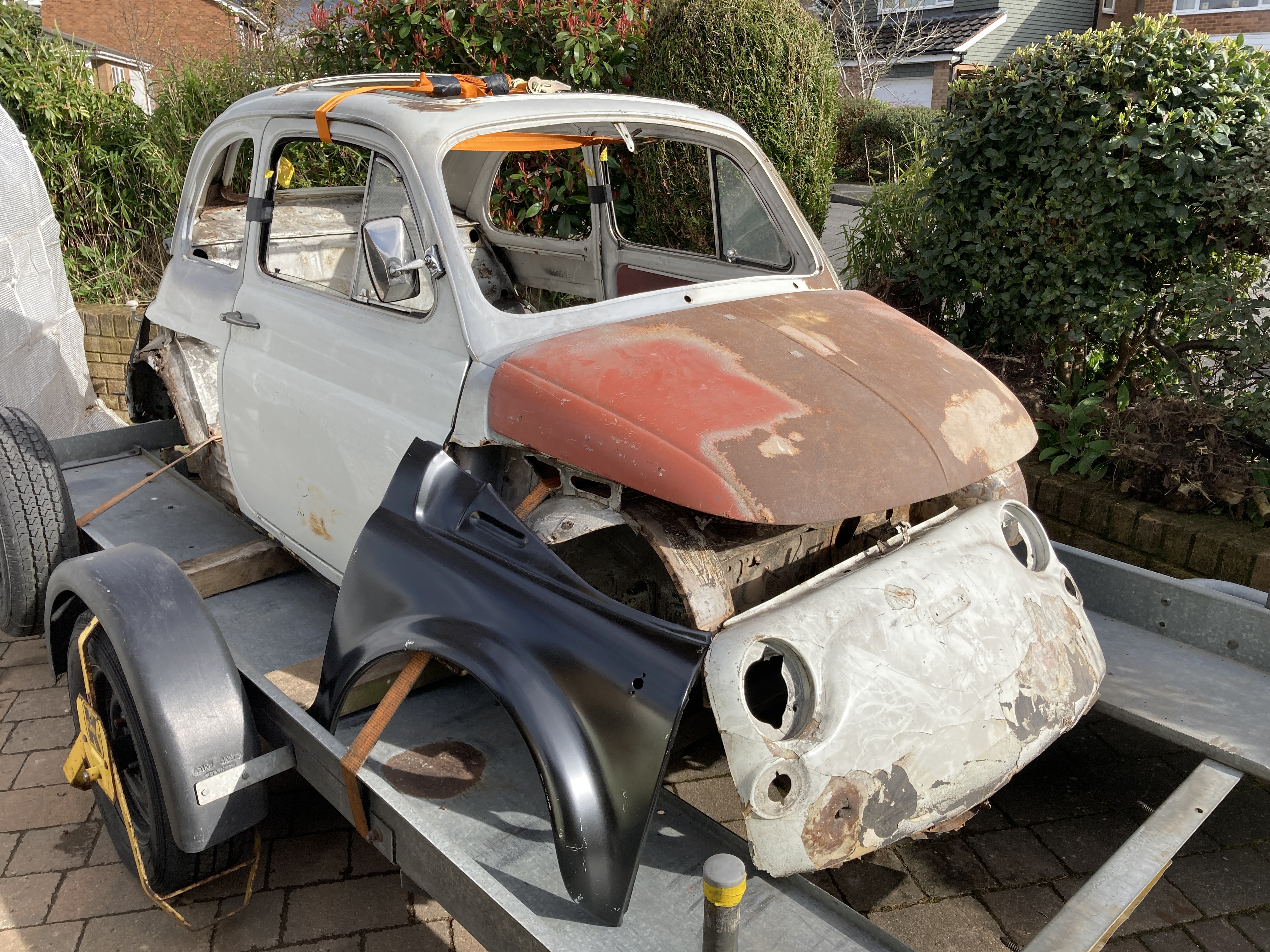

Here is the body and parts as I received them:-

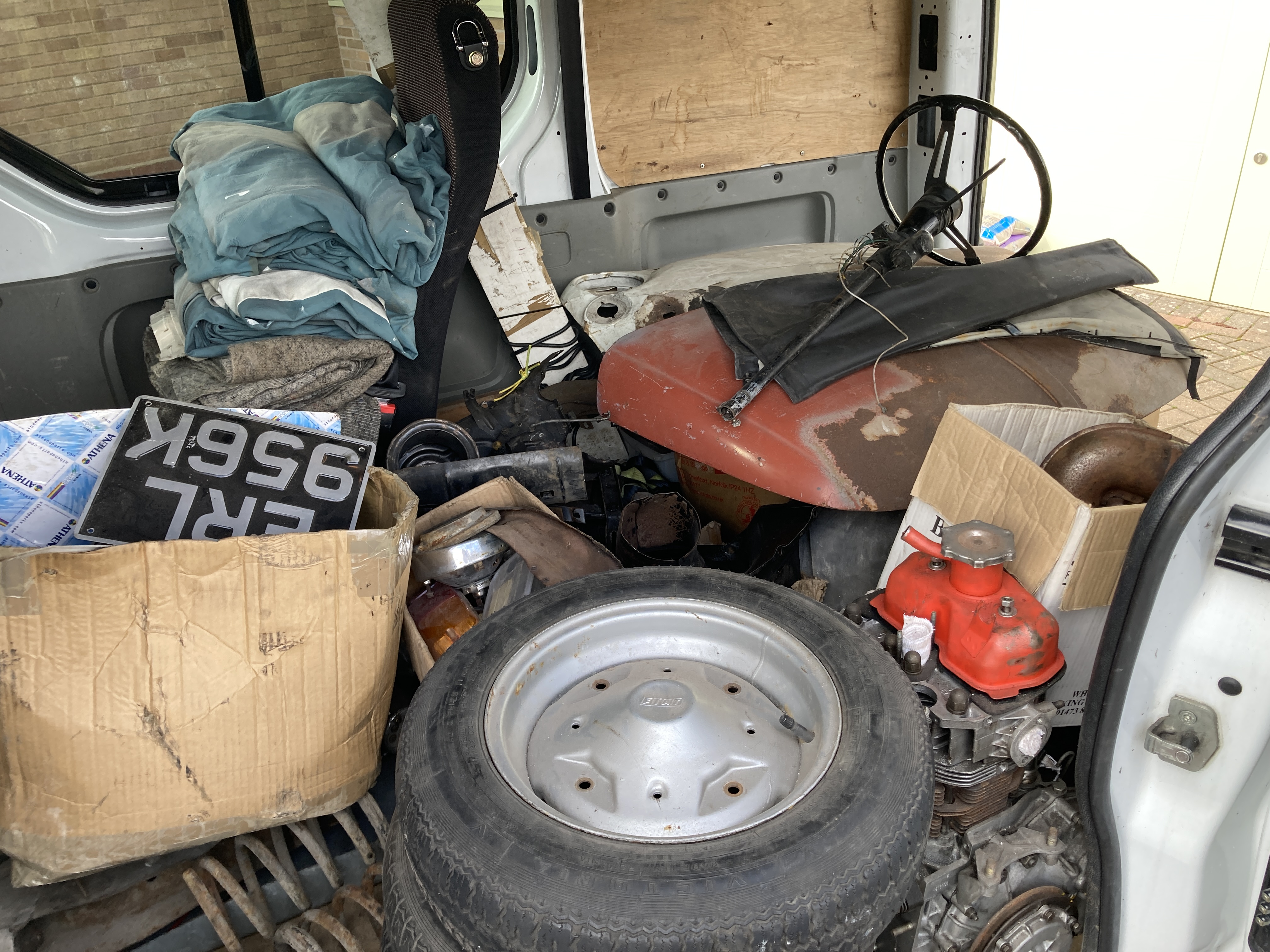

A few of the parts sat in the back of the van for a little while until I'd worked out where to store them. I noticed that the engine was rattling as I drove along so invesitigated - the head was loose and teh pushrods rattling about, so I thought it best to pull it apart and make sure all was ok. Lucky I did as a I found teh following handy note on a piece of paper INSIDE the oil pan!!

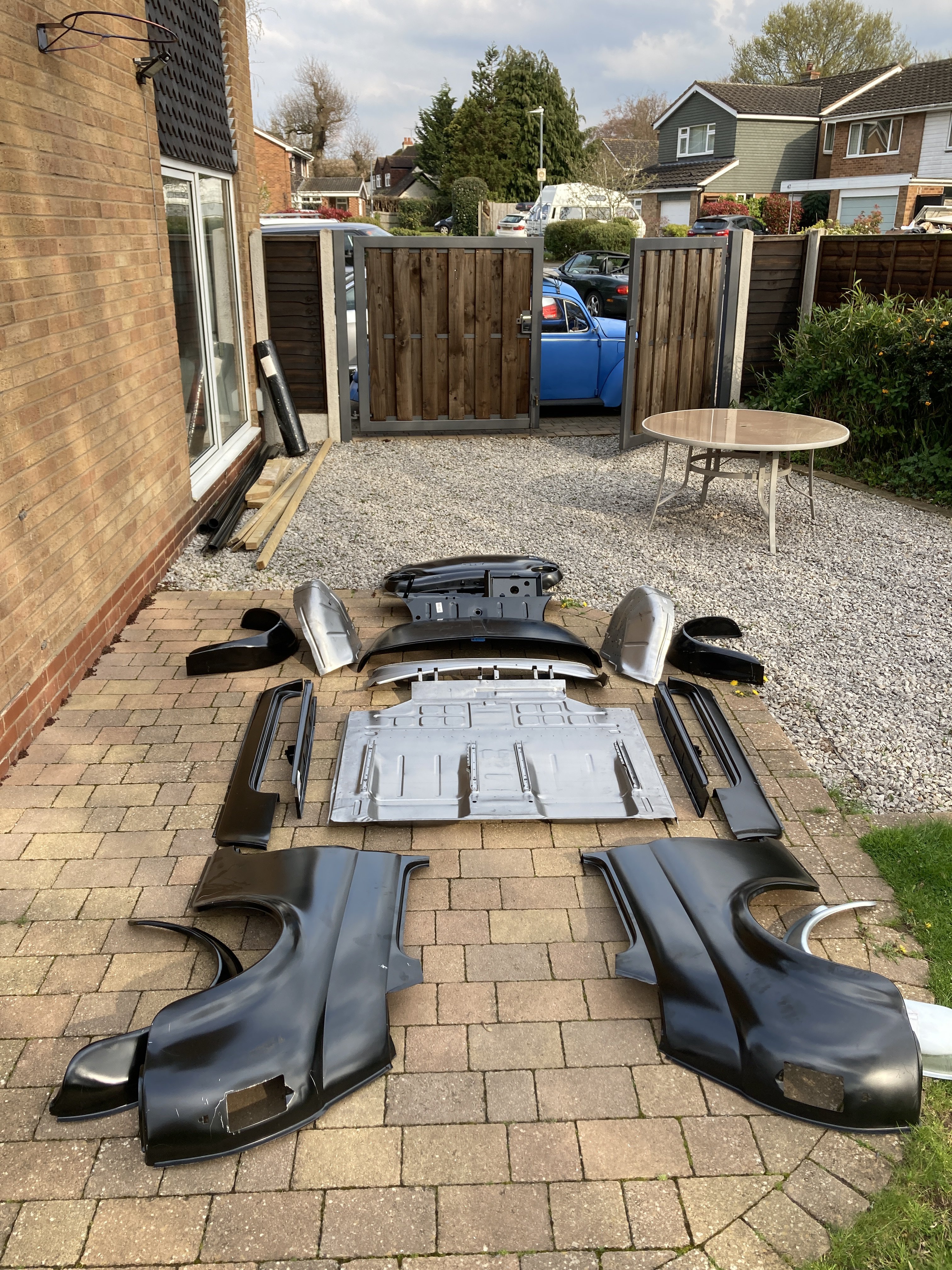

I then set to work on a shopping list of all the bits of what I might need to carry out a complete restoration of the car. All the work is to be carried out by myself, including the paint.
A trip to visit Franko at Ricambio in south London and I came back with whole load of mechanical items - bushes/brake system/load of rubber parts and many body panels. I knew this wouldn't be everything I needed but it should allow me to get going:-

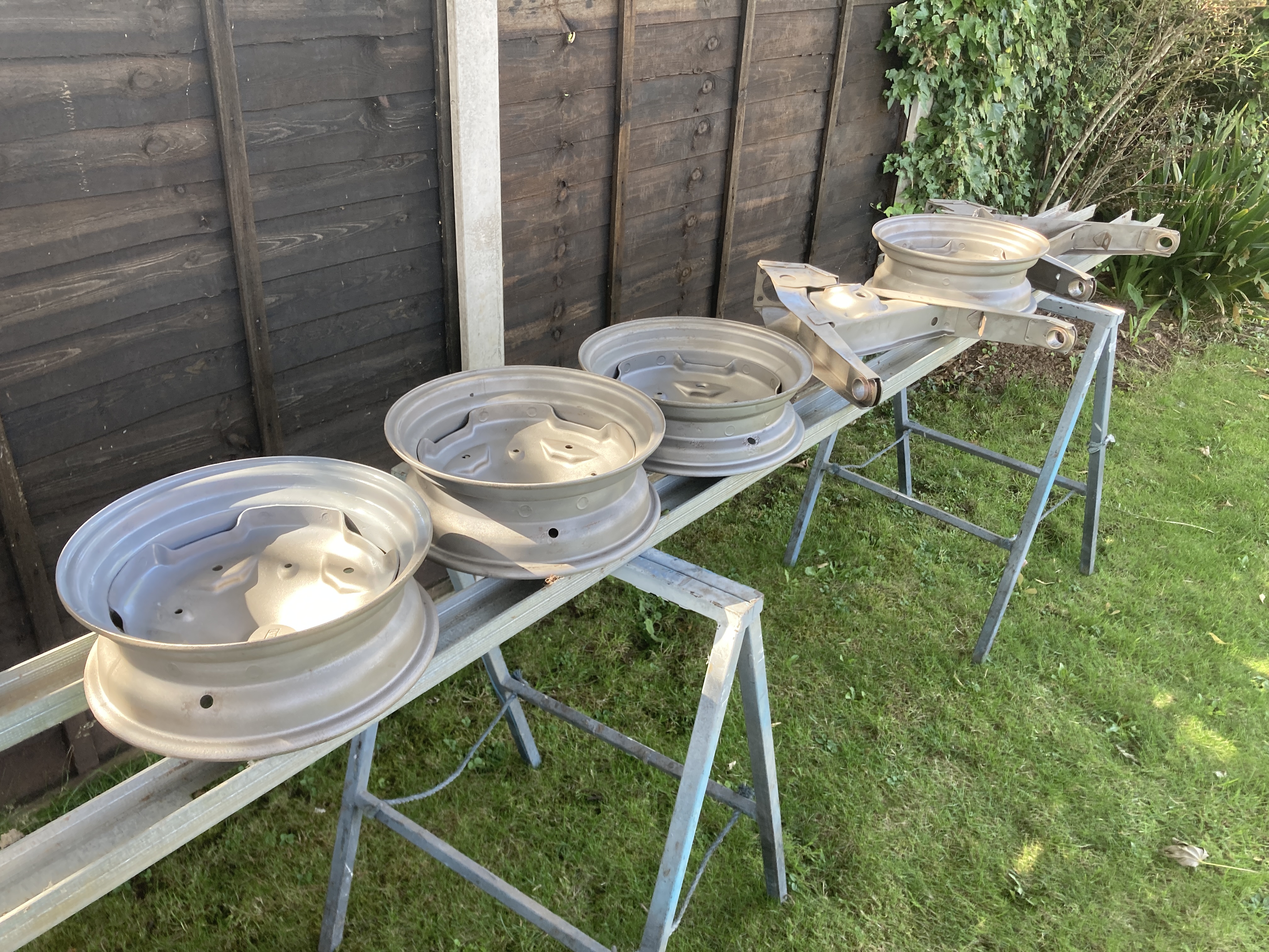

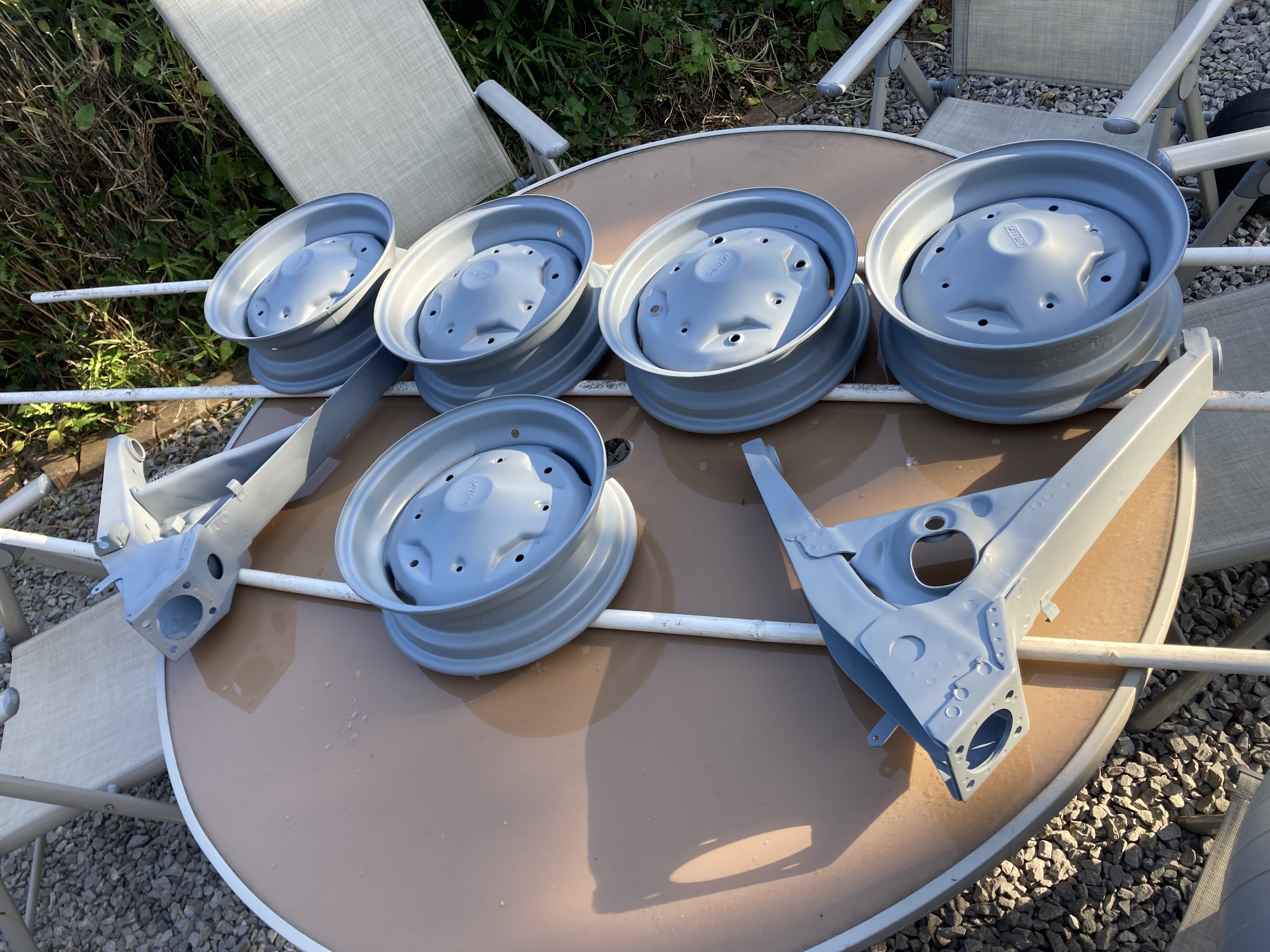

All the suspension, braking components and wheels have also been shot blasted, zinc primed and refinished in black, along with the engine tinwork and some of the internal metalwork. Lucky for me a friend of mine has a very large shotblasting cabinet I could use.
These are all now built up into sub-assemblies with new bushes, braking components etc and stored away for assembly back into the bodyshell when it's ready.

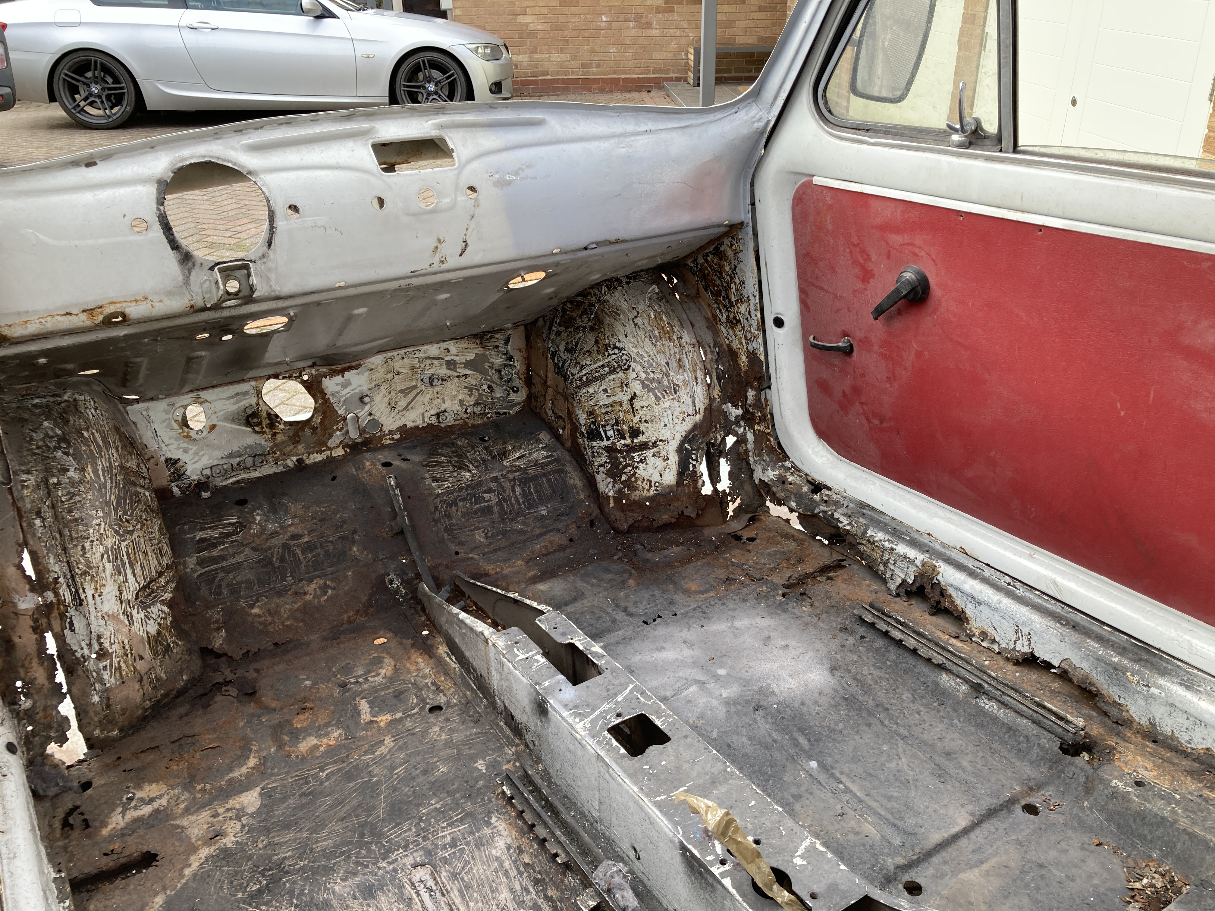

Unfortunately when I got the car i didn't have a complete ignition key, just a broken off handle part! Luckily for me my family have a house in Tuscany where I'm very lucky to visit most summers, so I took the broken key and the ignition barrel with me in the hope that I'd be able to find some blank keys to make the lock work. I found some so I bought 10 expecting that I probably wont get it right first time. In fact it turned out to not be that complicated... I took all the pins out of the barrel and then made a key and the pins fit each other - I now have 3 ignition keys for my car and 7 spare blanks (if anyone needs blank 500R ignition key for a steering lock type car then get in touch).

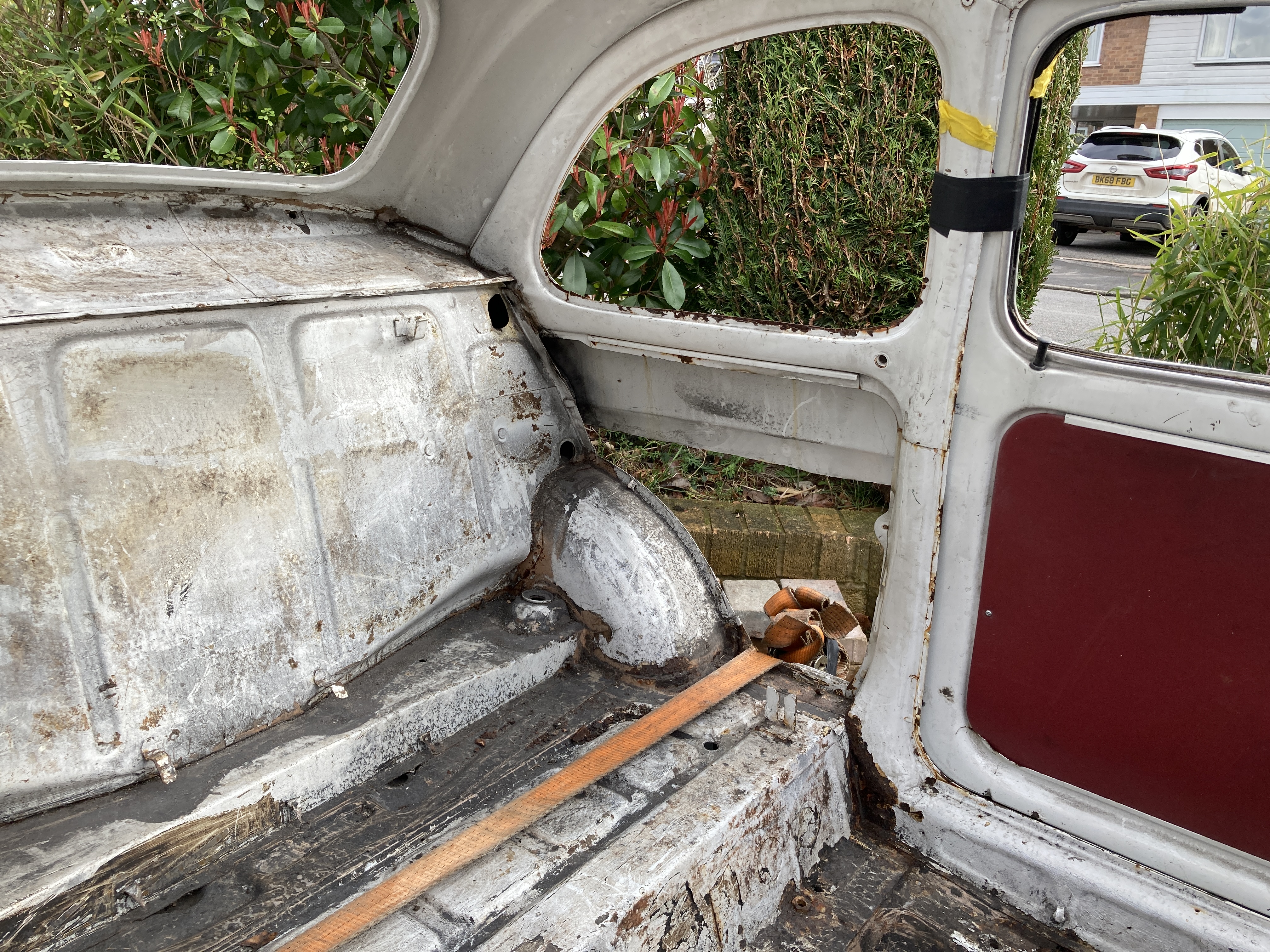

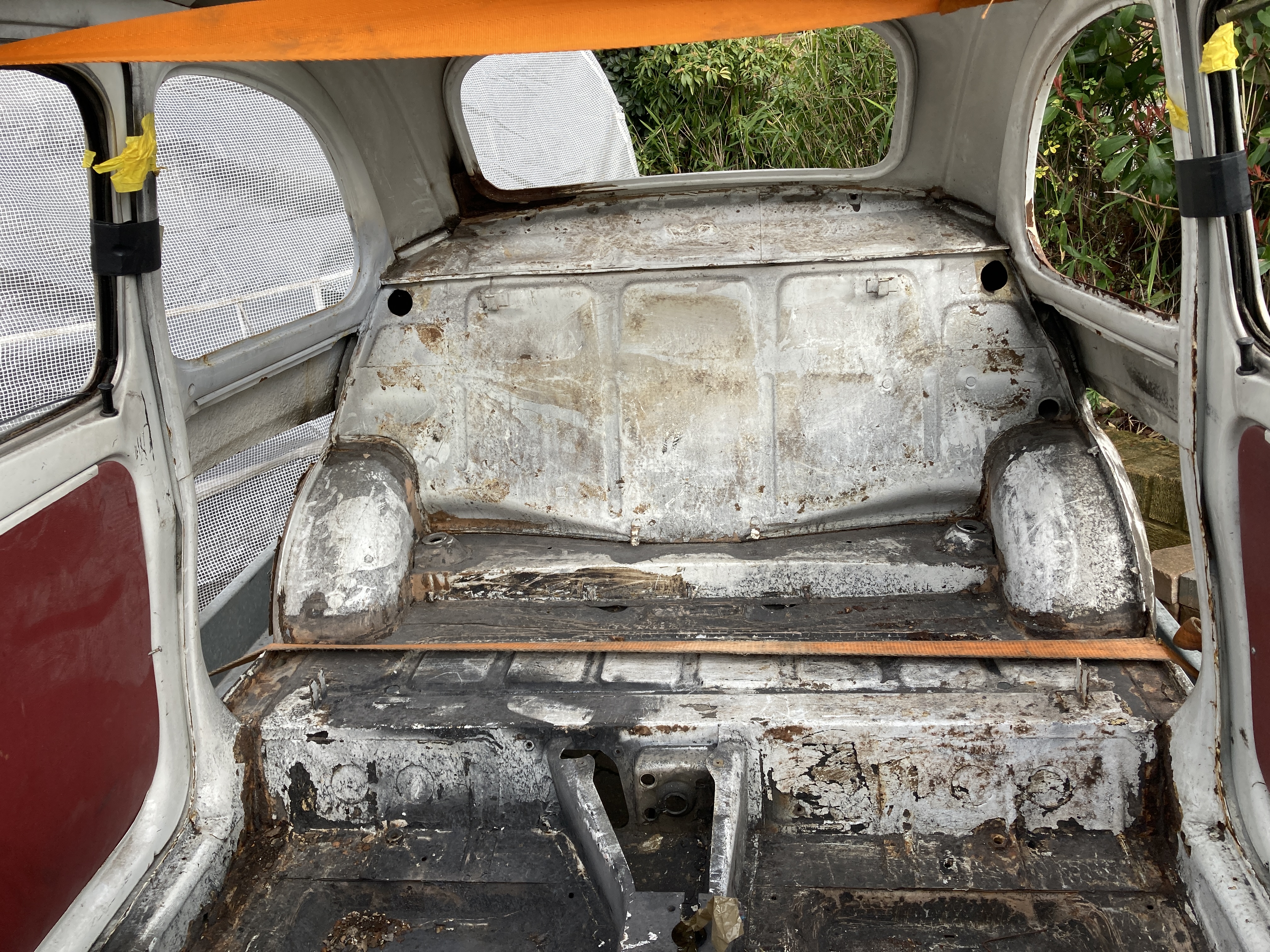

So now onto the body that's been waiting for me for 5months wrapped up outside:-

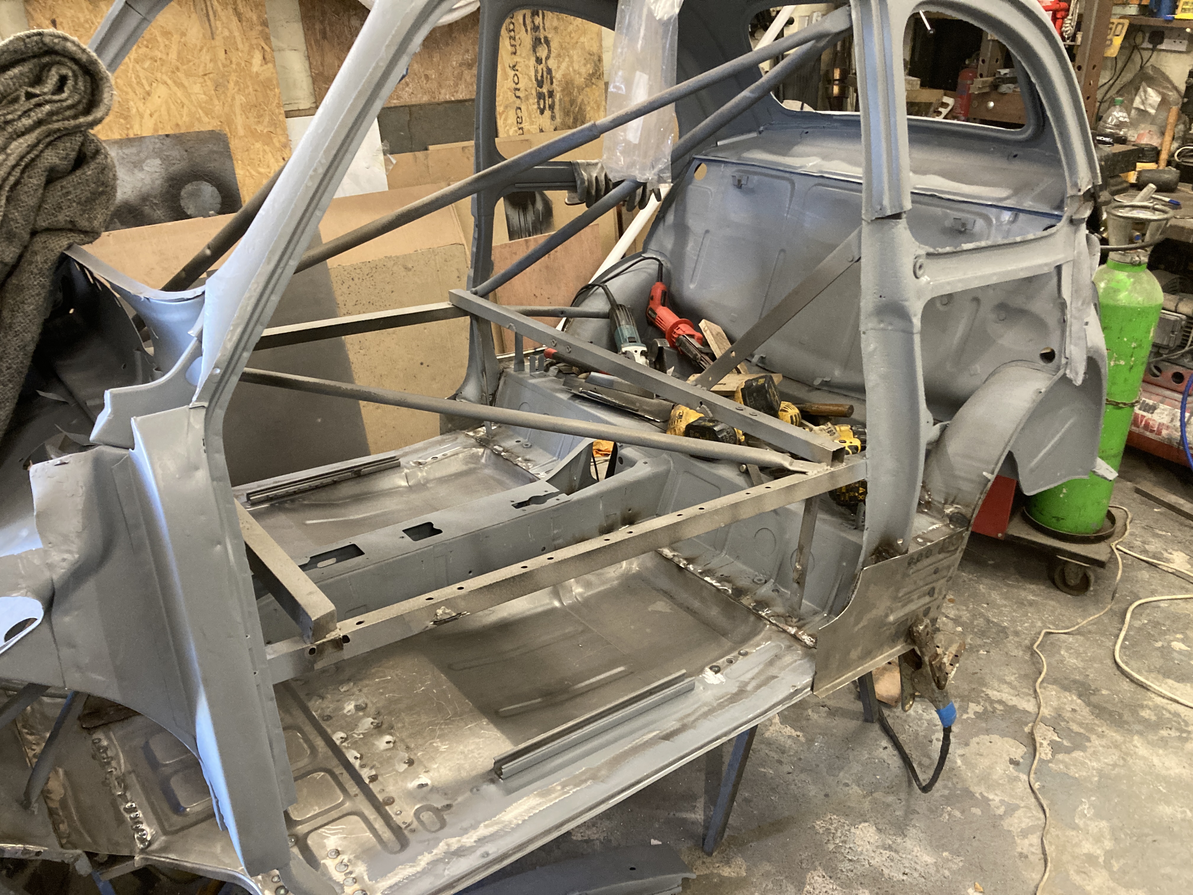

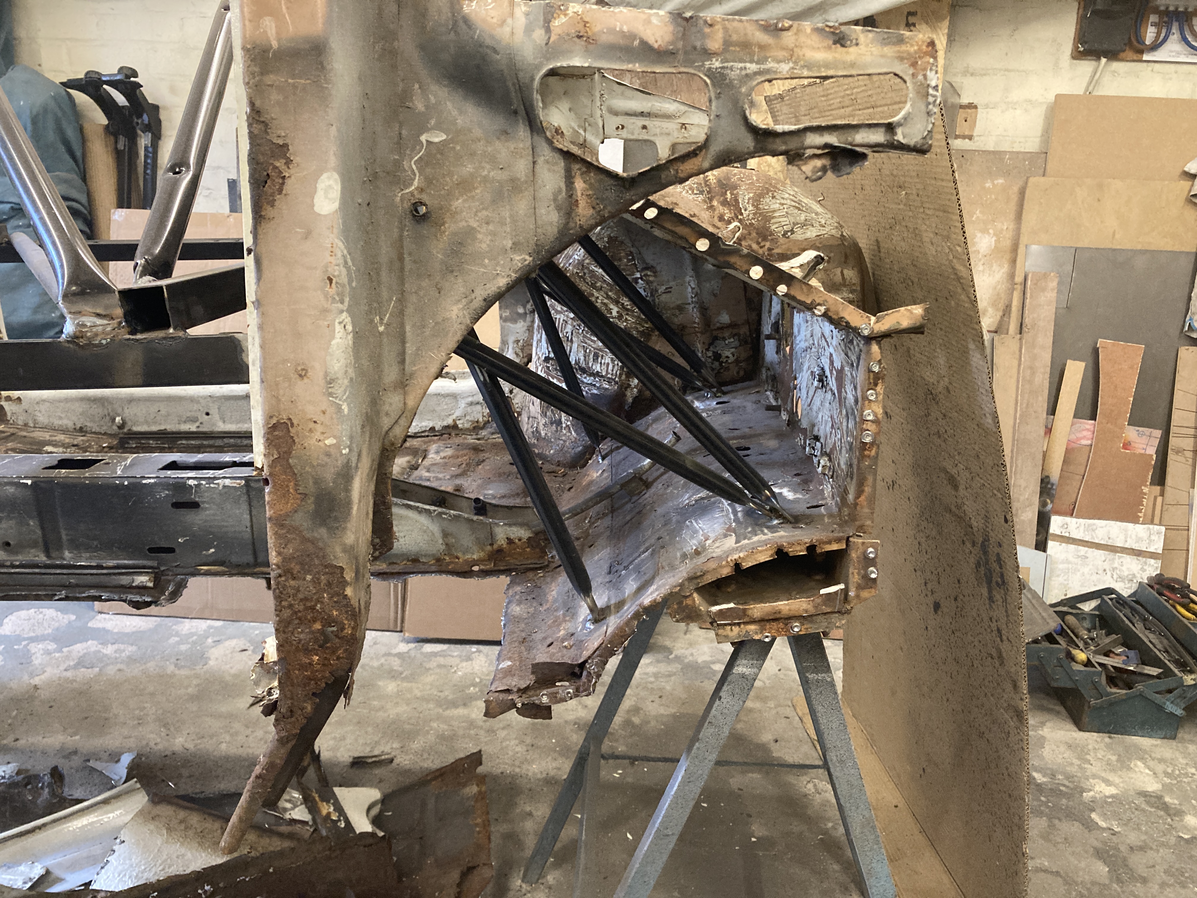

Myself and my son picked it up and moved it into the garage onto trestles so it's at working height. First thing was to weld a frame inside to keep whatever will be left of it the correct shape for when it goes back together The intention is to cut as much of teh rot out before having the remains shotblasted. This will provide a good, clean starting point for the reconstruction. I already know I need s few more bits dash panel being one of them as it's rotted away and had a poor repair to the right hand end (historically or by one of the previous two owners).

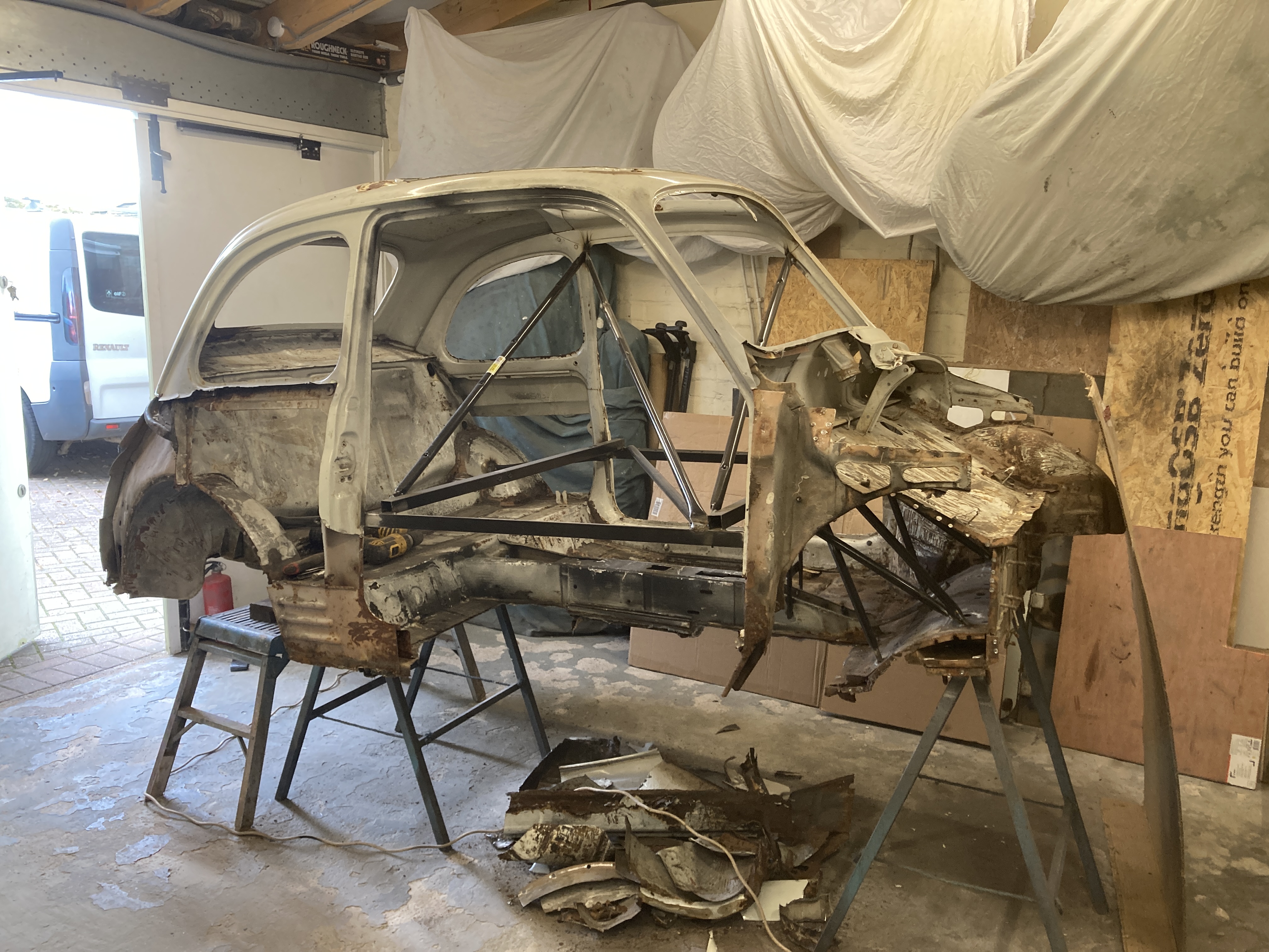

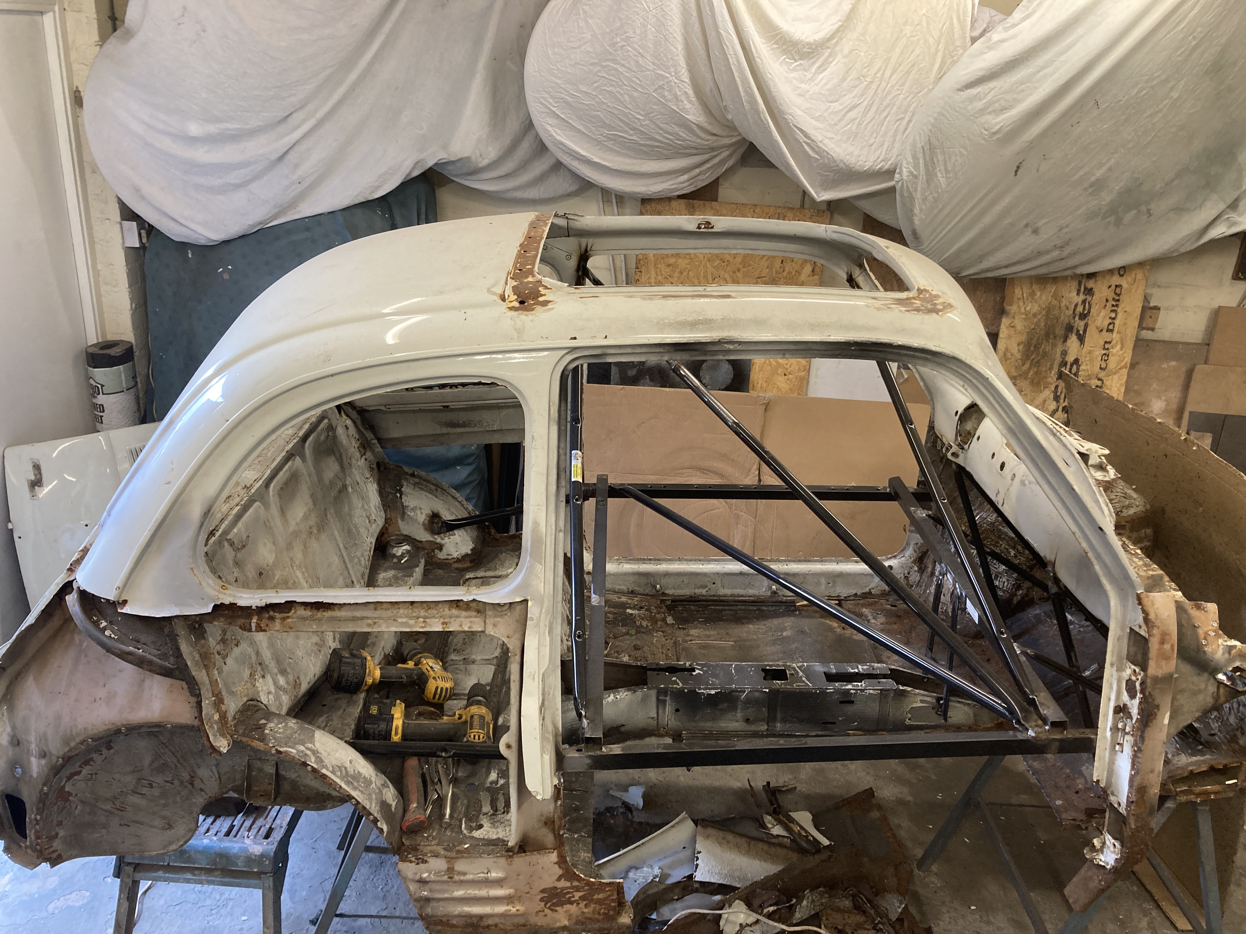

And then I got to work getting it ready for shotblasting. This is work in progress, but most of the RHS is shown to be now removed in these pictures below. I've taken a whole load of measurements from known datums to ensure correct reassembly.
Another week or so and I should have the body ready for shotblasting. It's a little car and I've made it littler, so it should now fit in the back of my Renault Trafic for the journey!

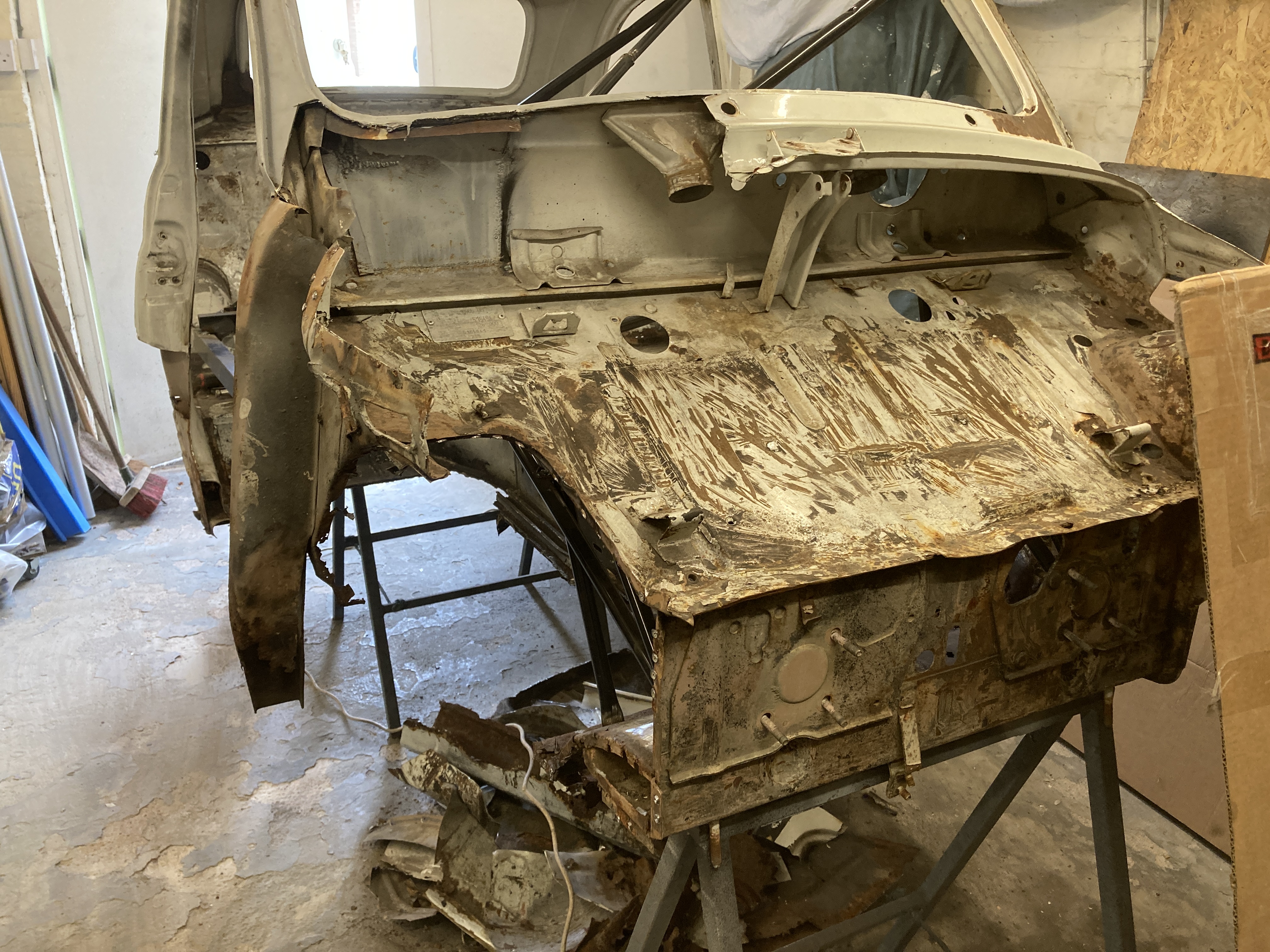

So I've finally managed to the the bodyshell (almost) ready to head off to the shotblaster. There's just a small piece of floor panel to remove where it overlaps the bulkhead on LHF - another hour's work or so.
On stripping the roof I've noticed that unfortunately there quite a lot of (accident?) damage to the roof panel on the LHS above the gutter. Not a lot I can do to pull it out, so it'll just have to filled again like it was before...

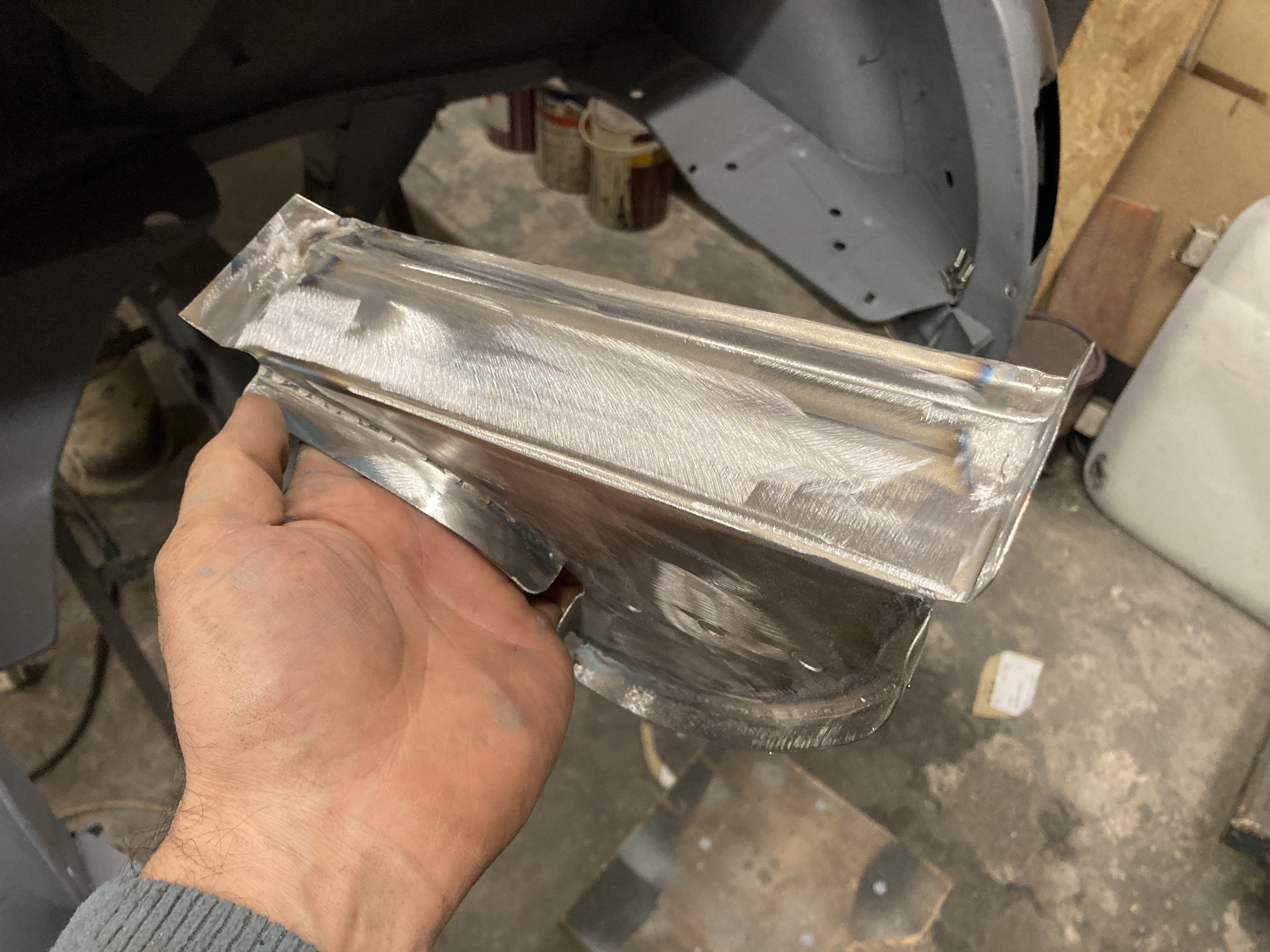

Whilst waiting to get the shell off to eb blasted I've been making a few panels that I haven't bought, or it is not possible to buy.
Rear Inner Cill Panels.
I know it's possible to buy these, but I fancied having a go at making some....there's a bit of trimming to be done as they are installed.
Lower inner B-post panels
It's not possible to buy these. If anybody wants some let me know and I'll make some more. Again, some trimming required as they are installed.

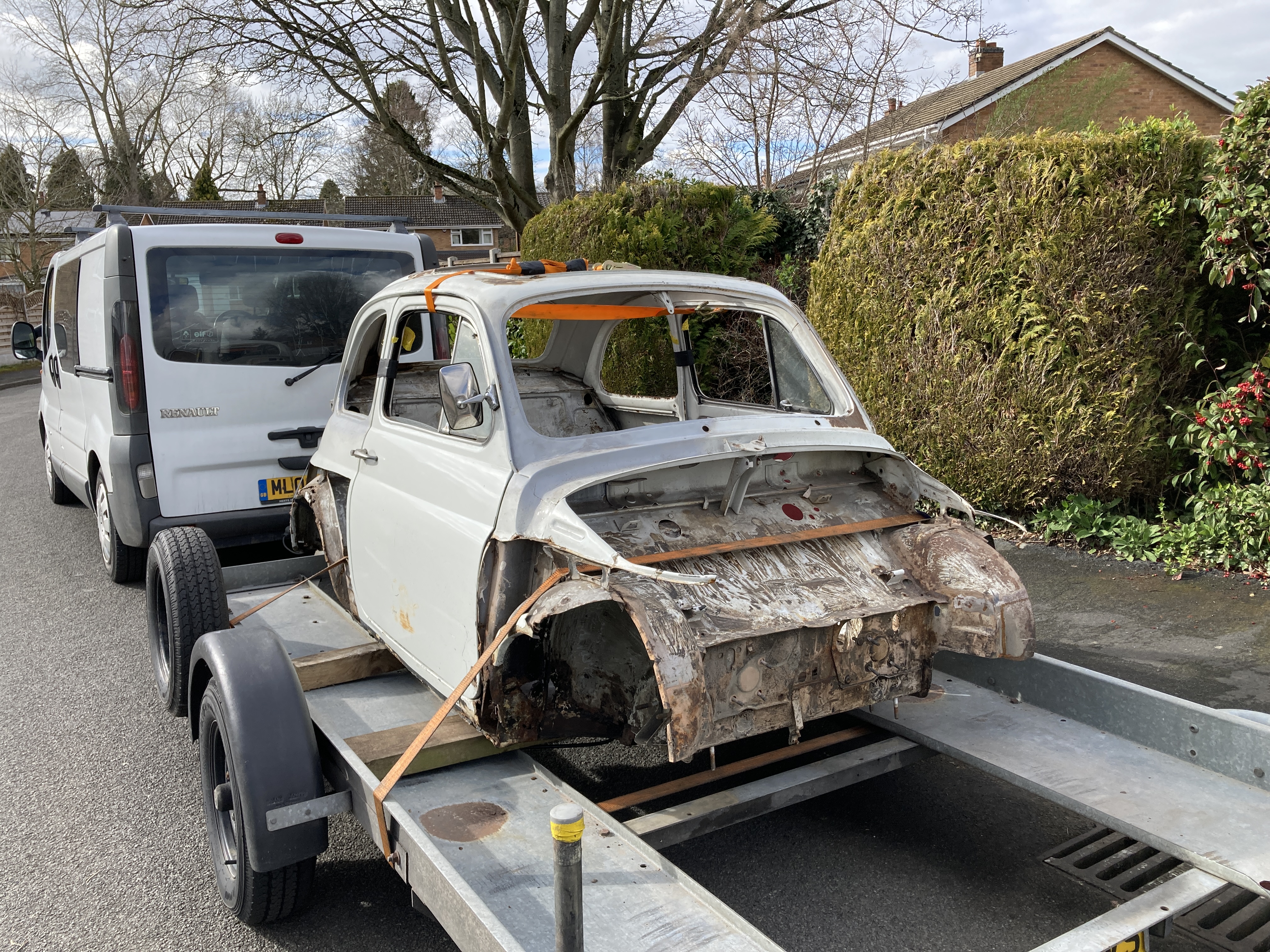

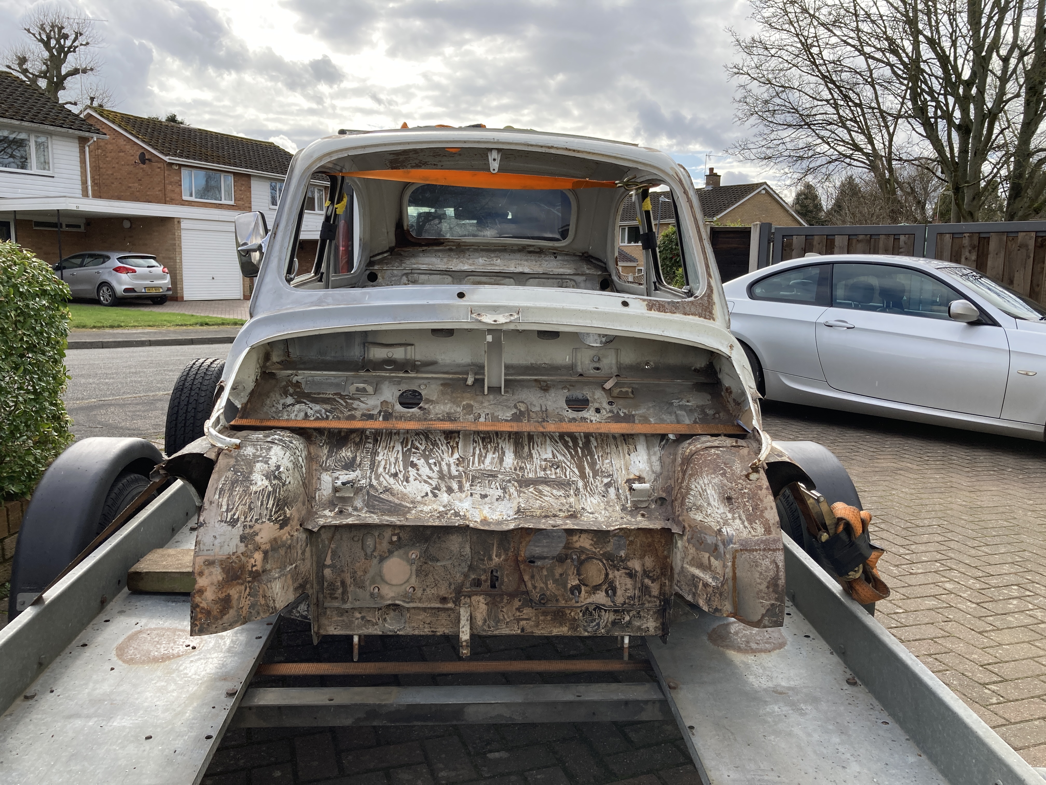

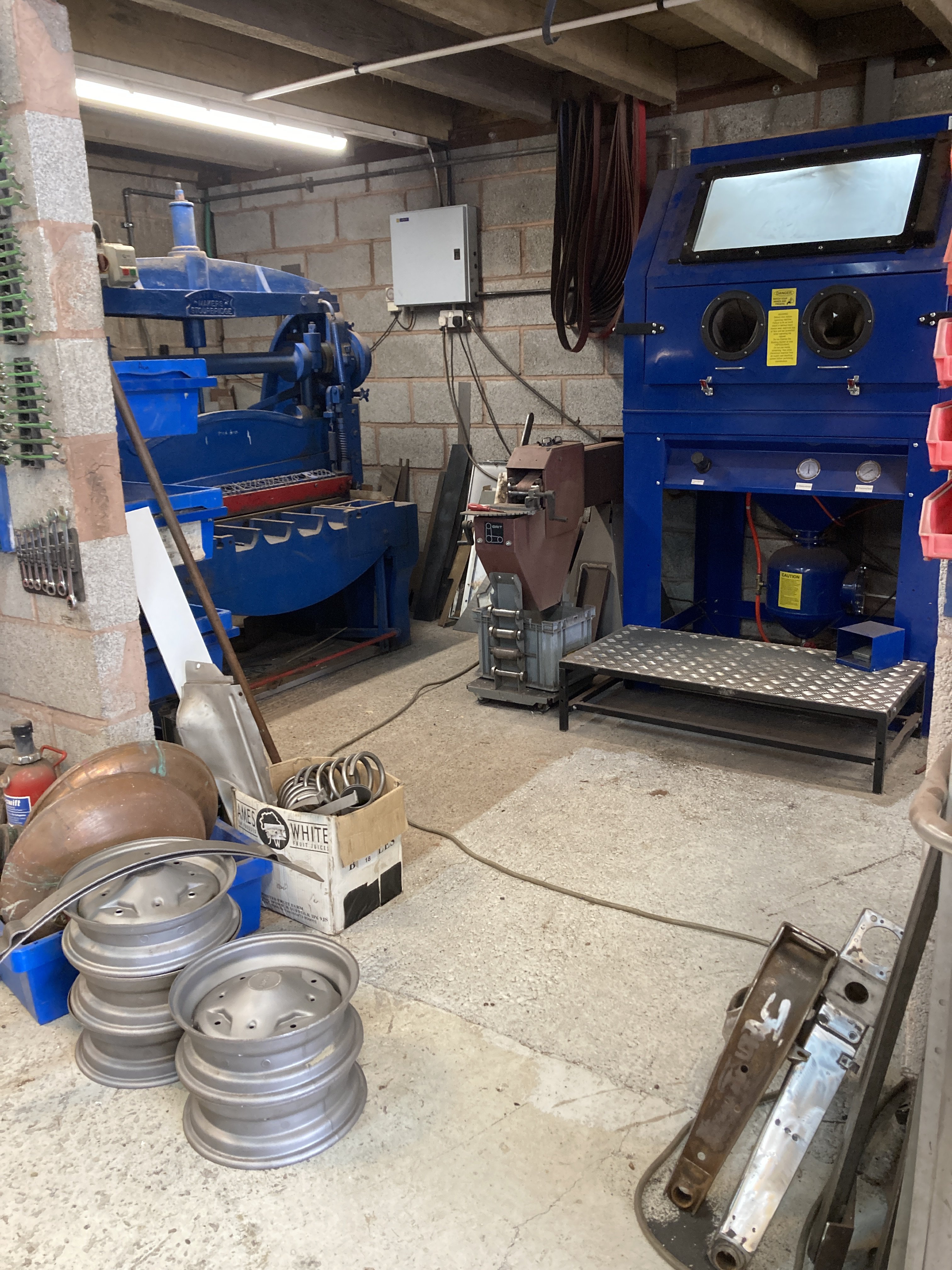

I managed to agree a day with the shotblaster to pop over with the bodyshell and wait while it was blasted so that I can take it back immediately get some zinc primer on it. I used Lankies Refurb in Redditch, UK. Mark is a great guy and easy to deal with, I'd absolutely recommend him if anyone needs some shotblasting/powder coating carried out.
To get the bodyshell there I squeezed it inside my SWB Renault Trafic - it was a tight squeeze indeed and I had to remove the front passenger seats to fit it in...

Despite the "squeeze", that car still looks so tiny inside your van.
It's scary level of dismantlement, but you seem to have the shell well-braced. Does it still have a bit of floppiness?

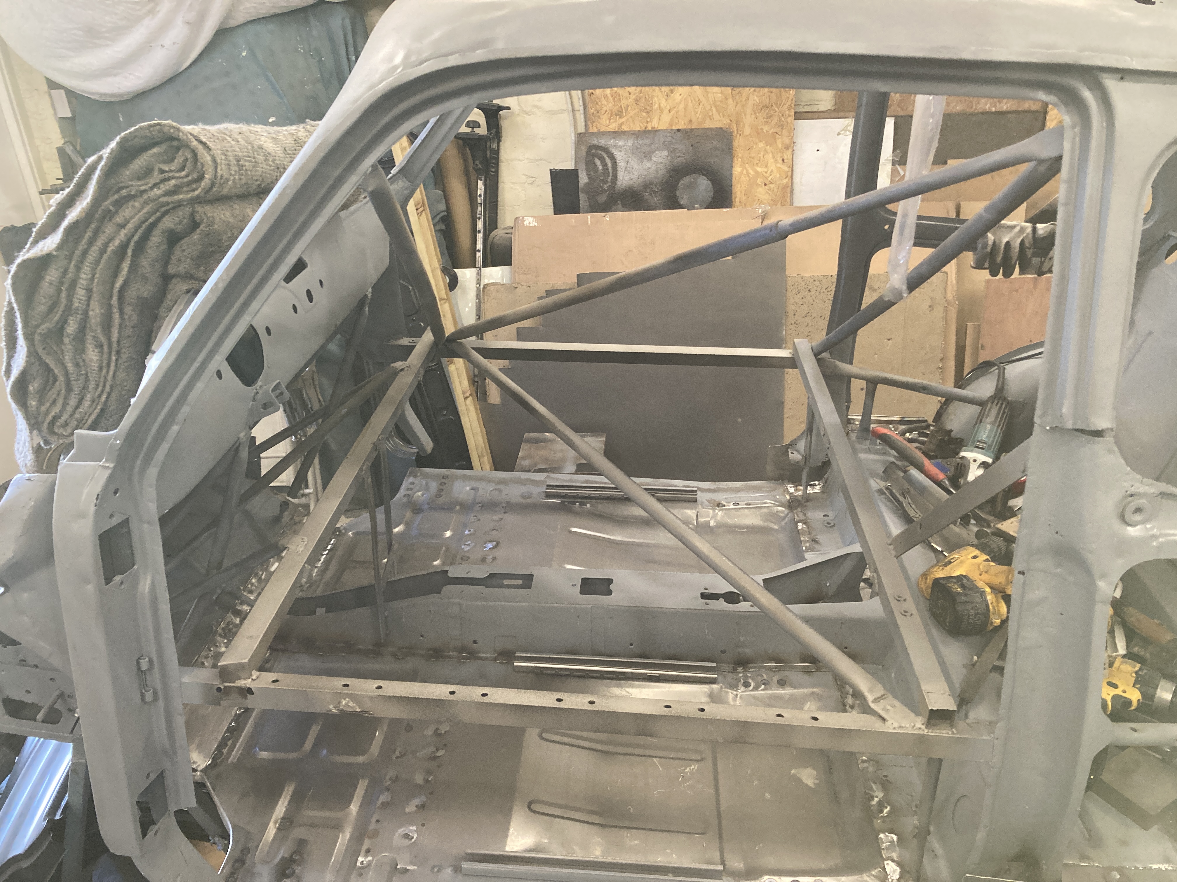

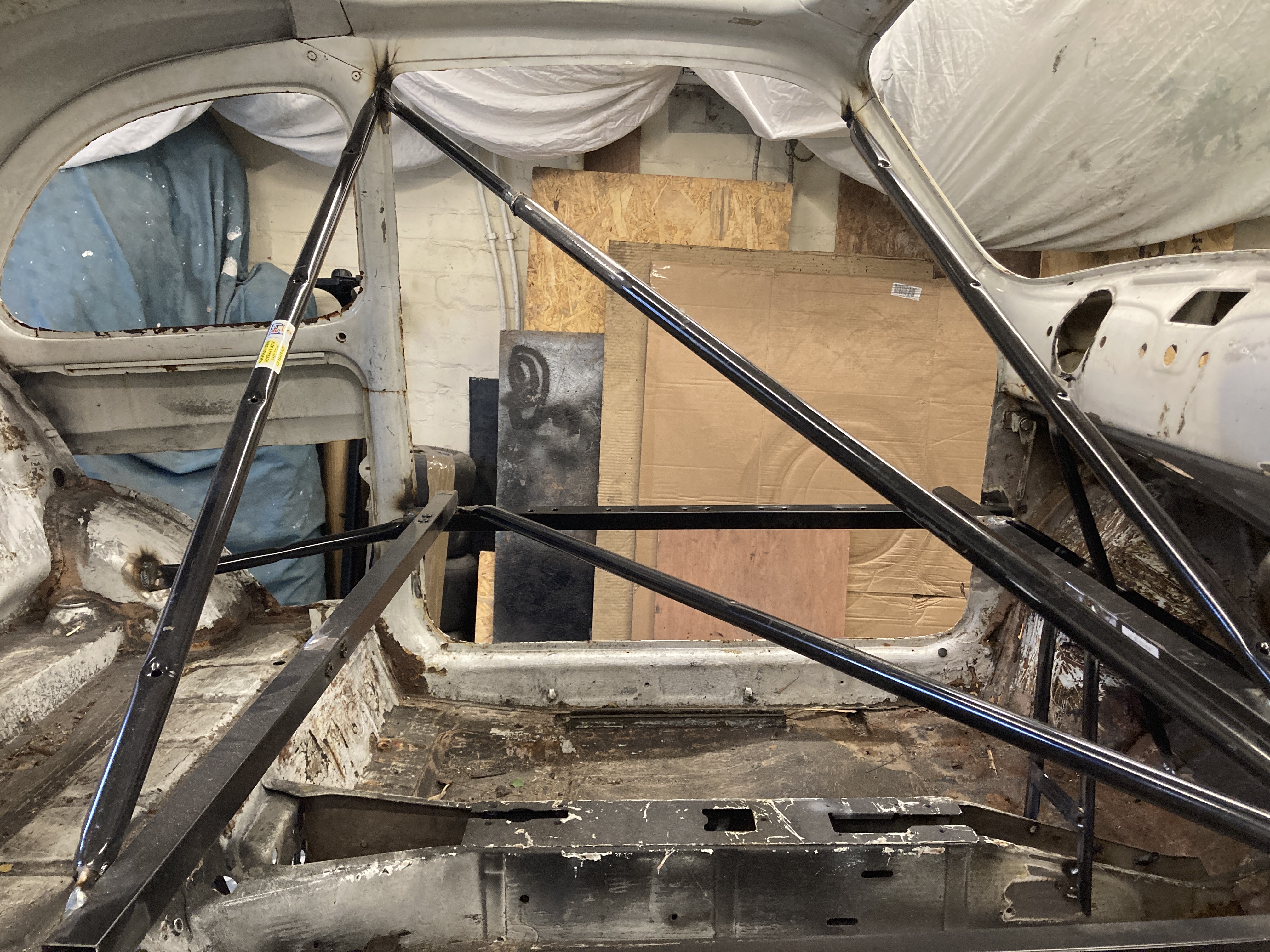

The frame i've welded inside the shell to keep everything in place definitely does not allow anything to move - it was welded in place before anything was cut away. I added some extra bracing in a couple of places whilst it was being blasted to reduce the risk of any potential distortion caused by the blasting moving any important datum points (I was mostly concerned about the positioning of the A-post structural panel that the door hinges attach to, as the door fit is crucial to getting the floor and cills back in the correct position). These additional parts have now been removed as they interfere with cill/floor/A&B post installation.
Regarding the suspension mounting points - the front leaf spring mount is unaffected by what I've done and the front upper wishbone mounting points are also still attached to the front crossmember to define their Z position (i.e. up/down) and X position (i.e. front/rear); and their Y position is defined by the end of the front crossmember once the front inner clamshells are reinstalled, so there's very little risk of developing any errors in these mounting points. The rear suspension mounting points are not at all affected by what I've removed.
That sounds really thorough (as it looks). The issue that worries me if I ever get round to my second car is that enough critical parts have lost their rigidity to the point where I worry that there has been rotation of the body around its cental axis in both planes; the car wasn't even rigid to start with!
This gives a idea of its level of integrity:
Although I did put a floor in before having to pause the project through over-committing on other things; you can see my sophisticated bracing method in the footwell. ;)

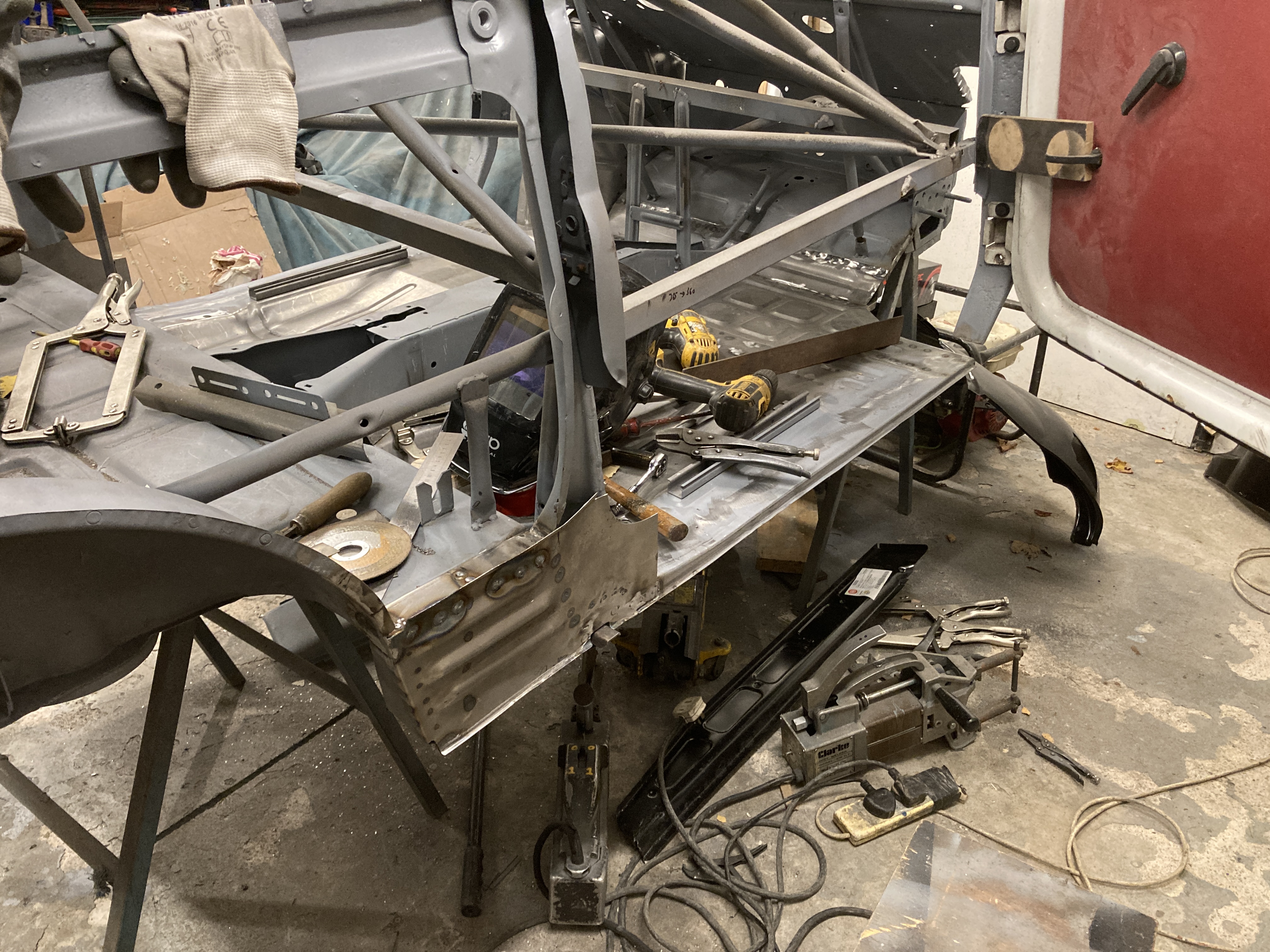

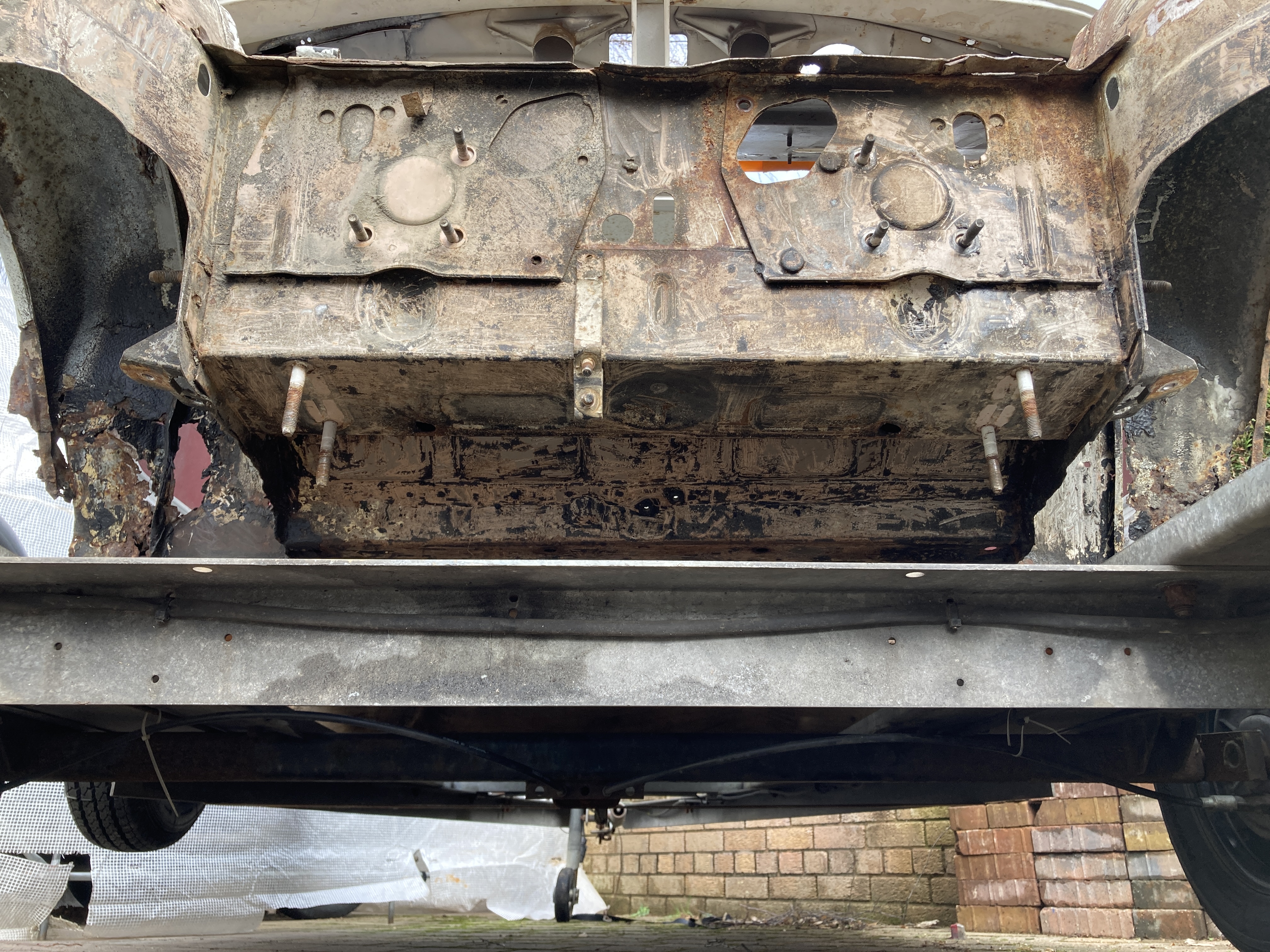

Time to work on the shell has been a bit sporadic recently, but the floor panel has now been installed along with the rear inner cill panels:-

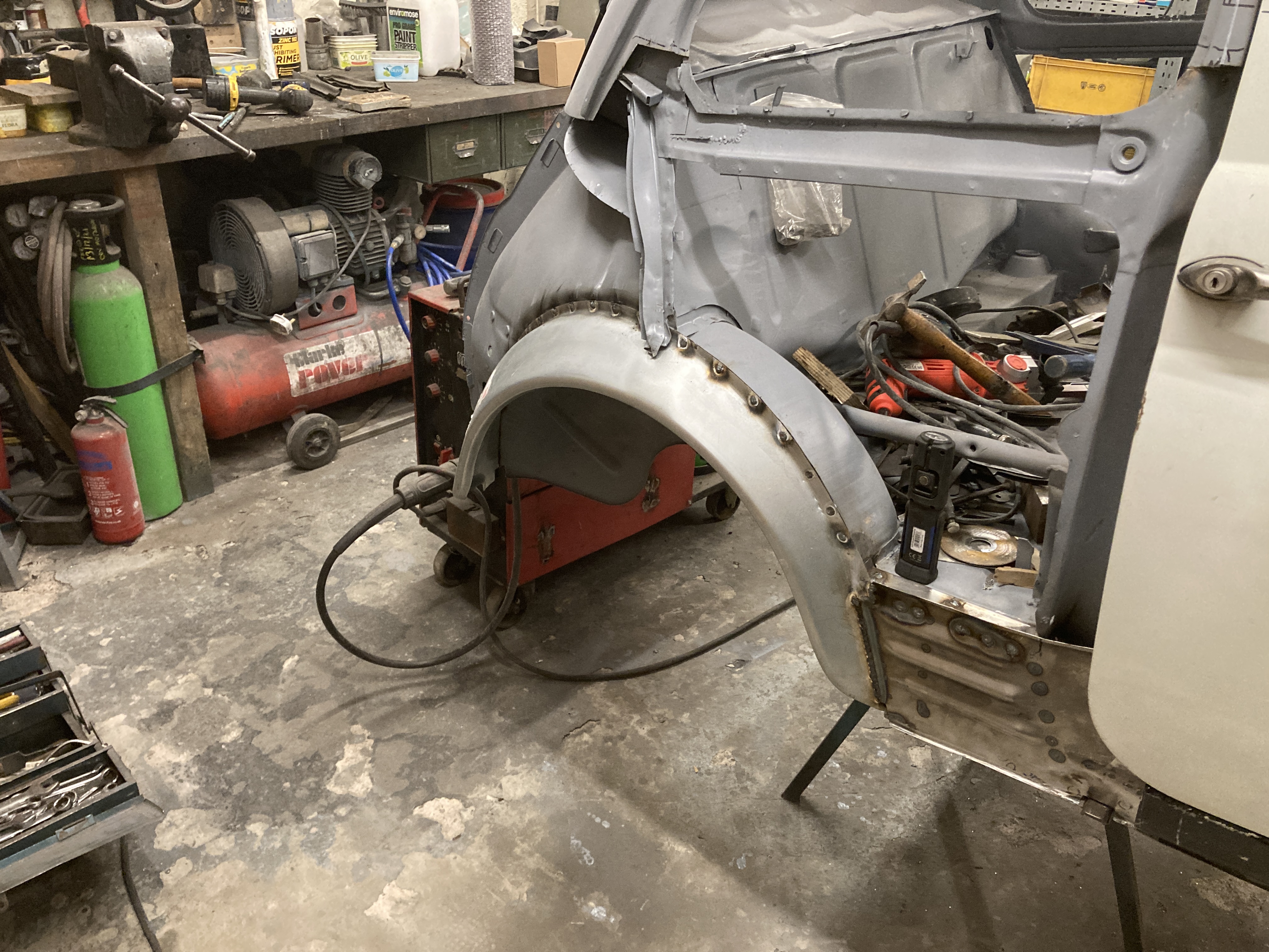

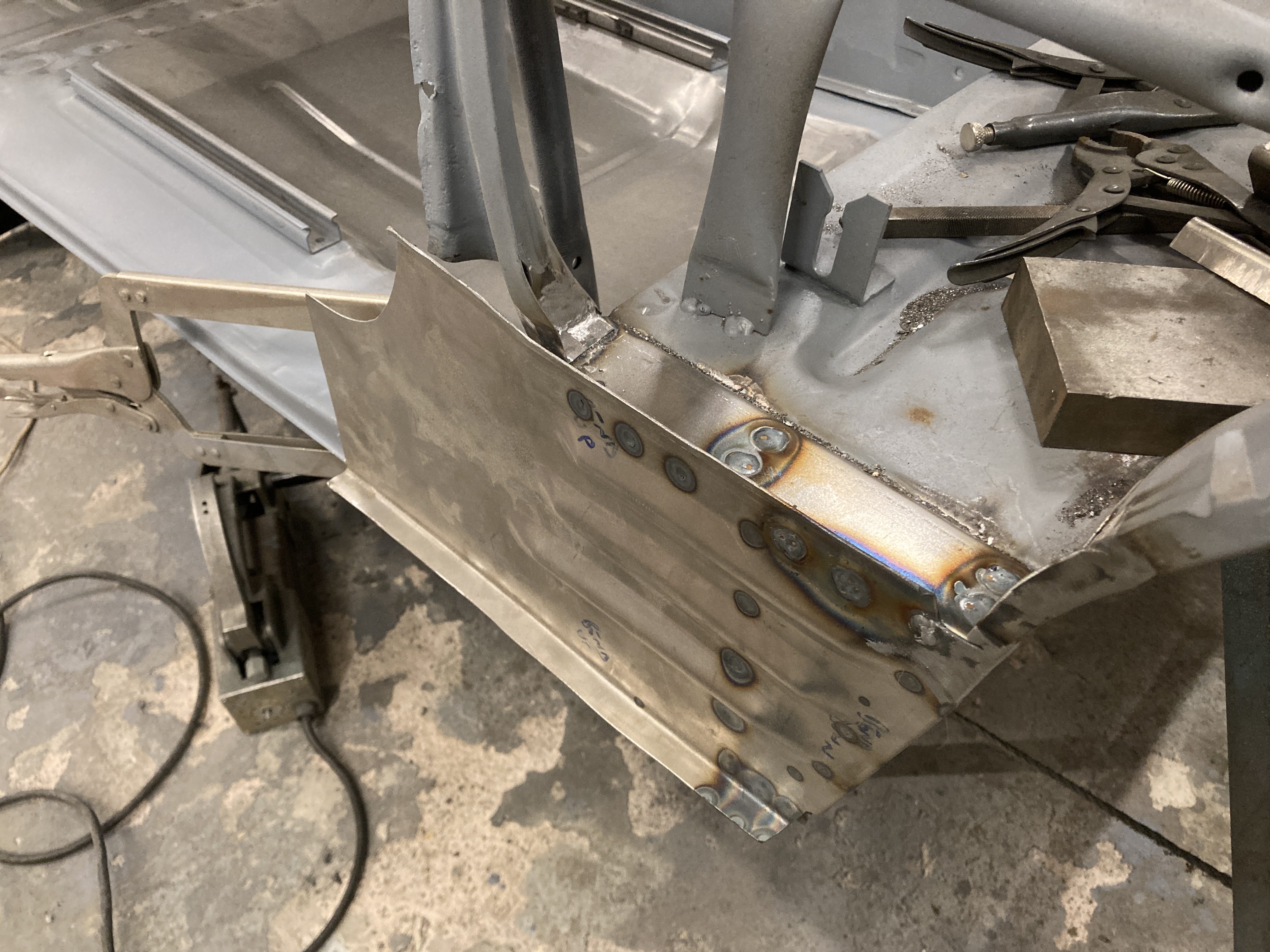

A bit of jiggery-pokery and the inner and outer cills have also been installed to the RHS:-
RHR wheel house outer eyebrow panel installed after checking positioning with dummy fitment of the rear wing panel:-

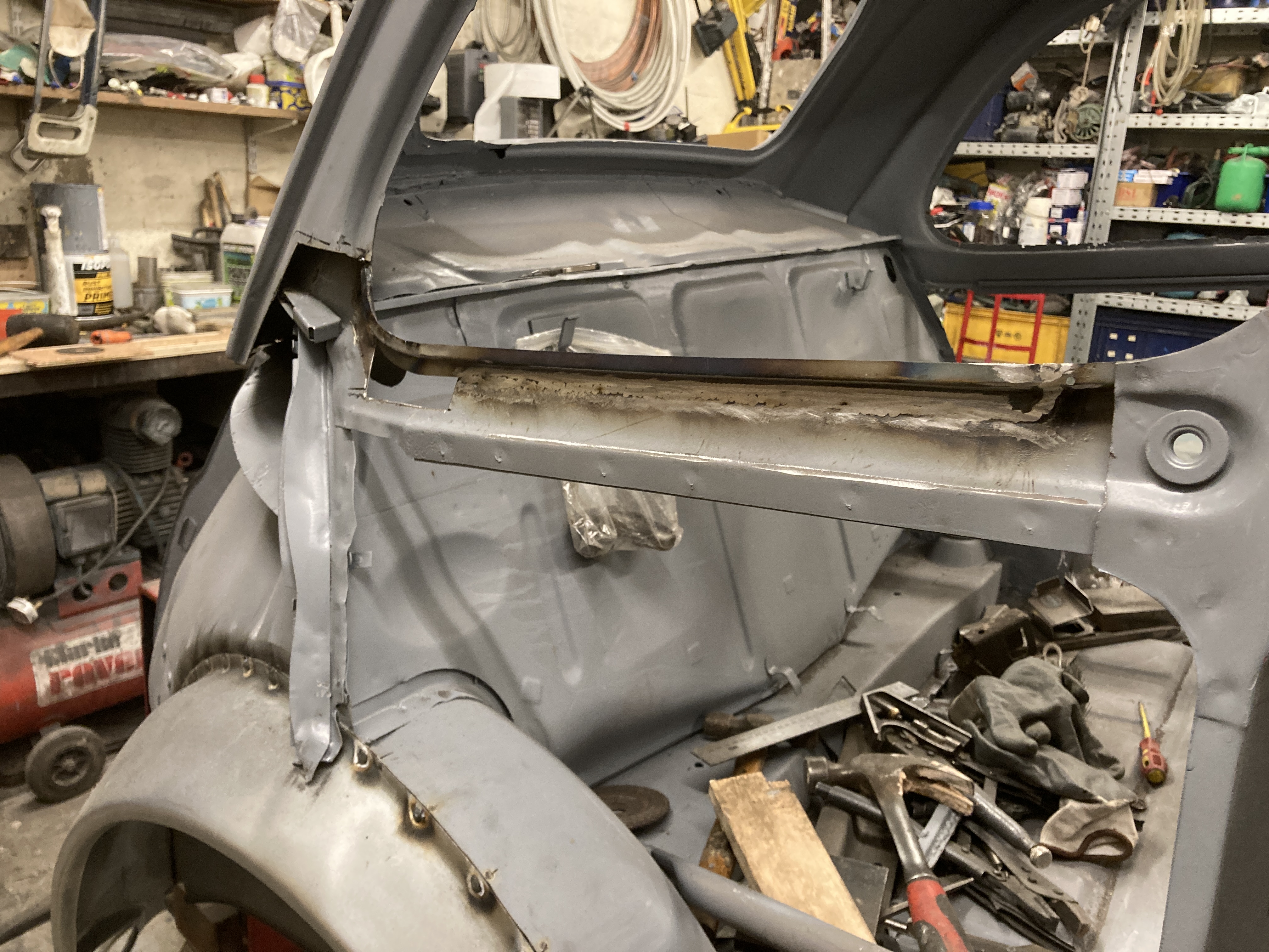

Before the rear wing panel could be fitted there was a repair required to the horizontal rail below teh rear side window. There was a very poor quality repair that had been made at some point in the past. So I made a jig to form the panel and then welded it in place:-
A coating of zinc primer on the hard to get to bits and the rear quarter is fitted in position ready for welding:-

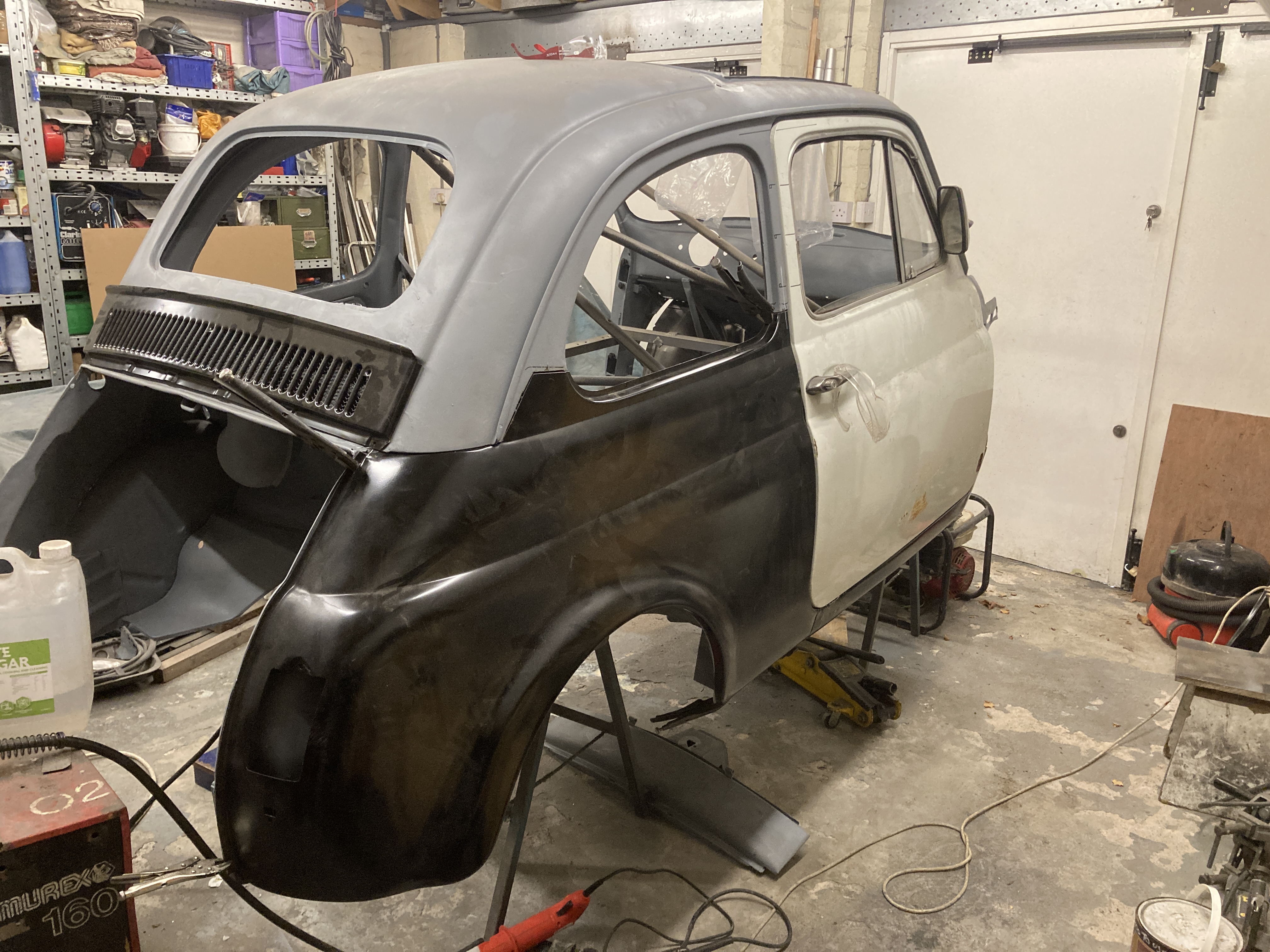

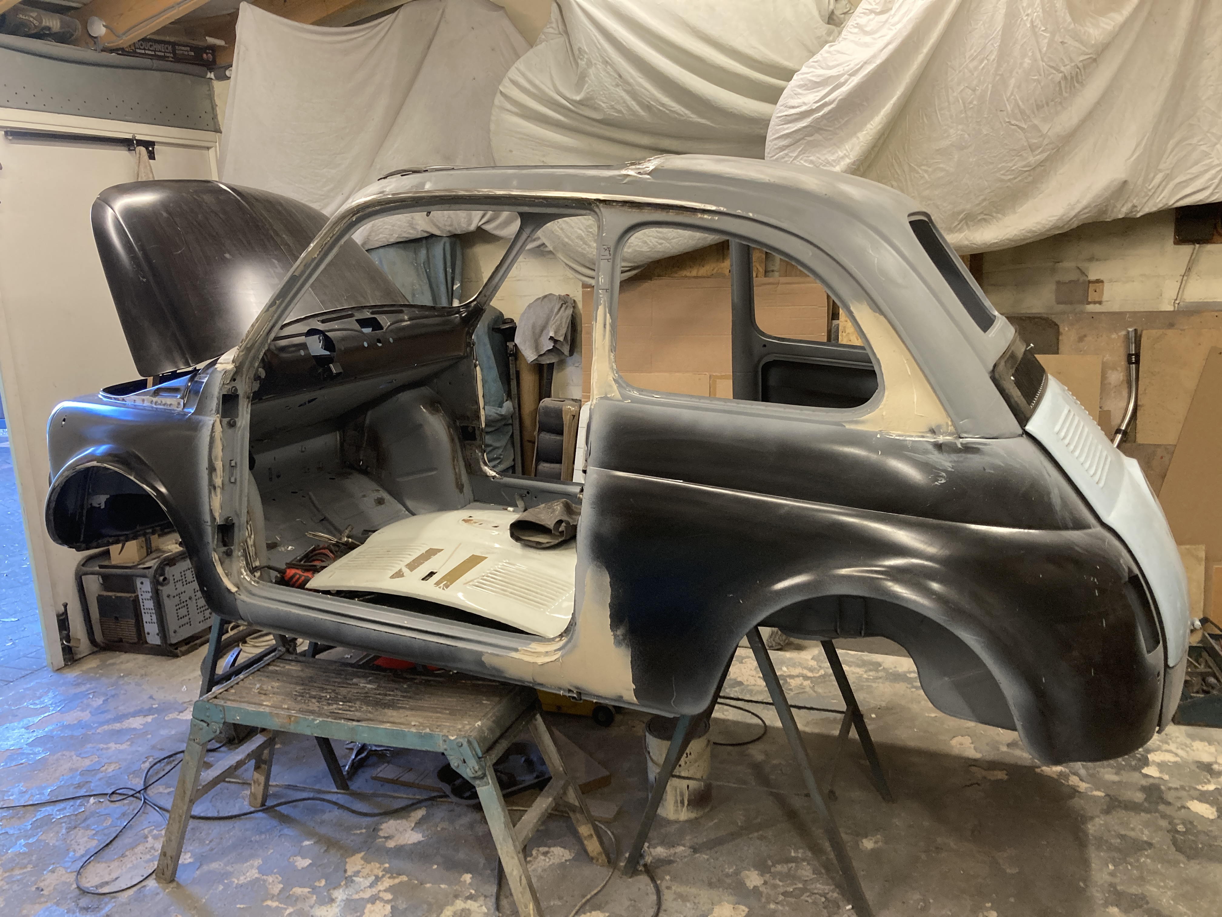

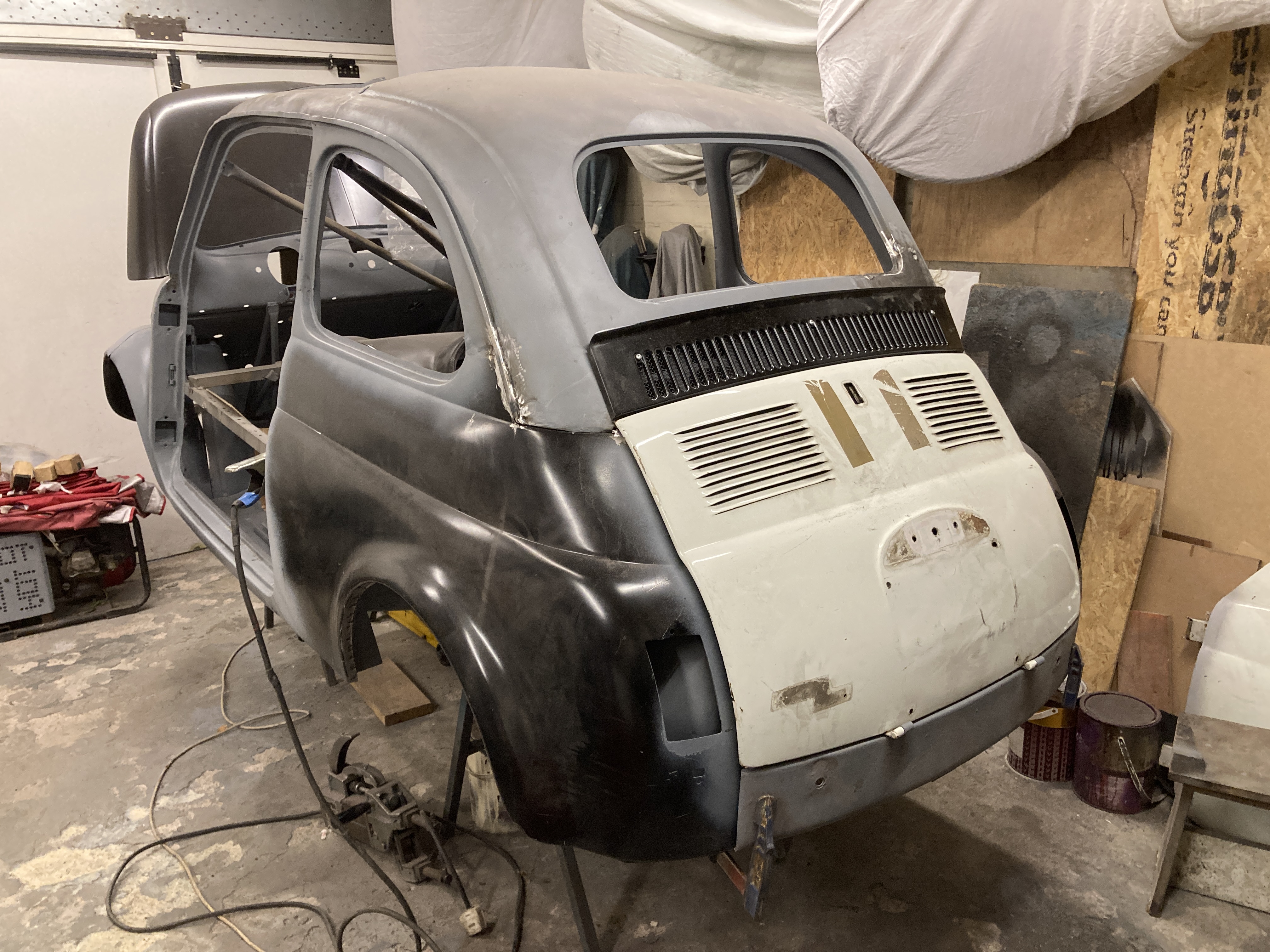

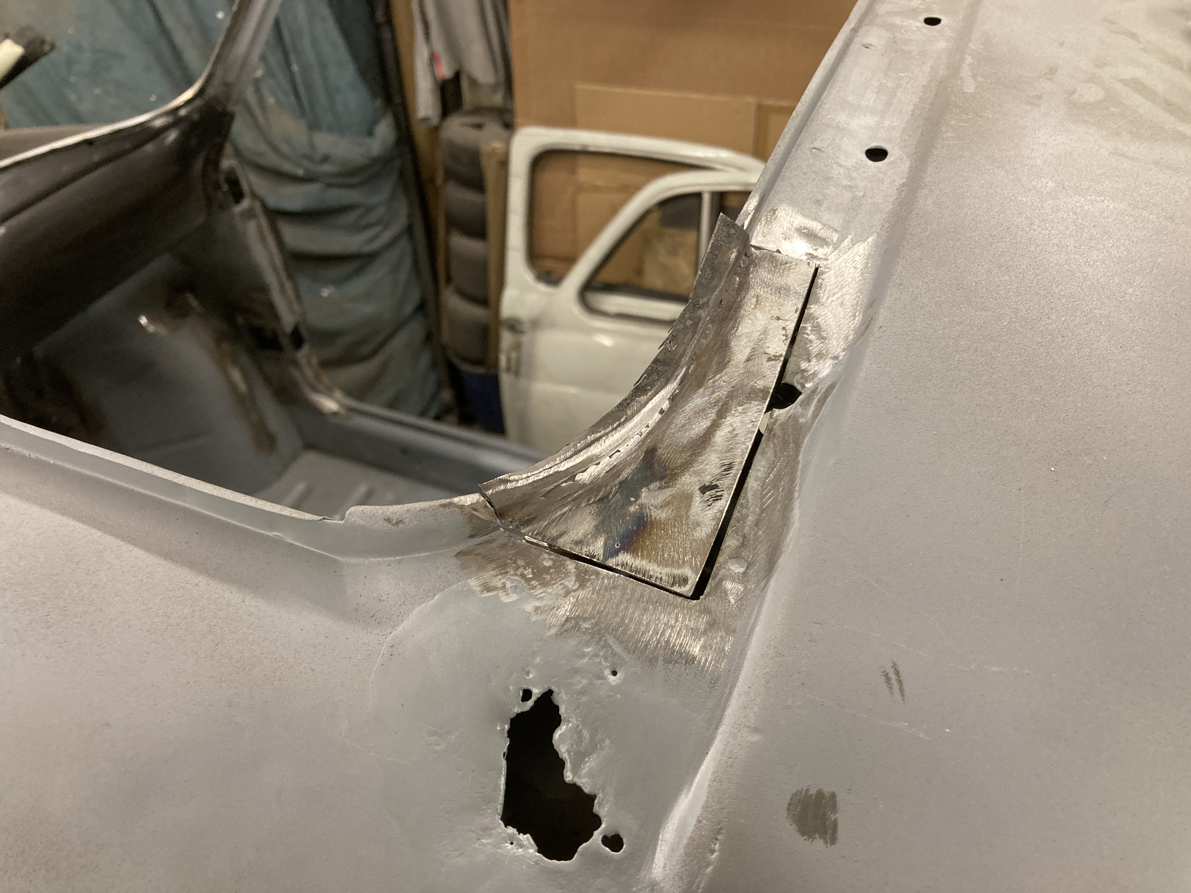

It's been a while since the last update of how the bodywork is progressing, but I've managed to get quite a lot done....

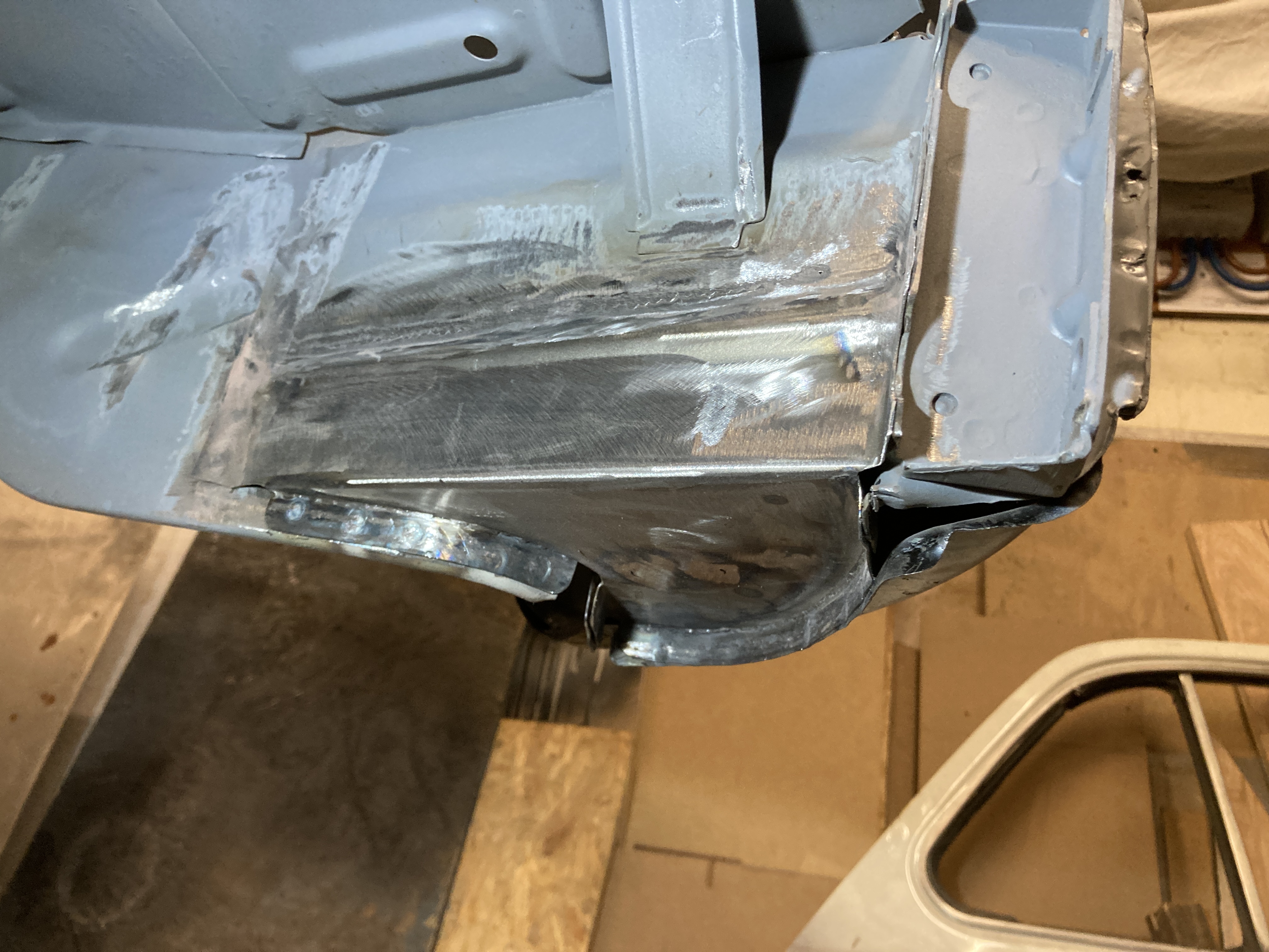

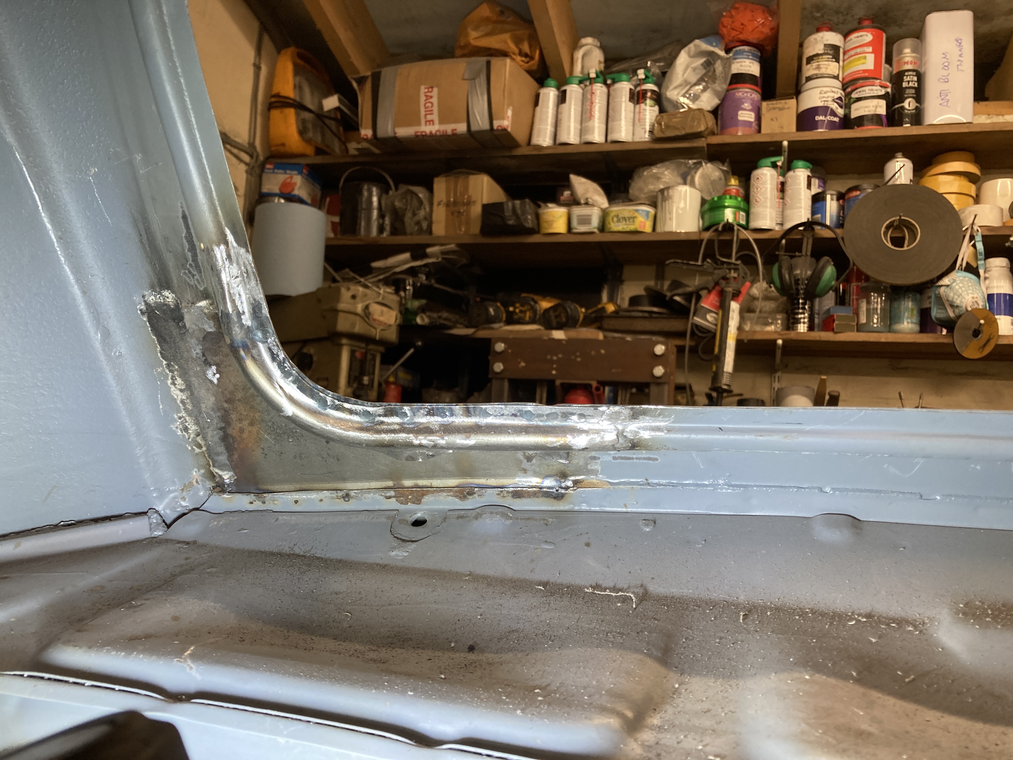

The LHS of the car is now back together from the a-post rearwards. I had to do a repair to the end of the gutter as the new rear quarter panel didn't align properly with the end of the existing gutter. I've used some M5 rivnuts for the fixings of the grille above the engine lid rather than using self-tappers as I've never liked using screws for that sort of thing.

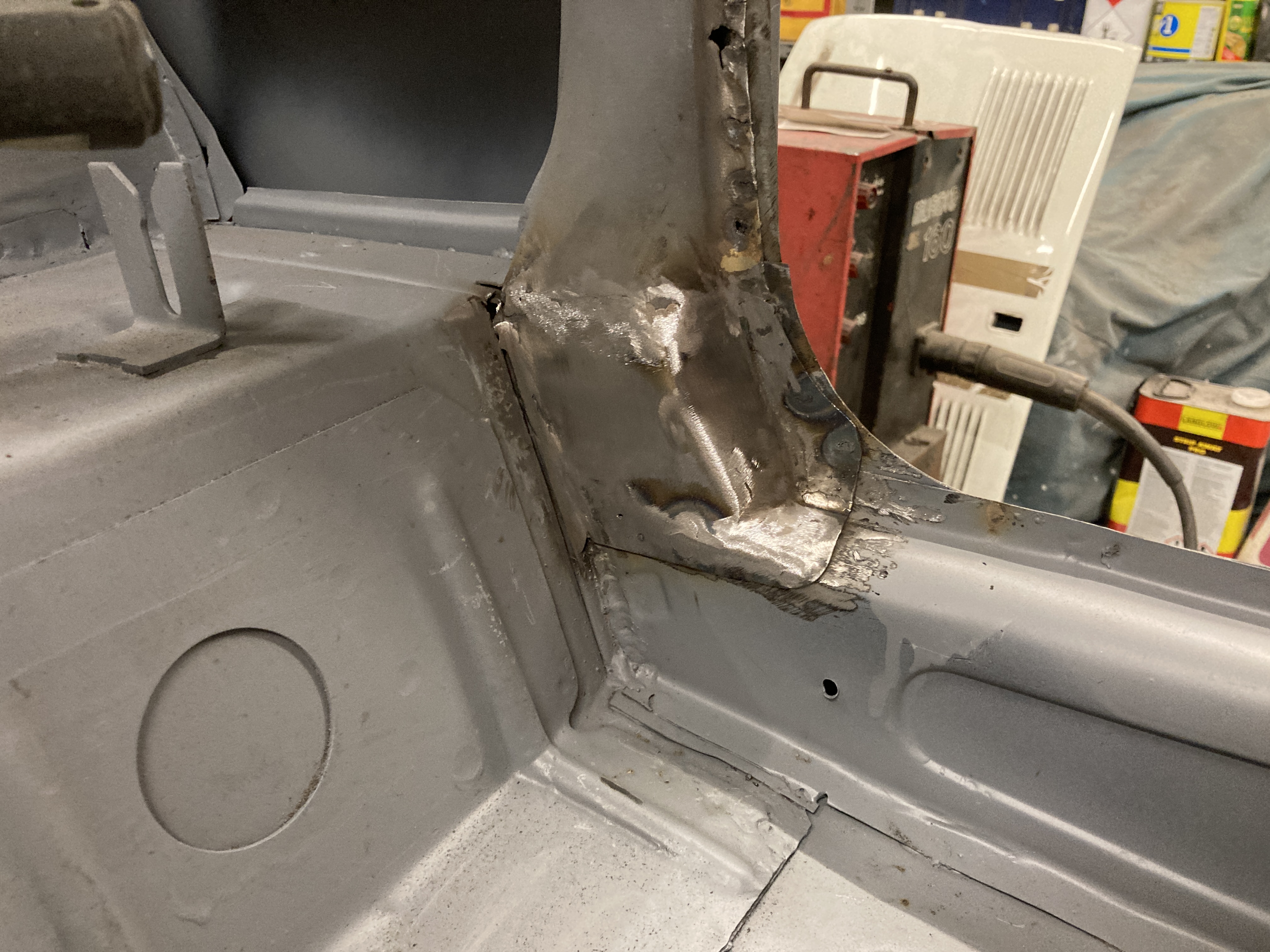

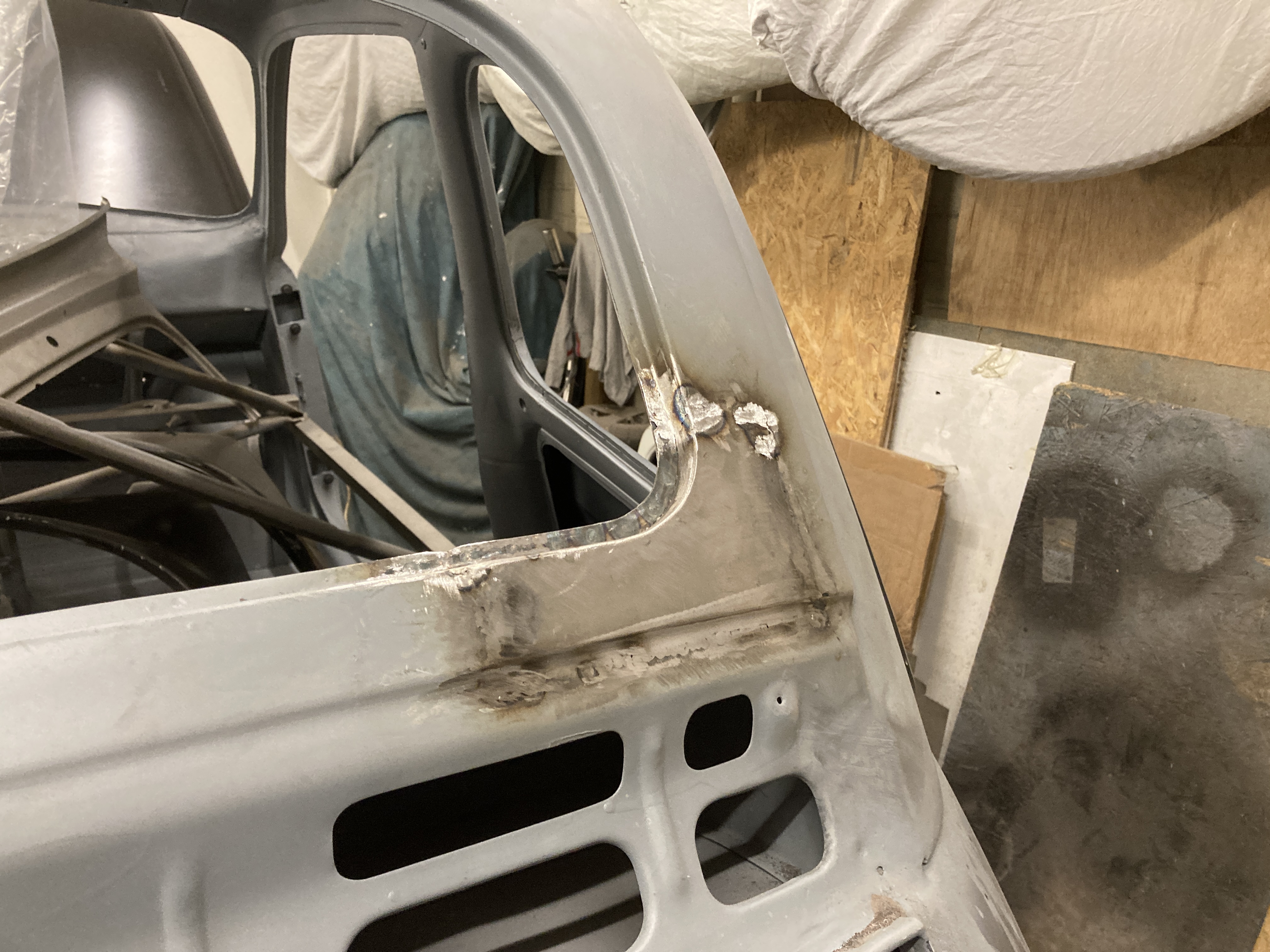

Some detail of the repair to the lower corner of the rear window aperture. This had been poorly repaired in the past so i cut that repair out and made a better job. It'll need a bit of filler to get the shape right.

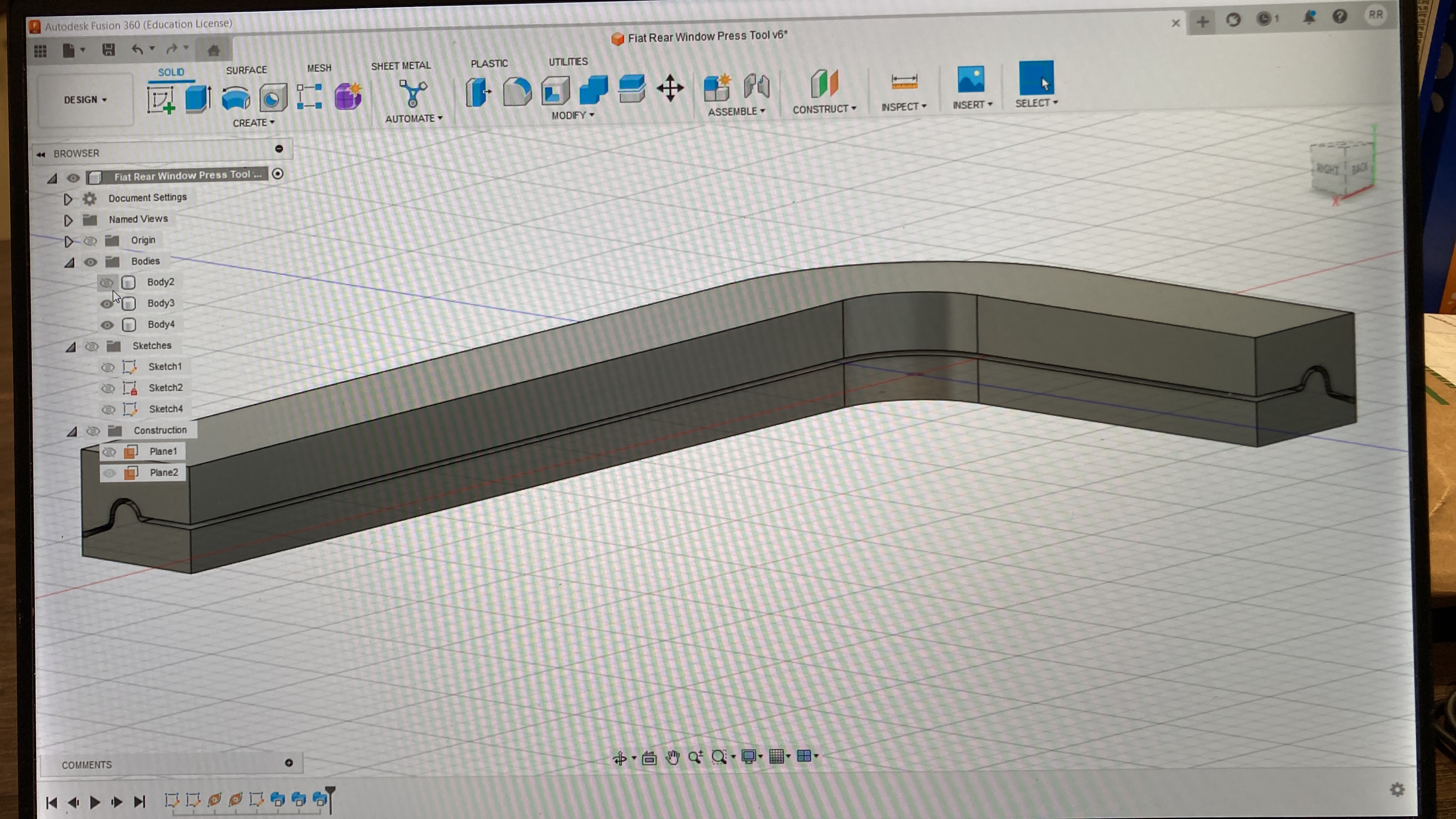

I drew up some press tools in CAD and 3D printed them to make the inner surround part. I was happy that the tool worked and then welded the part in place. Again, a little bit of filler required to get it just right.
Next onto the rear right hand corner of the engine bay. The corner fillet panel had been used as a jacking point at some time and been crushed, then become rusty, so I cut it out before the shell was blasted. I made a panel and then installed it
Then onto the most expensive panel of the reconstruction - the dash. To cut the old one out and fit the new one only took a couple of hours....the new panel was a very good fit.
Now it's time to move to the front of the car. Scuttle next, then the wings/front panel/inner front panel.
All the structural work and welding on the bodyshell is now complete.

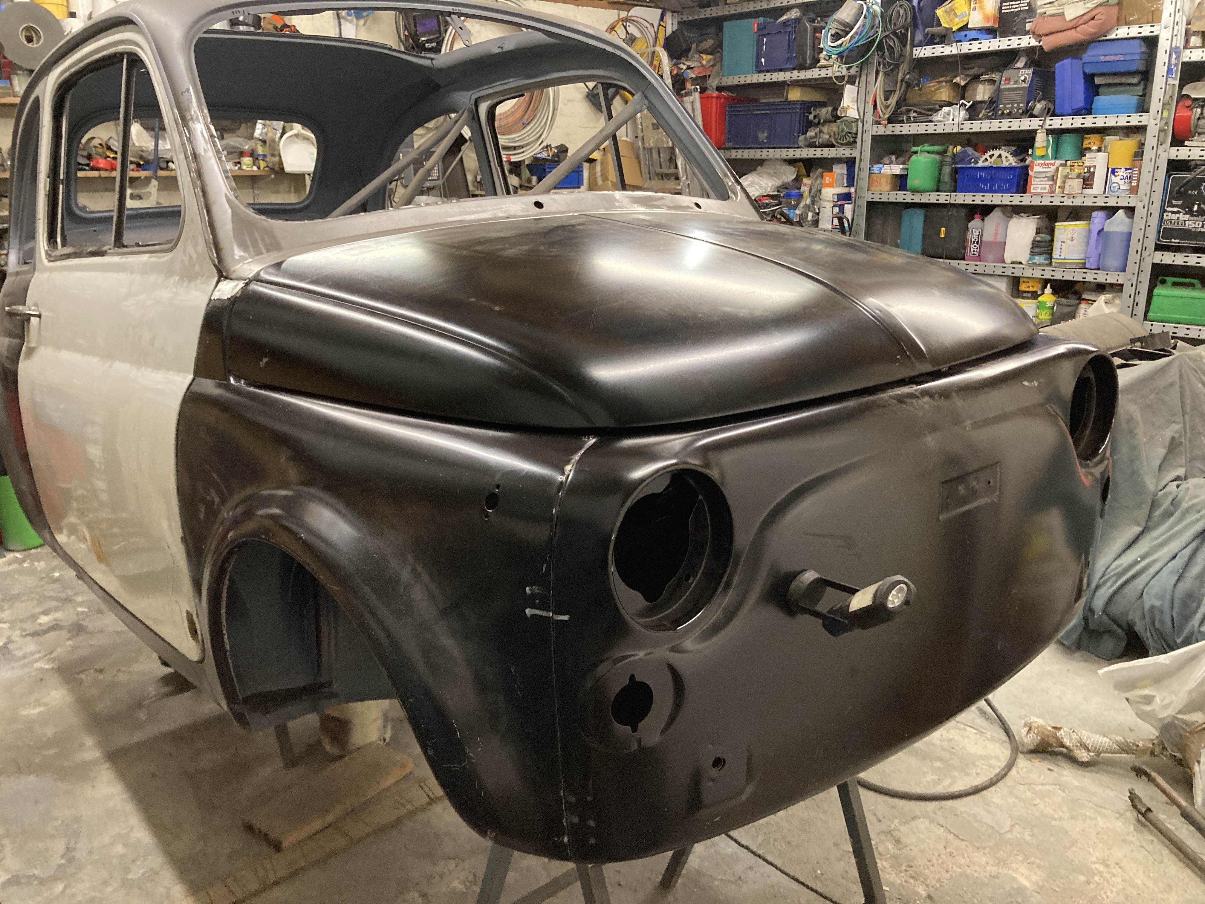

Scuttle welded in position along with the front panel and wings. It wasn't a perfect fit where it meets the original parts of the A-post by the windscreen, but again a skim of filler will make it look right. Getting the whole lot to line up was a bit fiddly.
Once the front end was all welded in place I cut out the framework as there was now no risk that the body could deform.
I then welded in place teh repair panels I had previously made for the bottom of the B-posts. At the same time I made up two formers and made panels to repair the A-posts and then weld those in place.

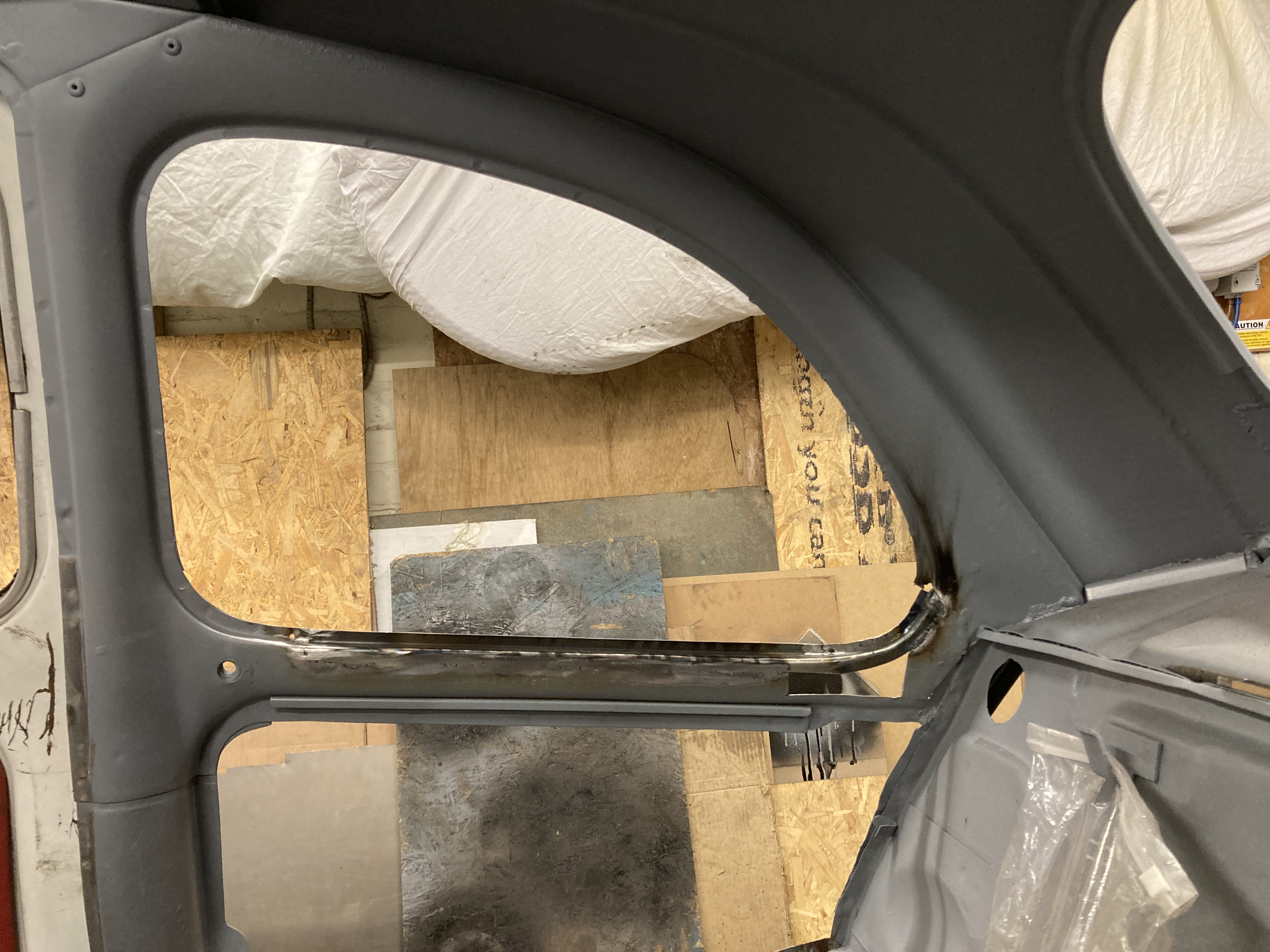

As I've mentioned previously the LH gutter and roof had been damaged at some point in history. The gutter condition was not recoverable so I cut it off, folded up a new section of gutter and welded it in position.
There were a few little repairs required to the roof where the LH rear of the hood attaches. The other hole is also repaired, but I haven't got a picture of that to hand....
And that's it for all the welding. It's all done...at last.

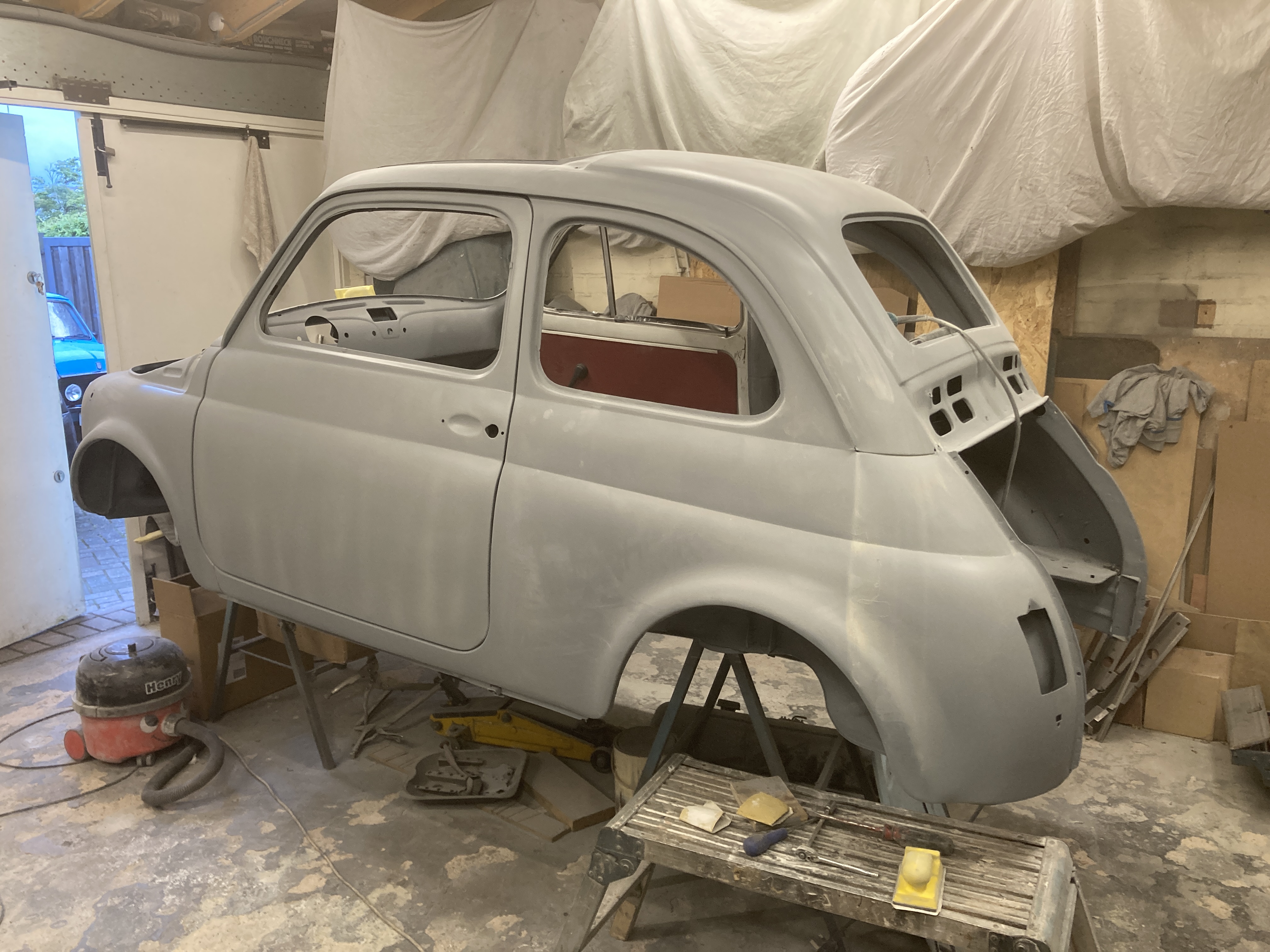

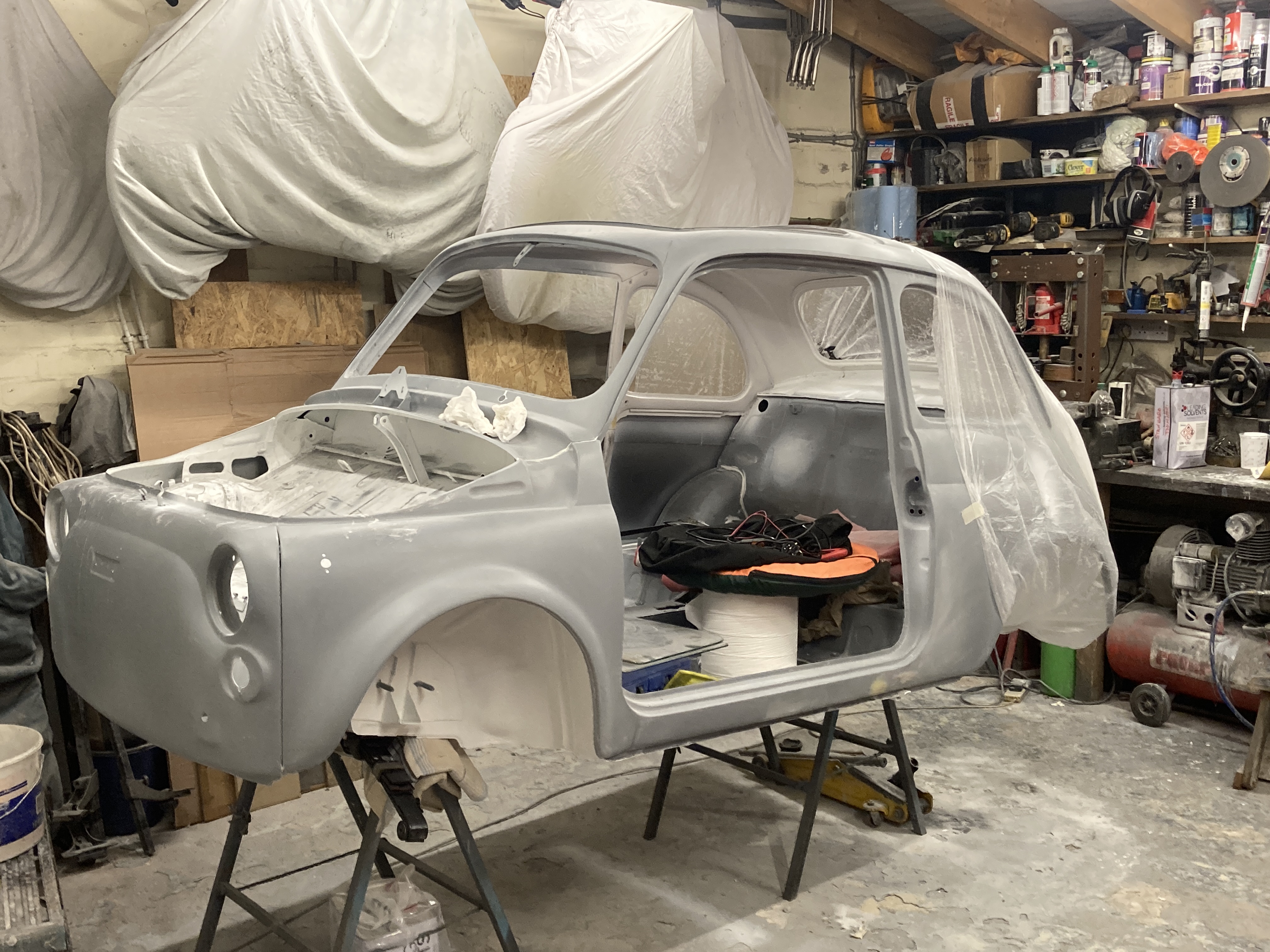

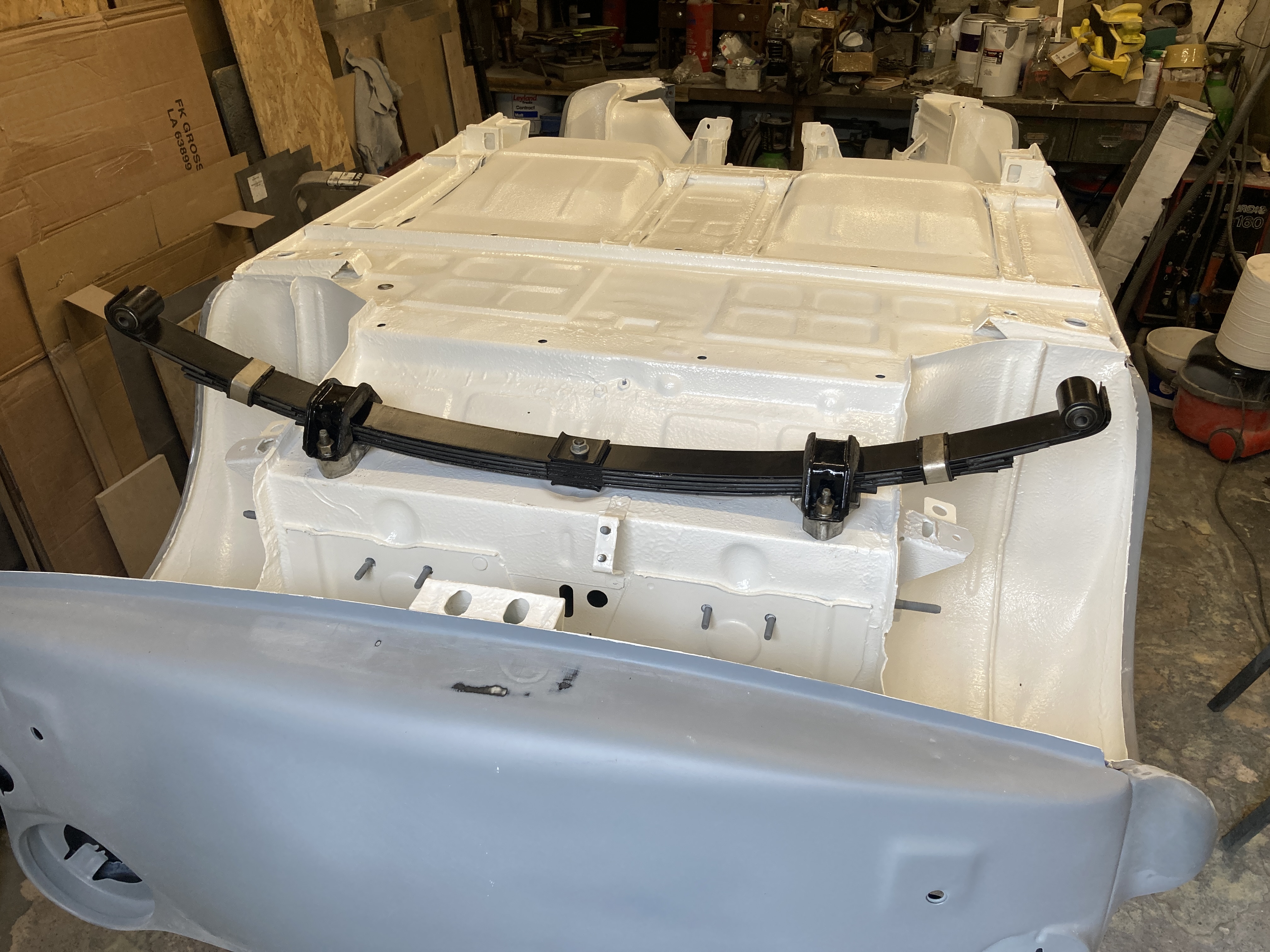

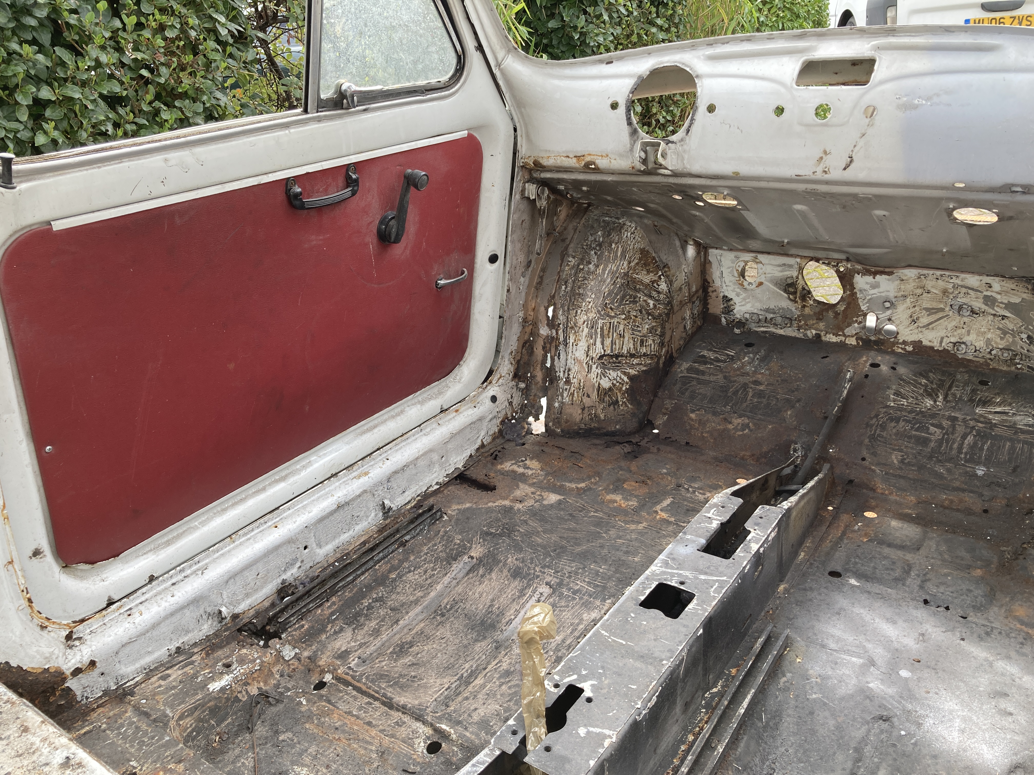

After the last update the body has now been filled where necessary and given a coat of zinc primer where it needed it. It's nice to see it all in one colour!
The body was then flipped upside down for the underside to be given a coat of raptor to protect it, and once that had cured it had it's finial finish of Fiat 233 White cellulose.
Then the big step of actually bolting something to it that I wasn't going to take off again - the front spring - as it's simpler to install it with the body inverted.
Also whilst it was inverted the interior roof and the panel below the fuel tank were prepped and finished in white - much easier to do prep them and spray them when it's not the right way up. These are in-prep pictures, though these areas are now finished in 233.

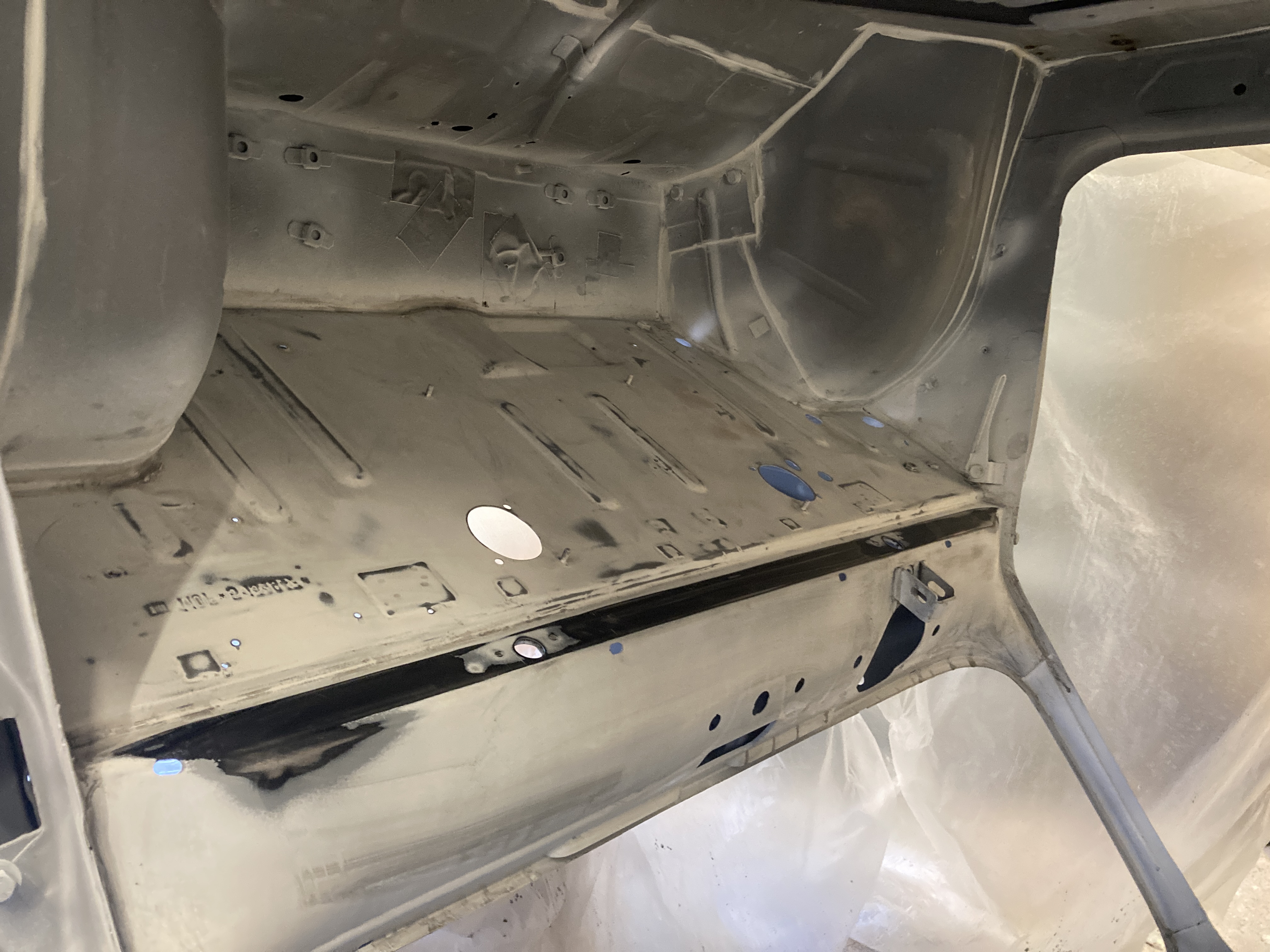

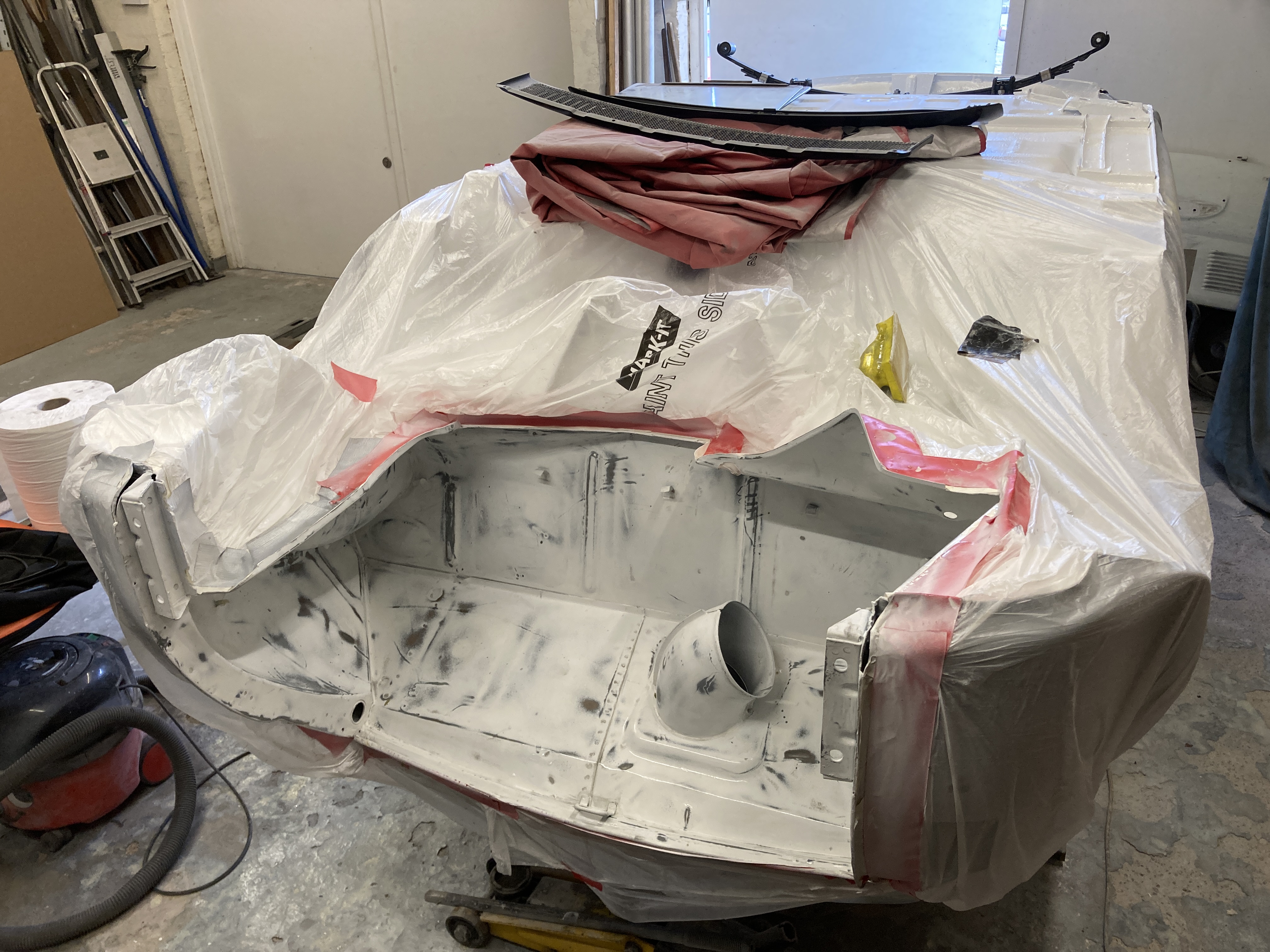

Also while inverted the engine bay area received it's filler primer then the upper surface also had it's finish of the final colour.

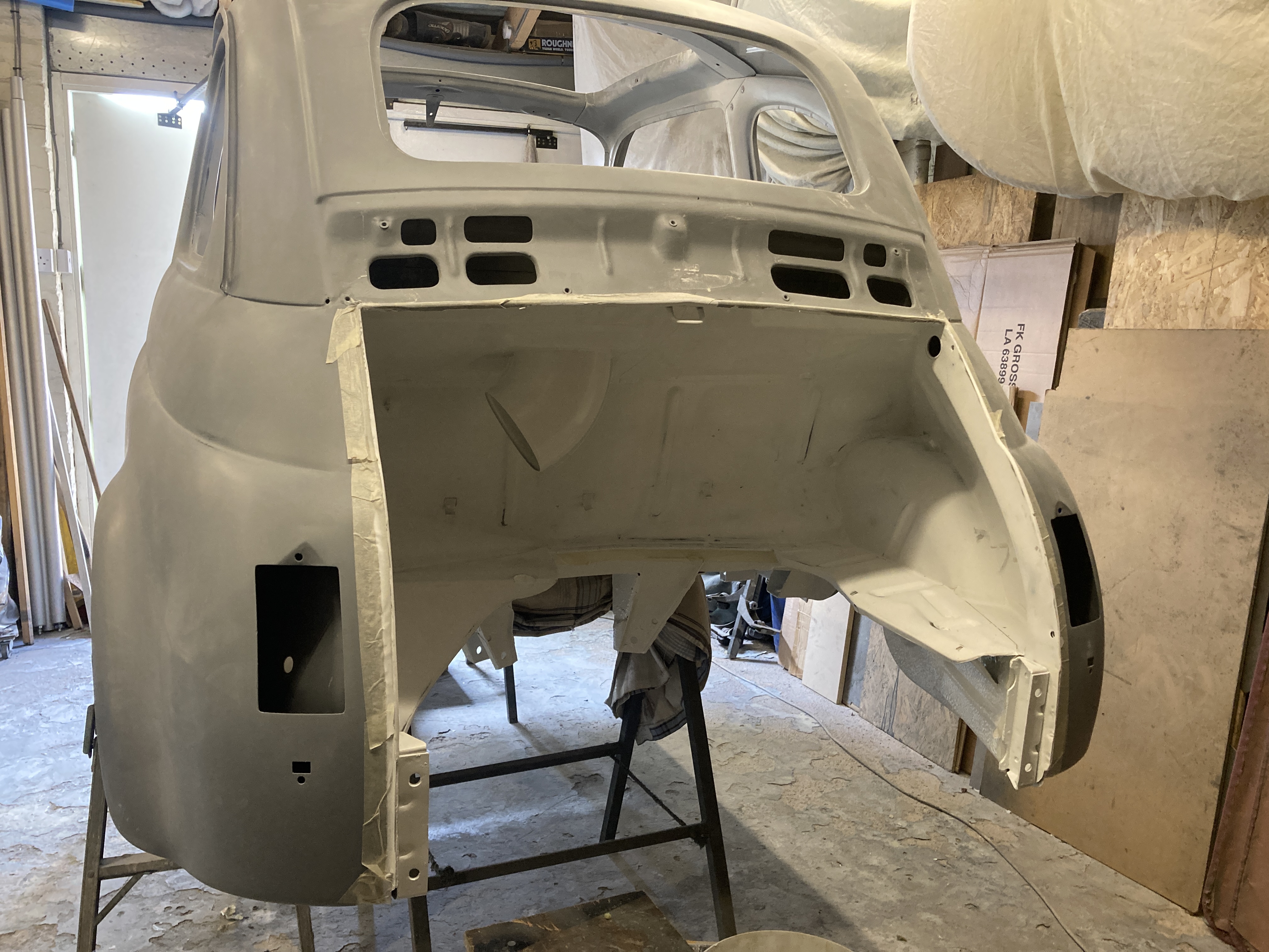

That was it for an upside down car. It was then turned over and the rest of the engine bay given it's final finish.
Next was the area under the bonnet. Am I allowed to call it a 'Frunk', ir is that too modern a term?! Filler primer has gone on and that's currently in prep for the final finish, which should go on in the next day or so.
I stood back and looked at it this morning and thought 'It actually feels like I'm getting somewhere'!
So final finish in the frunk next, then onto the rest of the interior of the body.
