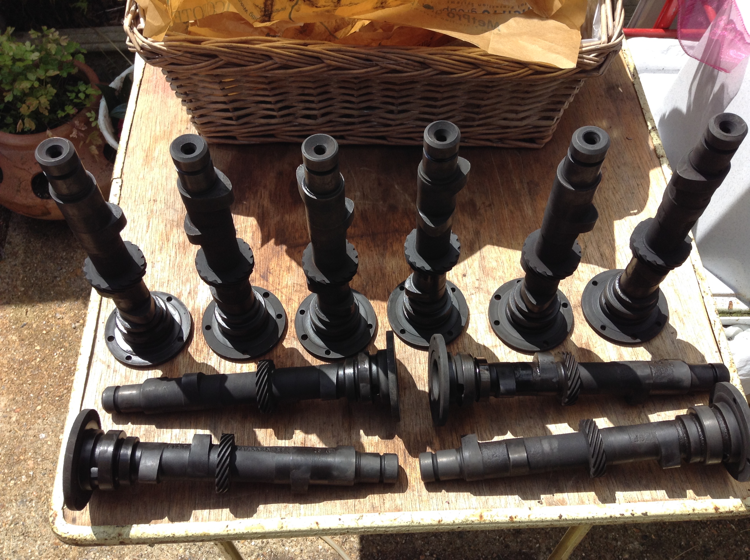

Hi , yes that was nine years ago and if my memory serves me well yo were the first to buy one of those. That project was a journey and a bit of a story. I was told by a reliable source that a well known Abarth garage in the UK were no longer buying 35/75 camshafts from Italy but were having good used 500 and 126 camshafts reprofiled to a sport aspect by a UK specialist. Sounded interesting and a potential plan so I got together with a fellow Fiat fan and between us we had 17 used camshafts. I checked out the full specification for a 35/75 sport/fast road cam then contacted a camshaft specialist and managed to speak to the man at the top. I always remember the conversation as my knowledge of cam technology was limited. I asked if it was possible and rattled off all the spec details I had written down. He replied “ah I know what you want” which was reassuring and proceeded with a verbal quote if we supplied a batch of 10 for regrinding and nitriding (case hardening and core refinement for strength and surface hardness). We shipped all 17 to them, they rejected 3 as being too warn and processed 10.
Very pleased with the result and with all the costs we were able to sell them at about a third of the price of the garage at less than £100 making a sport cam affordable to guys that could not afford the higher prices. There was no real profit for us but a challenge and a kind of club thing done through a Fiat forum. Had absolutely no problem selling them in fact at one time a dealer wanted to buy the whole batch which I refused. However the initial idea of doing this on a rolling exchange program broke down because the buyers just wanted to buy the new cam and not do an exchange. I had the last four processed which cost more due to the smaller batch and that was it. As a footnote I was contacted earlier this year by a guy who had just bought a batch of spare parts and he suspected that one item was one of my uprated cams. I found a buyer for him and the cam is now running in a very nice Abarth replica that has just gone on the road and is doing the rounds. 😀
Mine is still in its original packaging 😂😂 not sure if I should use it in the Giardi or not.
You will not be able to do that because like the 126 Bis the Giardiniera has the oil pump drive built into the camshaft.
So can a bis cam be used? I’ve got an engine block for a Giardi which I will use for the modified engine, to keep the original original with matching numbers
I would think that if you can get your hands on a Bis cam there is a good chance. Also almost bound to be a better profile. The Bis bell housing fits the Giardiniera and apparently facilitates an uprated clutch.
