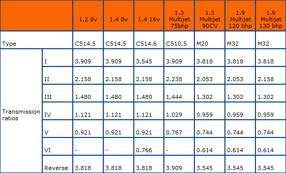

Friend has some problems with his gearbox on 1.9 130 grande sport.
can he swap gearbox from grande 1.9 120hp. They are both 6speed.
or do you have any info if Gearbox from croma 1.9 8v 120hp and opels/vauxhalls will fit?
