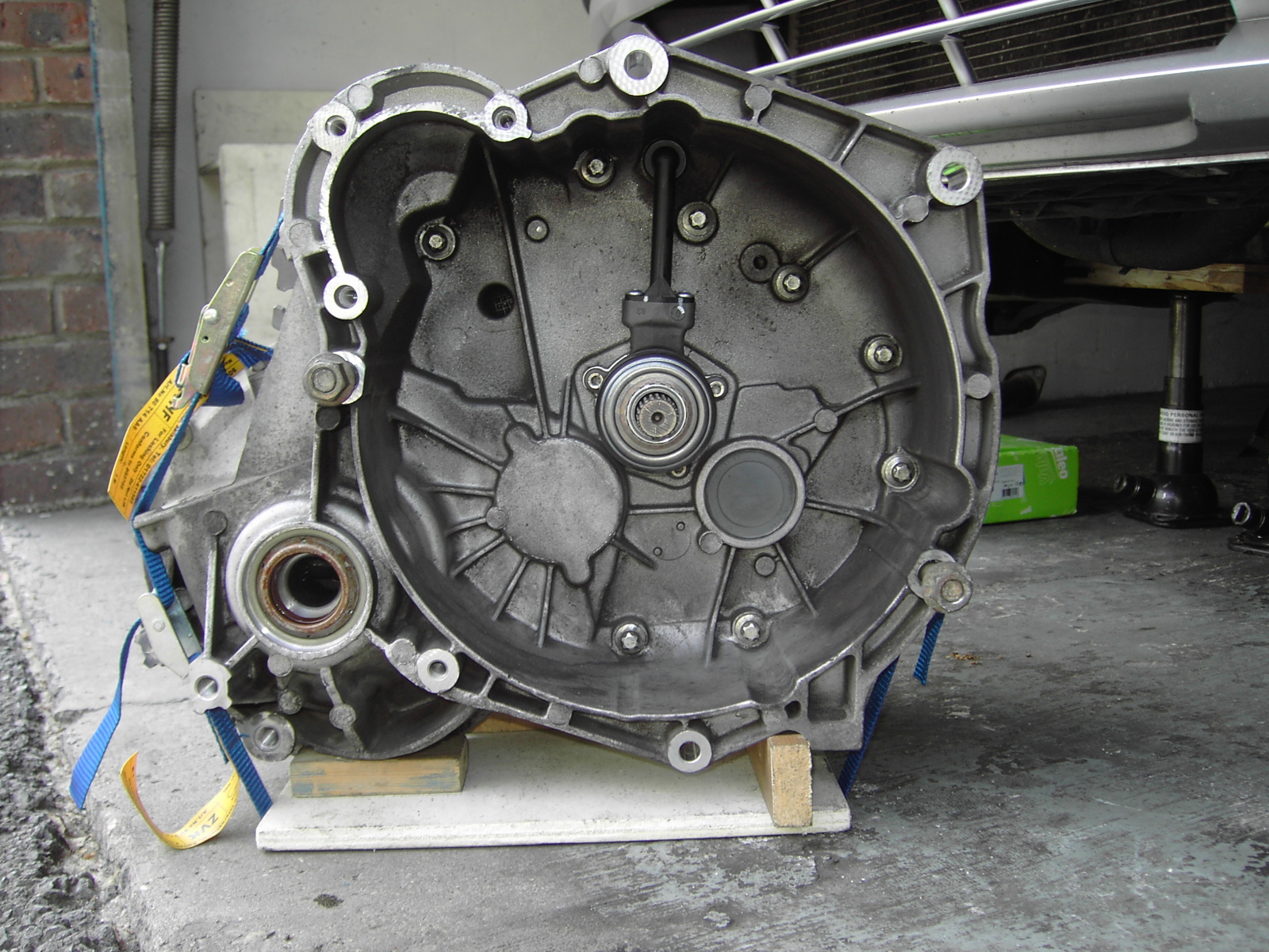

You don't need to touch the right driveshaft, it's held in position by it's centre bearing. When you separate the gearbox from the engine, the driveshaft splined end will stay there as in the picture below.
attachment.php
Now all I have to do is find a burly geezer to help me lift the beast off.. Ralf S.
I rolled mine out on a trolley jack, but as the centre of gravity of the gearbox isn't central, I had to make up a wooden jig for it to sit on the jack pad.
I used a ratchet strap fixed to the garage roof to lift it back in.

I dropped the box out by taking the weight on a trolley jack and pulling/easing it away from the engine and then lowering it to the ground. It does tend to "fall over" / unbalance so you have to support it.
I had a few layers of cardboard on the ground so the 'box had a soft landing when I moved it from jack to ground.. then I could pull it out using the cardboard as a sledge. I had to jack the car up a few more inches to get it out of the wheel arch.

Used next door's 12 year old lad to lie under the car and lift the gearbox back up so that I could re-attach it to the engine.
The biggest problem is physically lifting the gearbox and lining up the output shaft and the driveshaft at the same time. The gearbox wants to "pivot" forwards rather than naturally line up. An engine/gearbox hoist or straps to a beam to take the weight is pretty essential.
