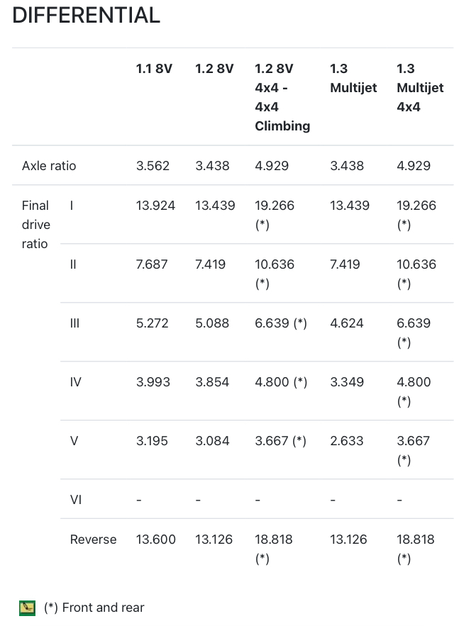

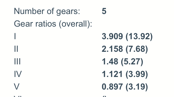

These are the ratios for
early pandas
early 500
Panda 2010 1.1 in that order
I don’t see any change in the eco version
Interesting to see side by side by side
1.2 petrol and 1.3 diesel
If you put a diesel in place of a 1.2
1st stays the same
2nd stays the same
3rd is roughly 4th
4th is roughly 5th
And 5th is a new gear or 6th
The huge gap from 2nd to third on the diesel make the case for a six speed gearbox. Except the overall ratio would be too low.
