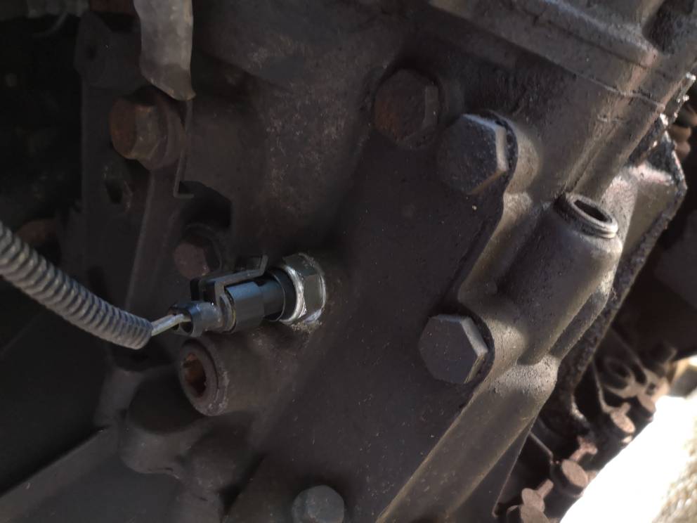

I have bought the oil and have the new reverse light switch and I will do a picture of the process so you can see how it's done
The oil is 75W-85

Oil and reverse light switch change done!
The drain plug is on the end facing the Nearside wheel
Drain plug needs a 10mm Allen key or hex bit
Fill plug is just ubove the reverse light switch and is 12mm hex or Allen key
Reverse light switch needs a 19mm combination spanner
