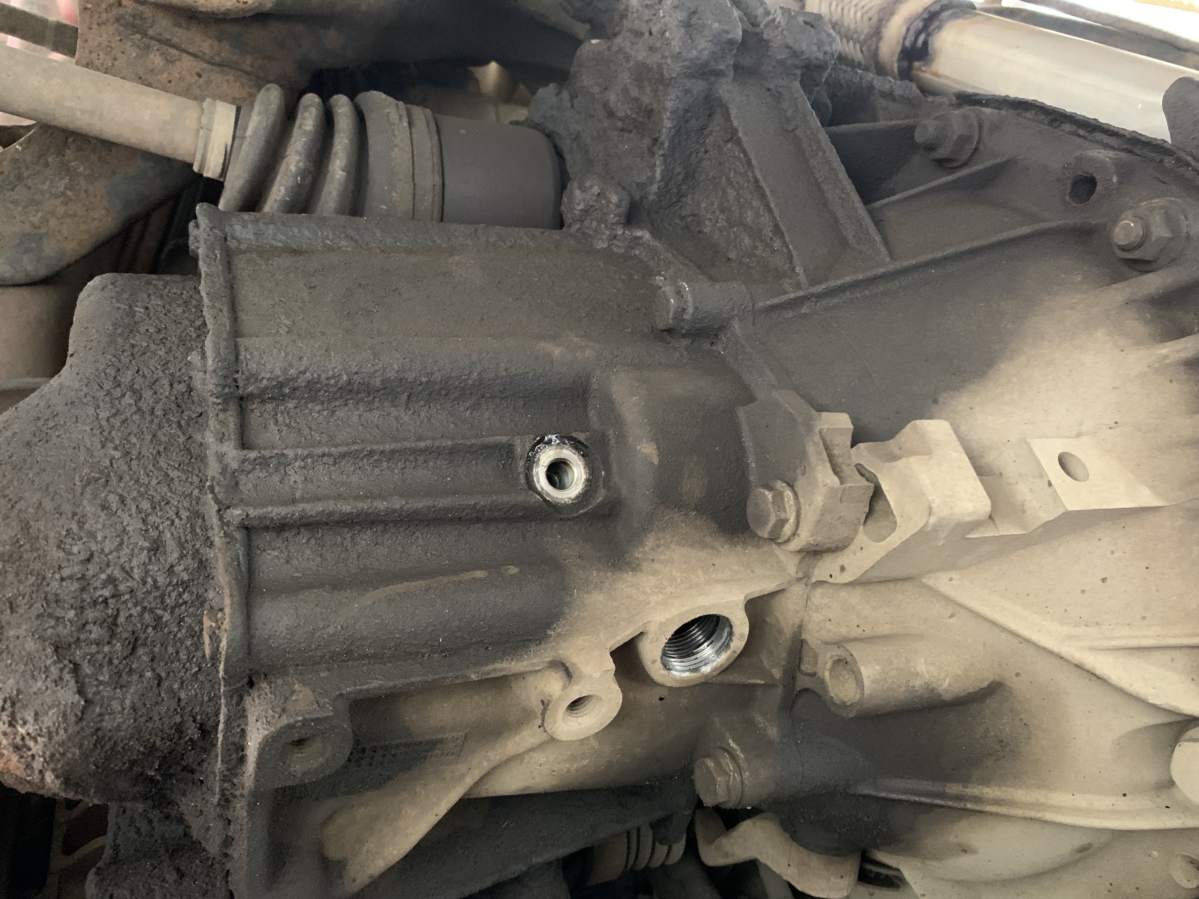

I took out both the filler plug an the drain plug. The large one is the hex plug an the small bottom one is a 13mm nut.
I don't think the right had one will be the drain plug it's Farr too high up the box for that
Most fiat boxes I've seen have been on the rear usually somewhere near the rear mount on the diff side of the gearbox
I can not find another plug or drain nut. I followed the guide on the forum page I put oil back into the gearbox till the oil started to come out the filler plug. I was checking the oil in the gearbox as my car is starting to crunch sometimes when put into reverse. So I though low gearbox oil might be the cause. An then when no oil came out I thought that it was empty an I would need 1.7 litres as the manual states. Through the top hex filler bolt I managed to put in just under 1 litre before it started to spill out.

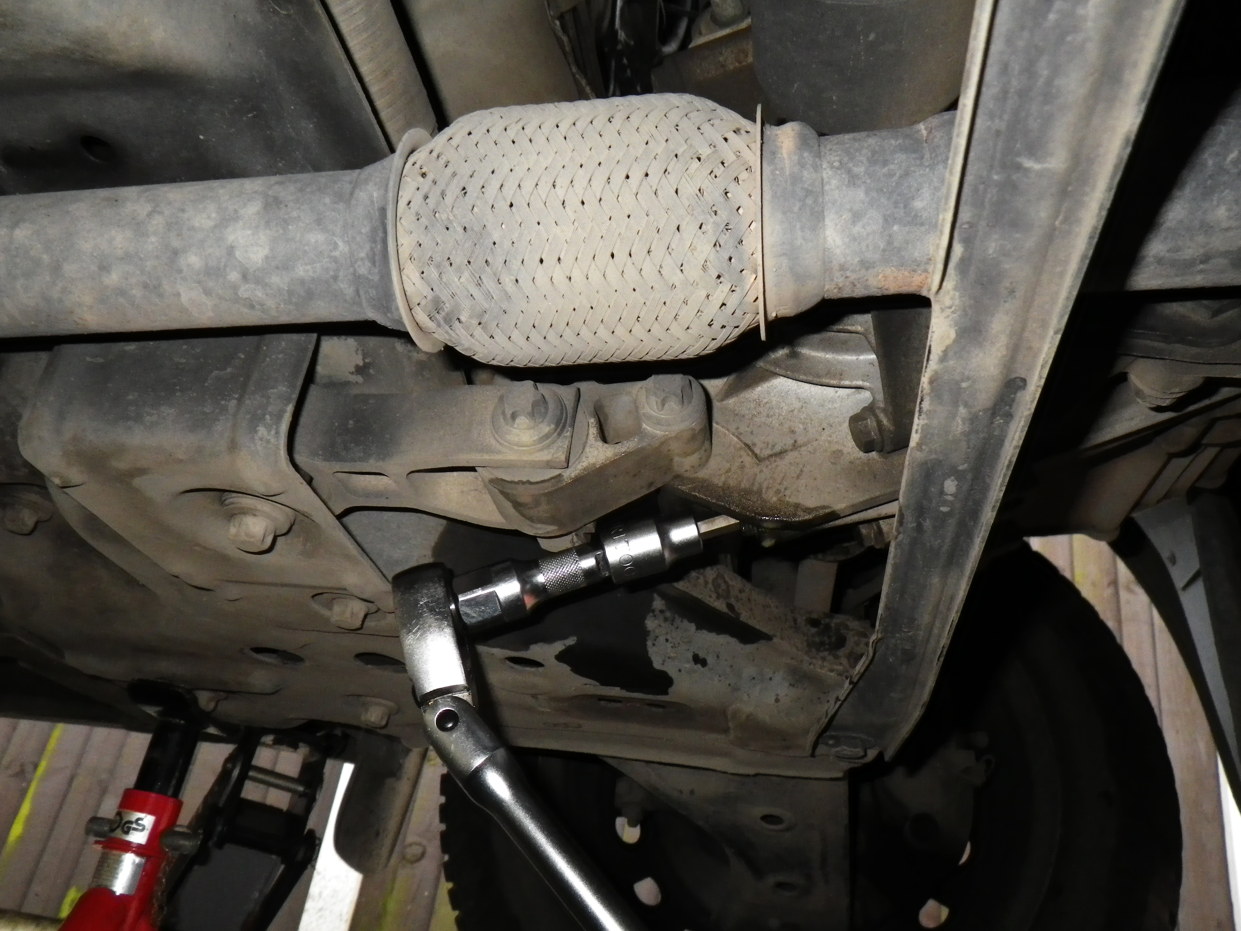

Drain (gearbox oil change Guide). Bottom-rear of the differential. You drain towards the rear of the car.

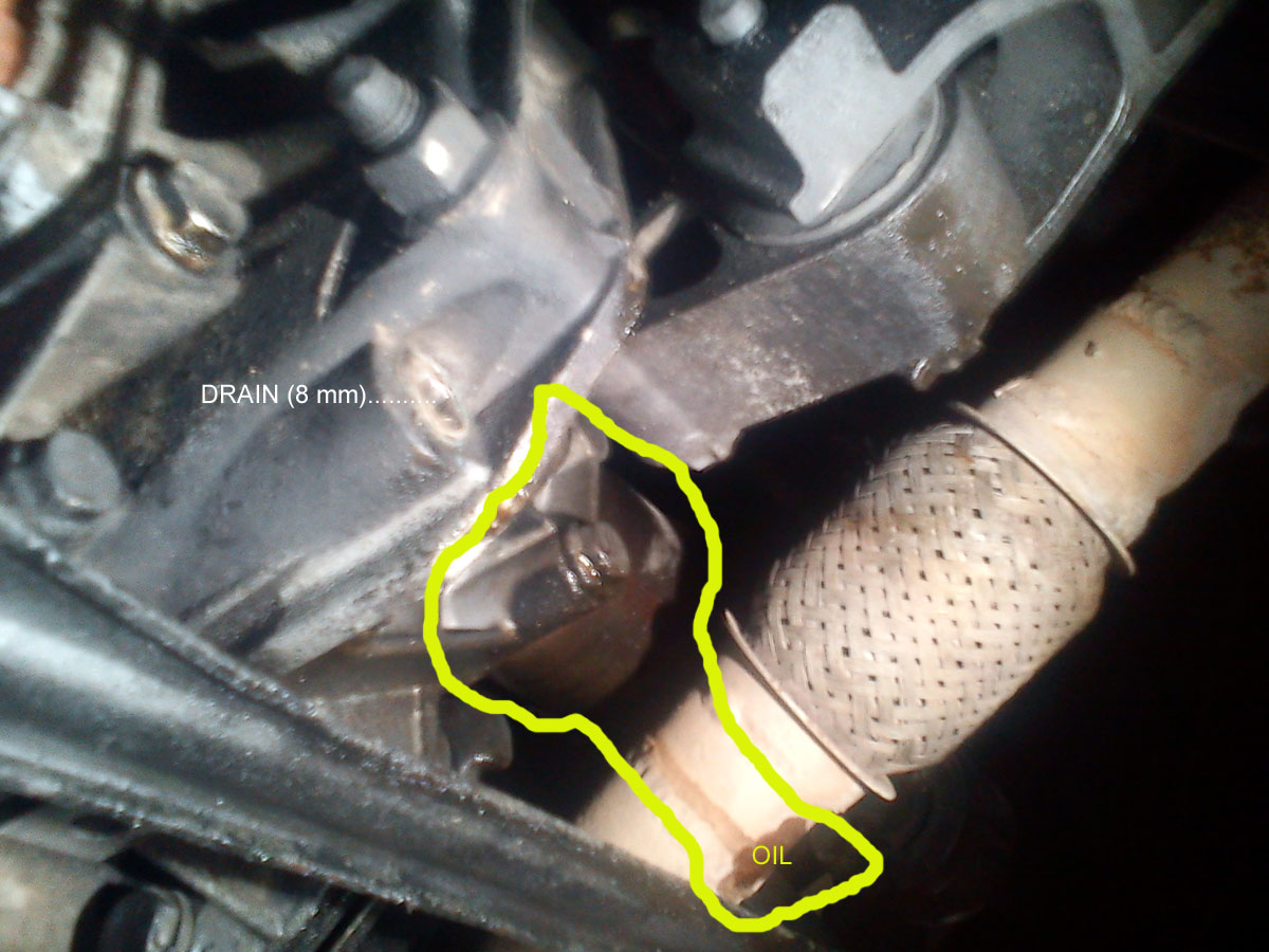

Drain (picture from axles seals Guide). It says DRAIN (8 mm).......... in white text color. Dots are pointing exactly at the plug (picture a bit out of focus, but it's there, 8 mm internal hex).

Your picture...
