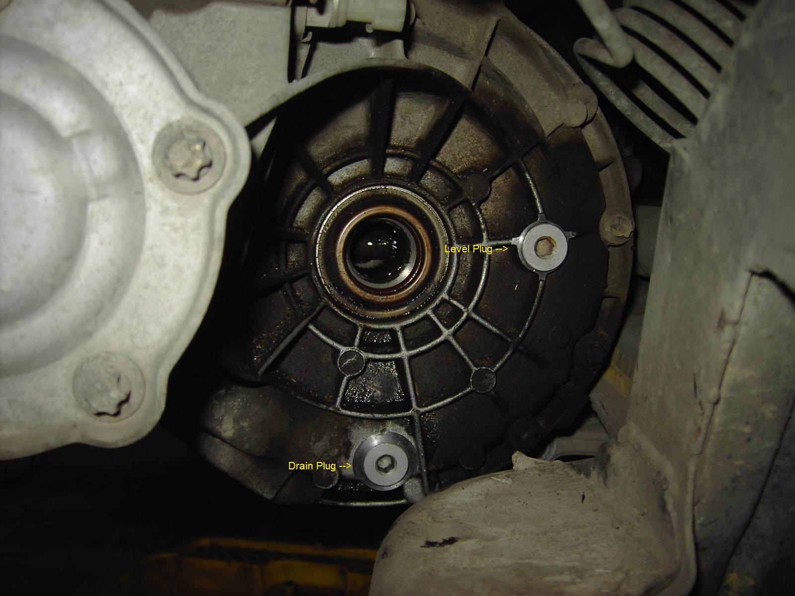

For anyone reading this thread.
Pictures below are from my JTD 115. The drain and level plugs are shown with the driveshaft removed. The filler plug on top of the gearbox is shown with the battery and battery box removed.
Having drained the oil from the drain plug, there are 2 methods to refill the gearbox as follows:
  1. Ensure the car is on it's wheels and on level ground, then use a small pipe to fill it via the level plug until oil just starts to trickle out of the bottom of the level plug hole. OR..
  2. Refill with the exact quantity of oil specified for the car via the filler plug. The car doesn't need to be on it's wheels, or on level ground if using this method, however, see below.
Having replaced my clutch recently, I refilled the gearbox with the car on it's wheels and on level ground. I had both the filler and level plugs out and filled it via the filler plug. The handbook for my car said it needed 1.65ltr of oil, however, it took 1.75ltr before any oil came out of the level plug.
