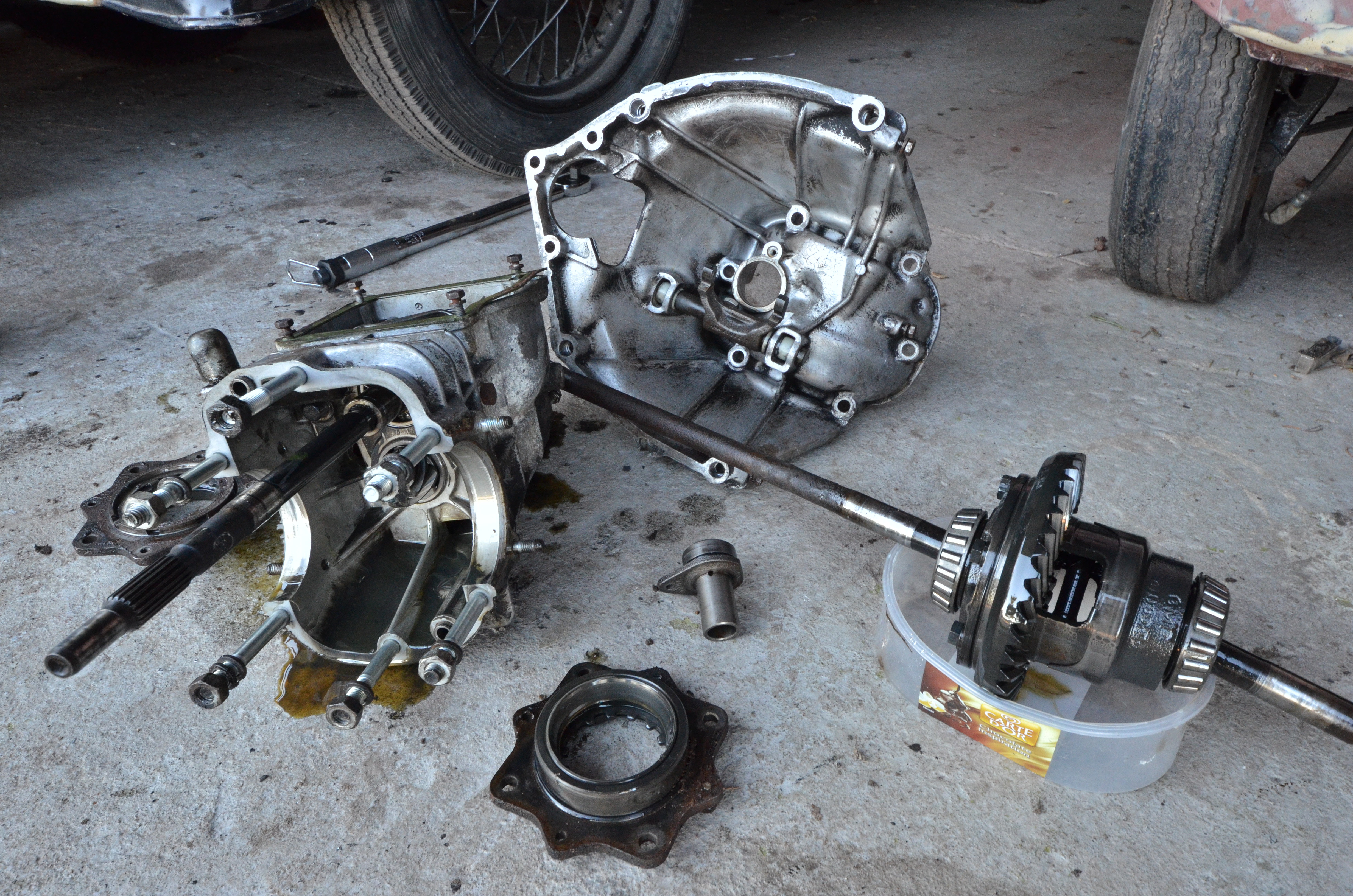

I have an odd issue with one of my gearboxes. A slight whine on 4th gear only and the box has only covered 8,000 miles from new. Has to be down to an actual gear rather than a bearing. MOD it is not like you to have not done a particular job on a 500 nor had I until I got fed up tripping over all the gearboxes I had accumulated of unknown condition so stripped down seven 126 gearboxes at the same time. Cleaned every single component and after a visual inspection I scrapped anything that was broken or obviously worn then with the addition of a few new components I rebuilt three whole gearboxes and one part gearbox using the Haynes manual as my guide. I have rebuilt a few other gearboxes since then but am still left with a whole pile of gearbox parts which I have dipped into from time to time to help guys out with parts. Think I also have brand new gearbox castings up in the loft.
I came across a range of problems in the gearboxes I worked on so you never know what you will find until you et in there. Apart from expected broken or worn gears and bearings there were broken selector forks, bent shafts, broken detention springs or rusted up detention balls, missing or incorrectly assembled parts etc. I would say think in terms of new bearings then inspect the rest. If anything looks dodgy I will probably have a good used part here apart from the dreaded 1st/reverse.

I agree with Ian's point about rebuilding before swapping, but I don't think I'll get much more out of the gearbox before it fails. So I'll likely end up not suing the fiat for a while. With work and kids etc, I've always been a fan of swap first repair later.
The gearbox in the car has a dodgy synchro and now a noisy fourth, but it has a good first. I'm keen to strip this one since first gear is one of the best I've had.
If I have to buy a new first gear to build a second box then so be it. I'll be replacing bearings while it's apart. May as well.
Some jobs I am happy to do, but gearboxes do not appeal to me! I'll have to get over it though. I'm not paying someone else to do it!

The gearbox may look daunting but anyone who can build a Lego 500 could rebuild a 500 gearbox. The challenging part is getting your head round the crownwheel and pinion and its mesh and preload. But in theory you are spared that task as long as you re-use the differential bearings.
