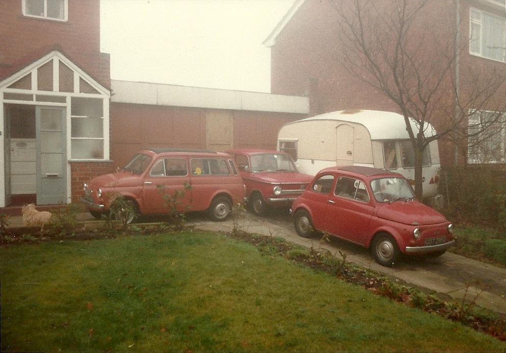

My 500 was 1967 I fitted a new 650 engine and gearbox after a terrible journey from B`ham to Plymouth with three of us.
Then the other reason was I used it for commuting, I had to join the A34 at 50mph or get rear-ended.
The engine was tuned to my best ability, the gearbox was a secondhand one from a car that I had driven a lot.
In use my tuned 500 could wheel-spin and 50 mph could be achieved instantly, with a top speed of over 85mph.
the fiddly part was fitting the 500 driveshafts to the 126 gearbox and of coarse the wiring to the starter motor.
in all a worthwhile mod, I hope you enjoy yours as much :)

A 500, a Giardiniera AND (unless I am mistaken) a NSU---quite a collection. When I was at Radbourne Racing, our 'parts van' was the van version of the Giardy, with a 652cc Nardi conversion. It made for a fairly rapid little van!
