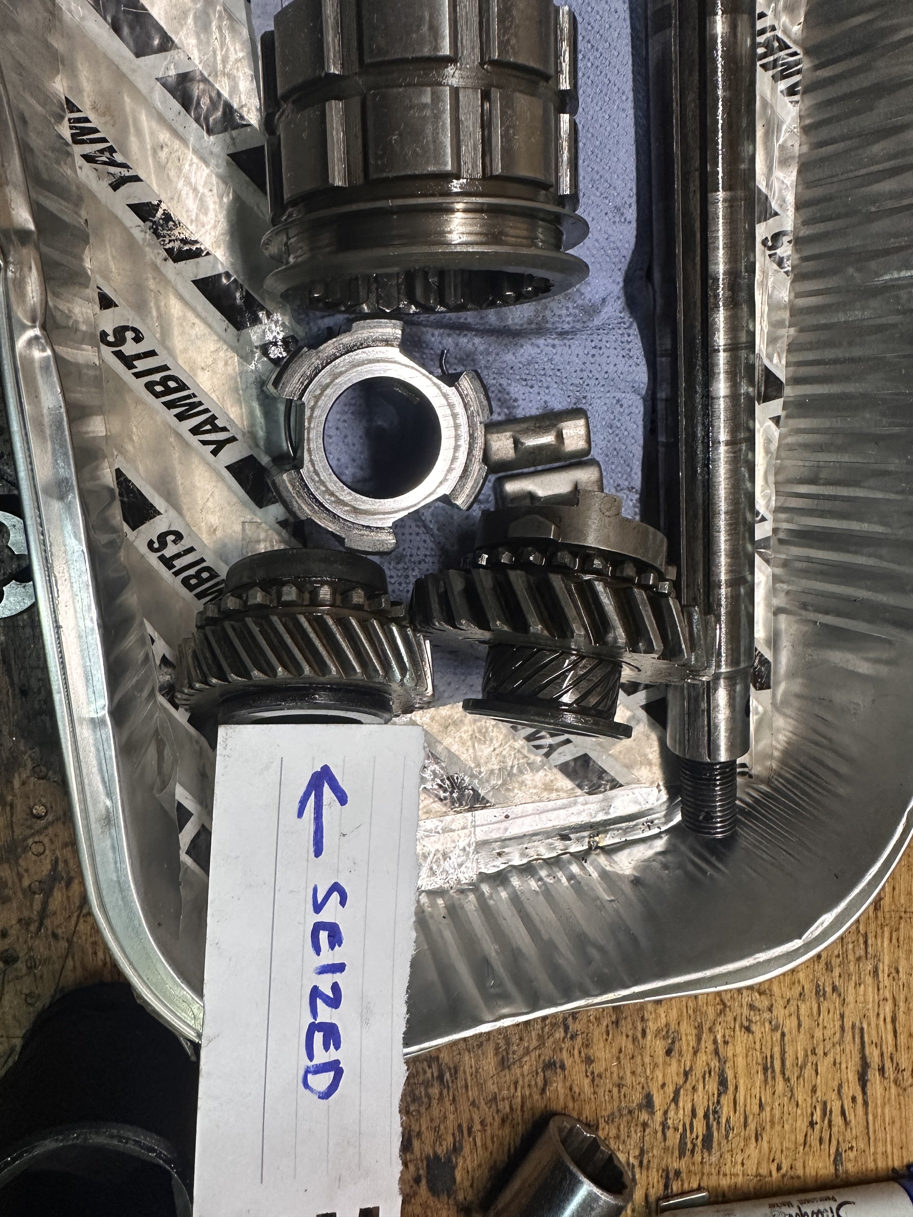

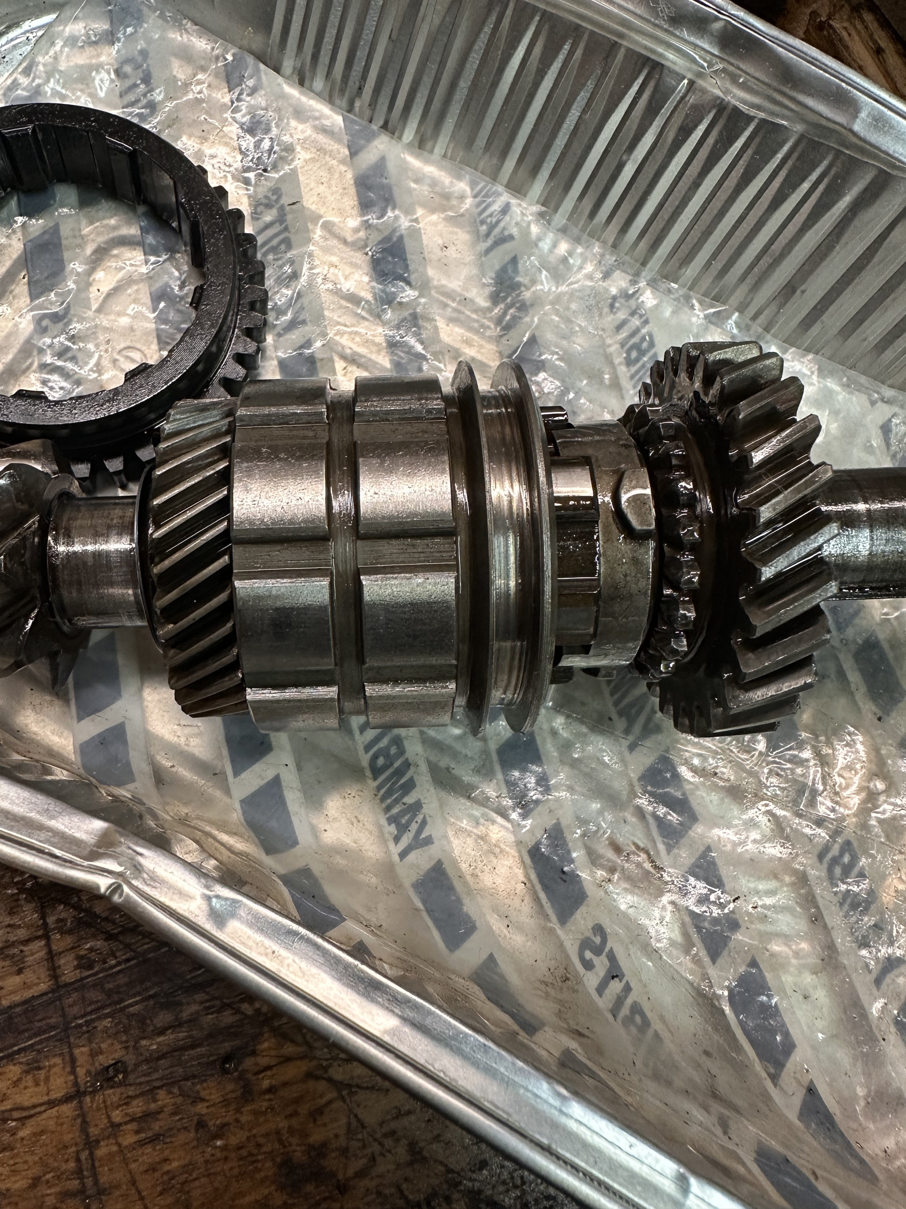

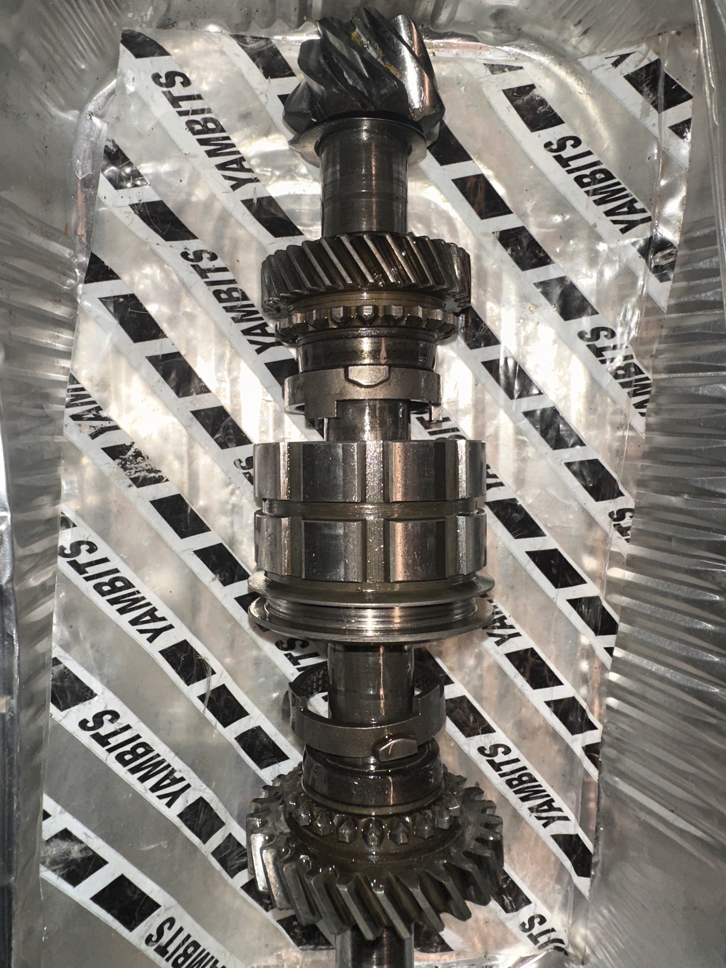

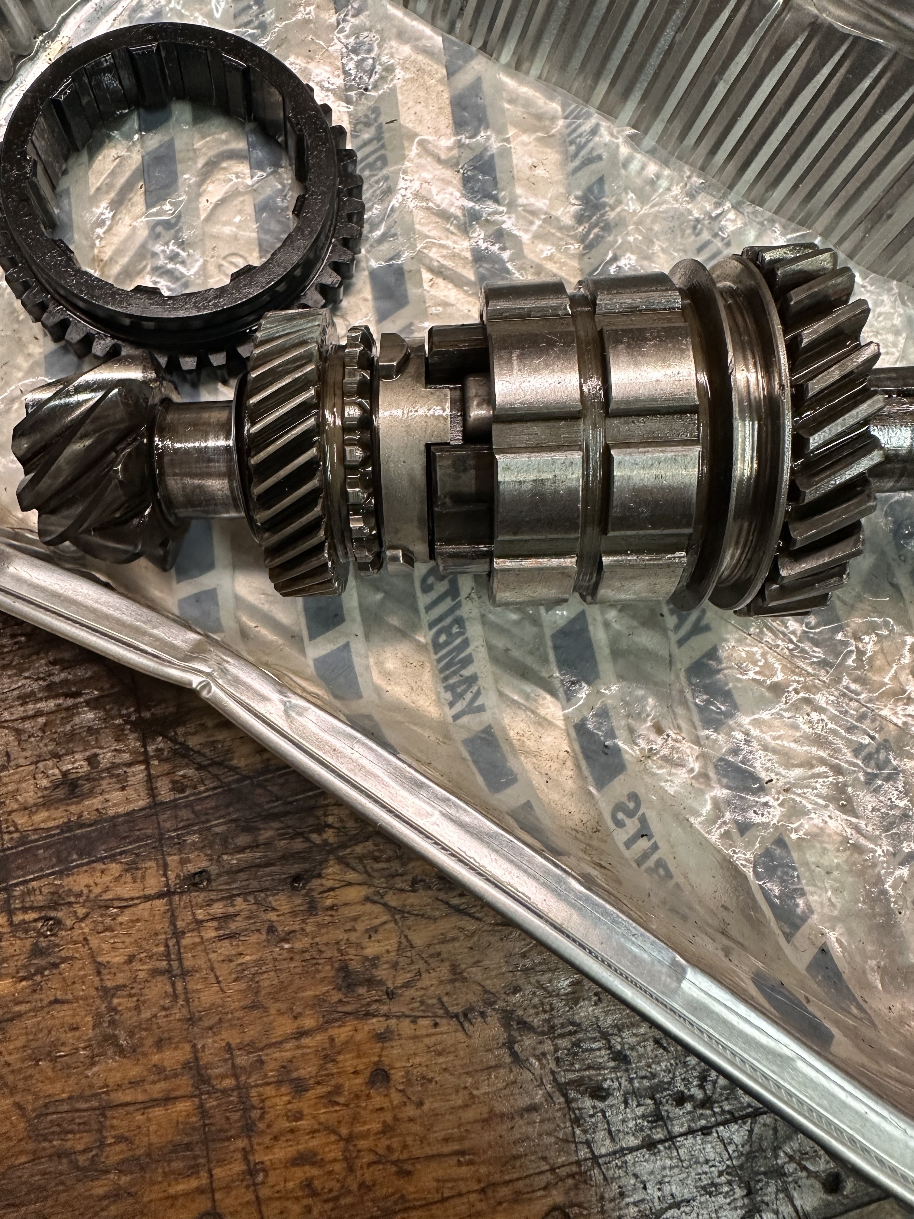

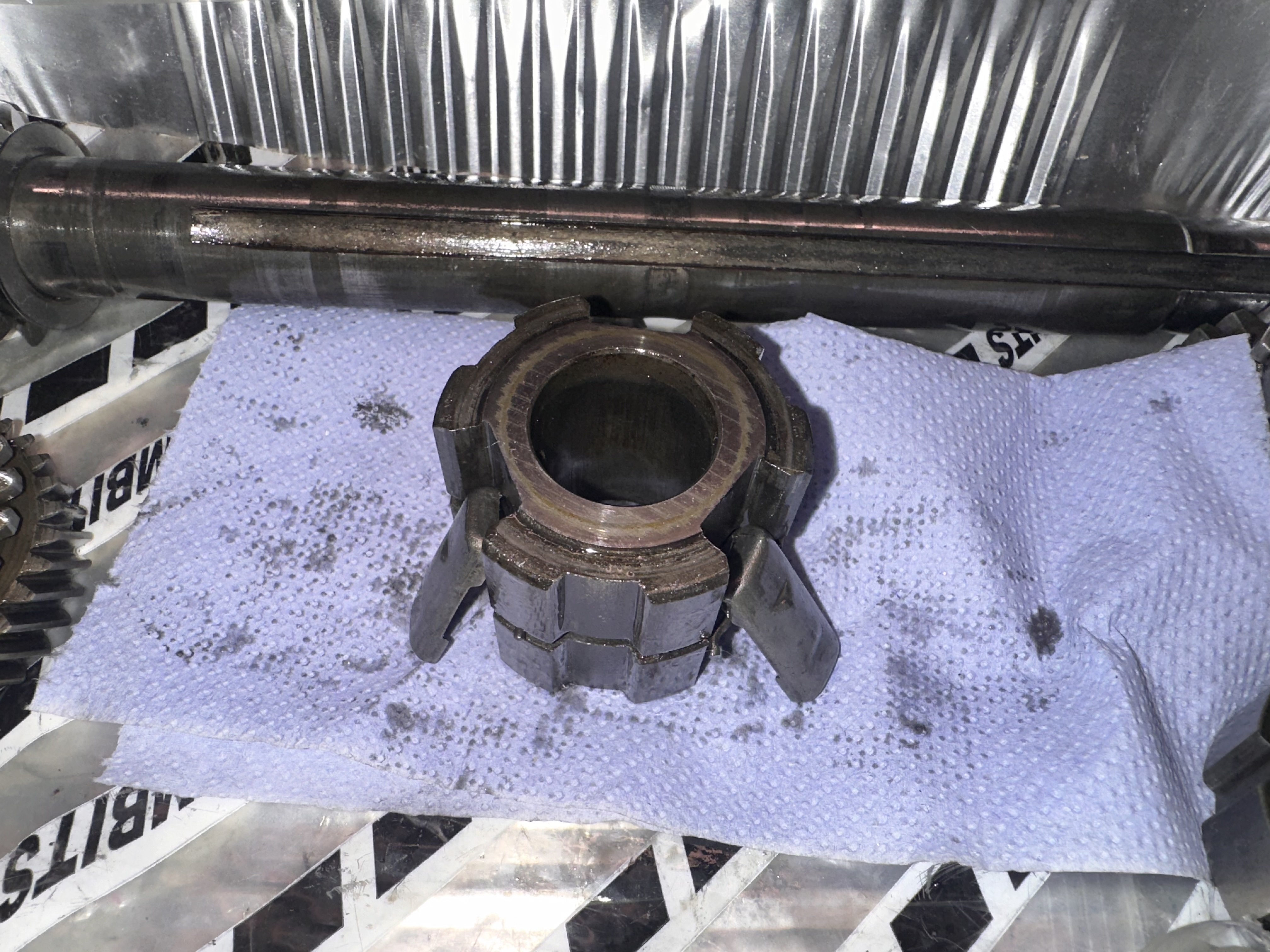

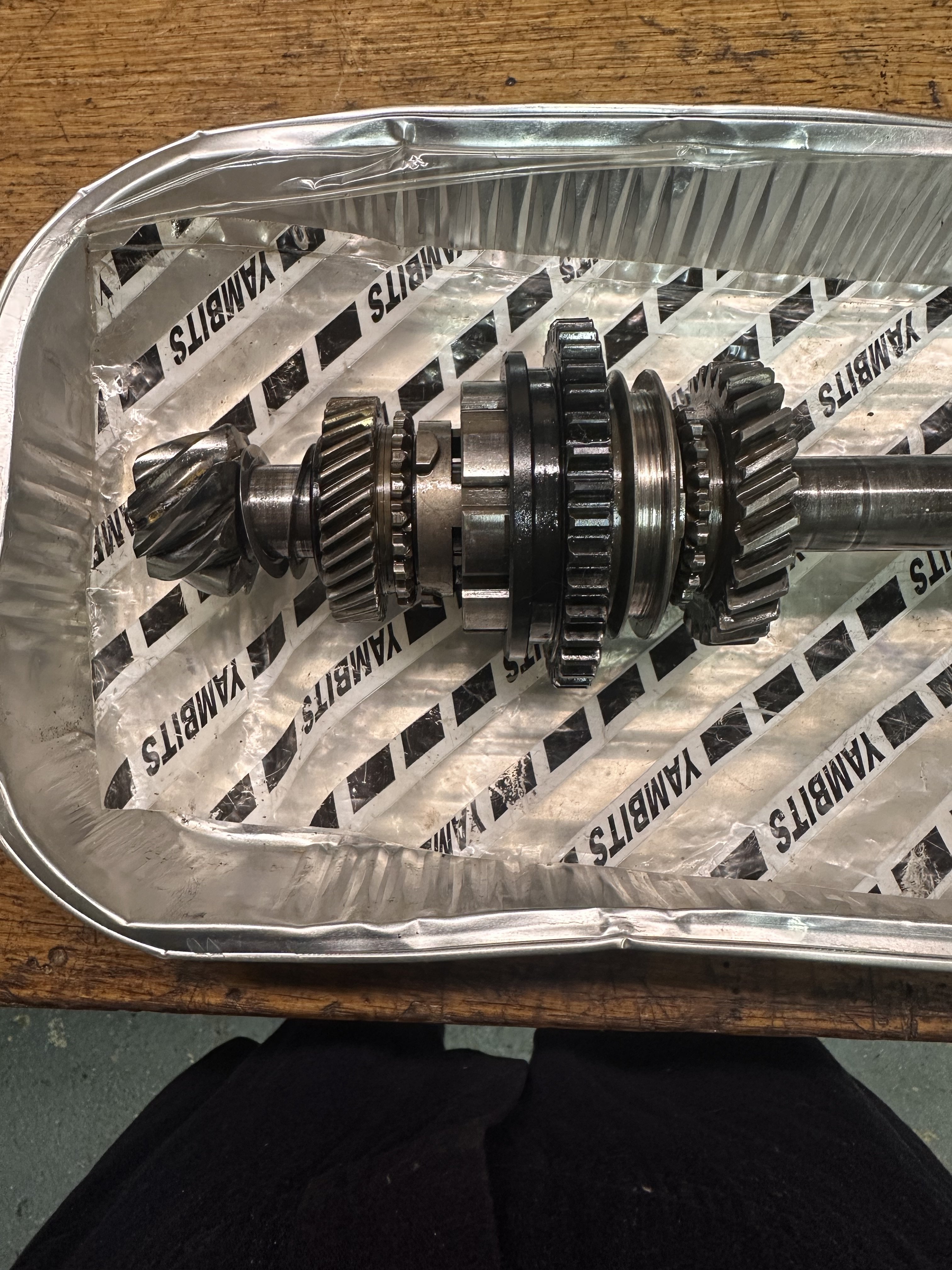

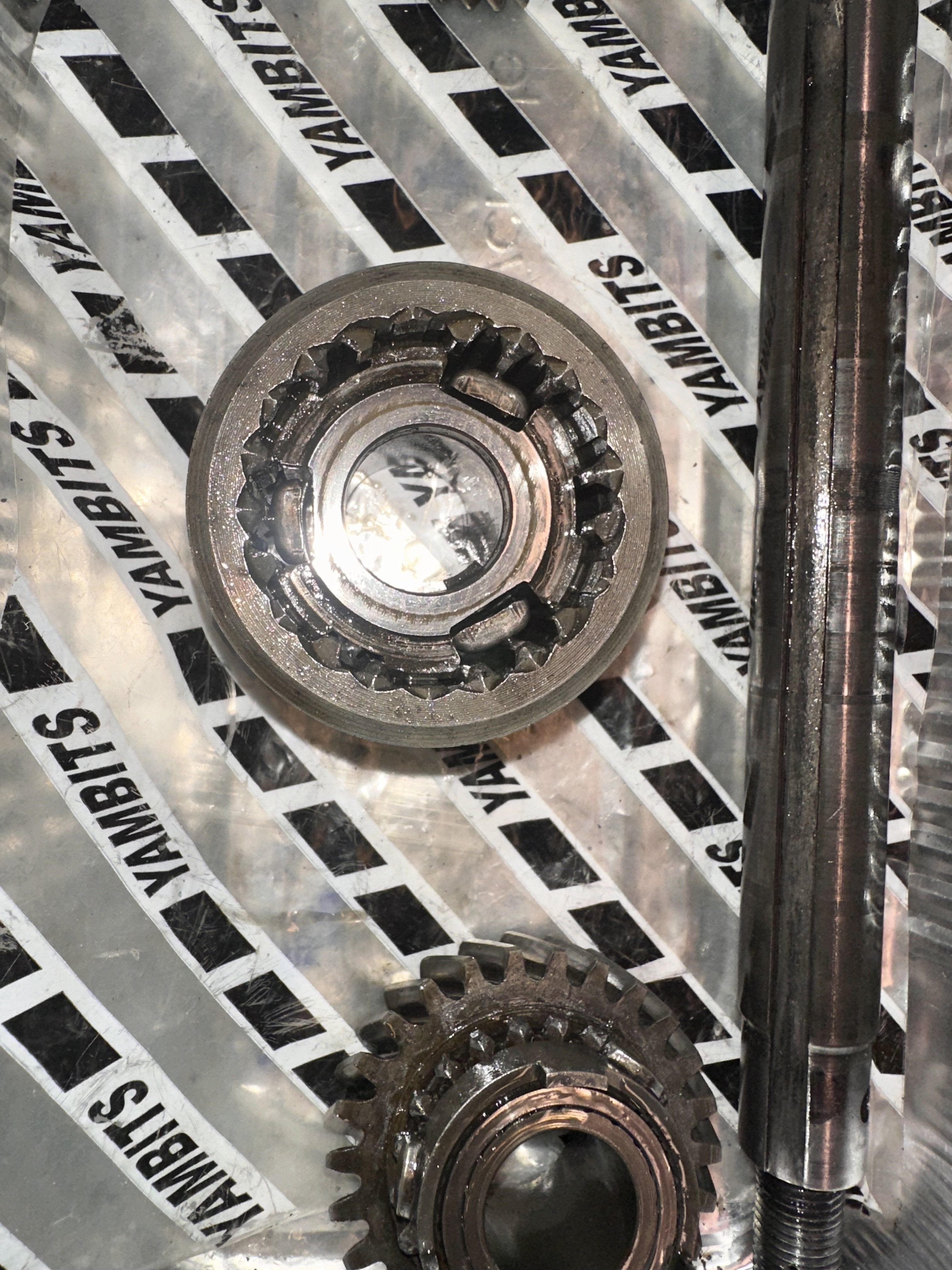

So here are the pinion shaft assemblies. With that sleeve in the middle, I’ve got the 3 sliders over the circular spring as per discussions on previous post because I don’t see how it can possibly work for the clip on the outside - but happy to be proved wrong!
Do you see anything else which could be wrong?

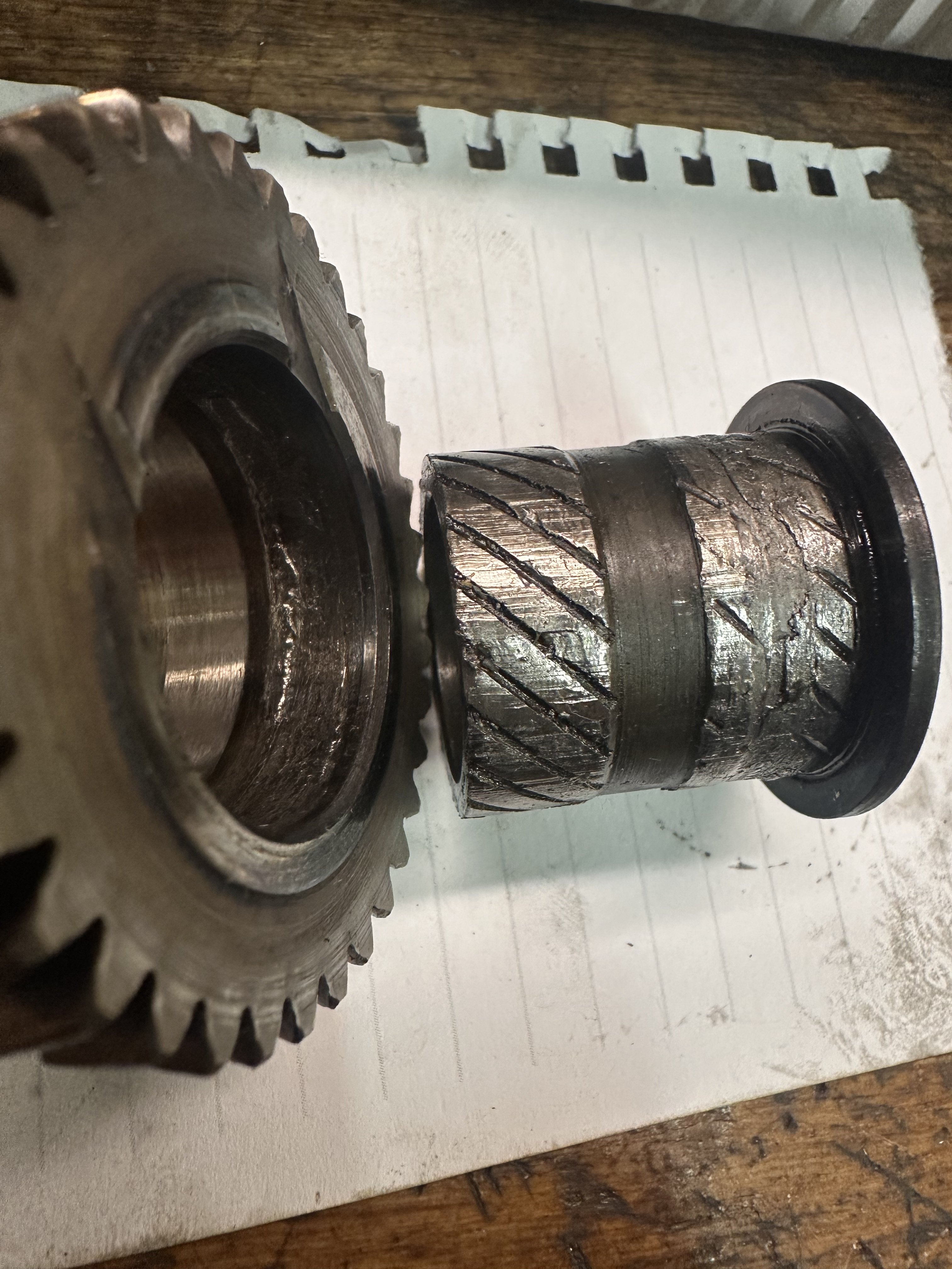

Other than that a discovery made as shown in the last pic, I think that the bush on 4th is seized as the one on 3rd gear on the other side moves freely🤔

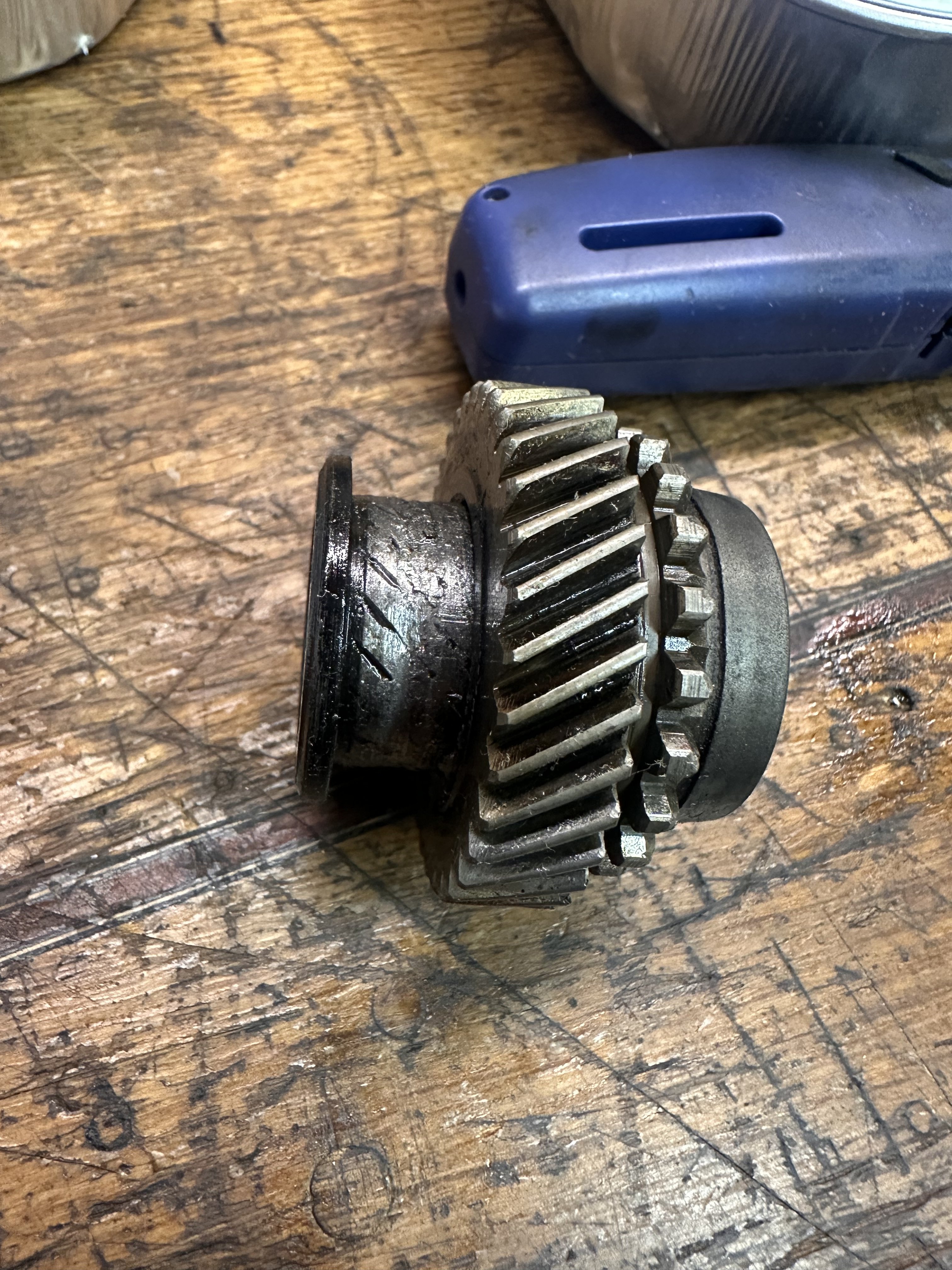

Update - Houston we have a problem! 4th is toast, can’t even get the bush fully out. I guess this is the cause of the lockup. The inside surface feels completely smooth, I suppose the bush is sacrificial? But whether it’s been heat damaged and tempered the gear unit I don’t know but at the moment although I can’t get it fully out yet, it looks okay??
Update 2 - 4th gear has molten bush material fused on it, see last pic 😳
I wonder if the failed pinion bearing caused a skew on the shaft and the movement was most pronounced on these first adjacent components?

Yes …. x4! I’m 99% sure the pinion bearing was knackered before the hill climb event. Thinking back, the transmission was noisy for God knows how long but I just didn’t take any notice as I just couldn’t remember if it was always like that or it only happened in the last year. But I really am the most unobservant (including listening) person around, ask the missus 😁
Like your first thought I think there was a chain reaction, that pinion bearing was so shot it allowed the shaft to be out of alignment by say a couple of degrees. The 4th gear and bush were then trying to do the job of keeping the shaft aligned and is certainly not up to the job of a roller bearing, so overheated and seized.
