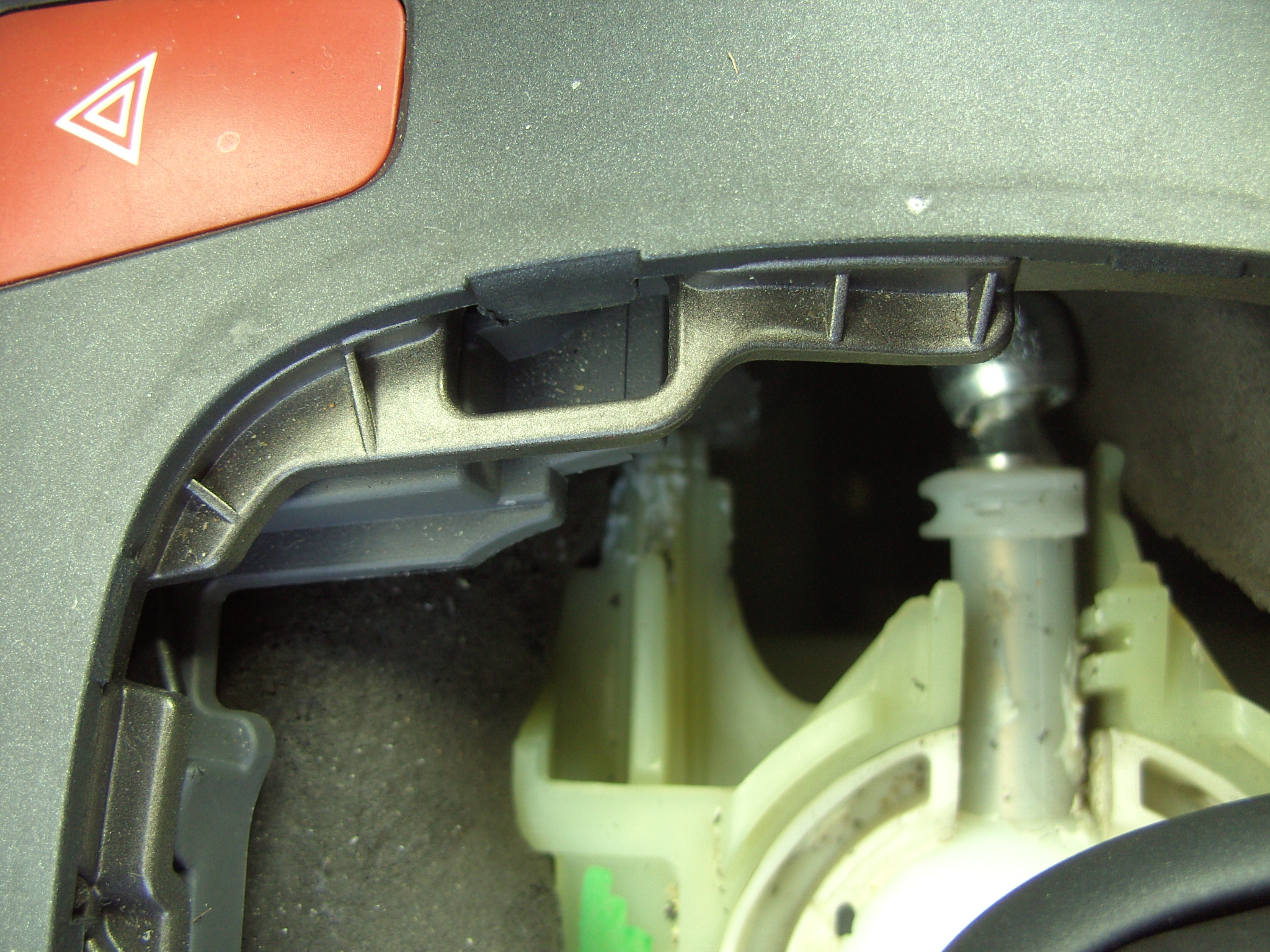

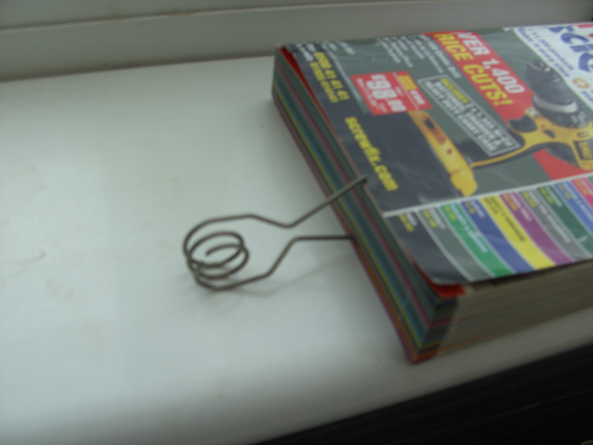

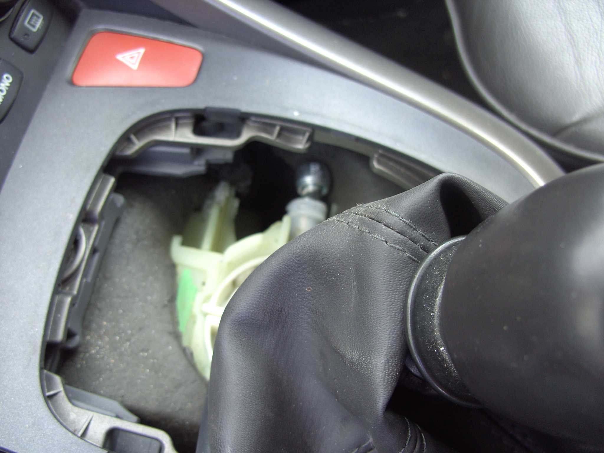

Thank you Doofer here are the photos of the spring and where it lives. The dealer showed me the gear stick mount on fiat eper and there isn't even a view of the right side of the gear stick mount, only the coil spring that pulls the reverse sleeve down was available.
The centering spring is held in position by a plastic washer and a star washer it would be an easy fix with a new item. Looks like I will have to stump up £100 for the thing.

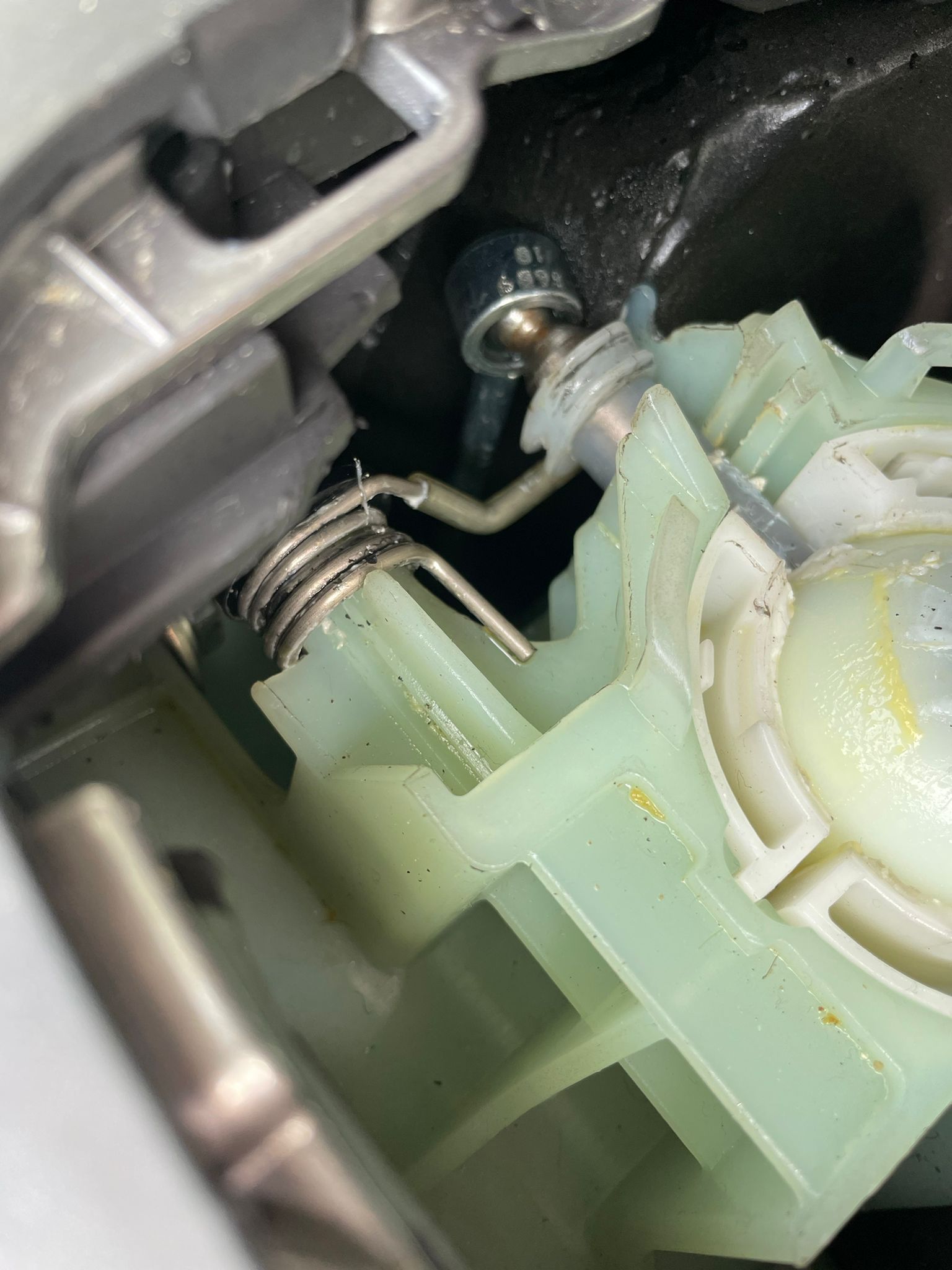

I have the same problem with my 2008 Croma: the 2-armed spring of the gear lever is broken. Actually, only one of the arms has disappeared, the other arm is still there and working. The result: the gear stick does not center in the lower gears, but centering works fine in higher gears.
Here's a photo of what it looks like. My car dealer says the entire gear unit needs to be replaced, which is quite expensive (€ 200 +) and involves disassembly of half the dashboard. What if I would just remove the spring and replace it by a spring of a used gear unit? Is it possible to remove the spring retainer and the spring by myself? Any advice is very much appreciated :)
