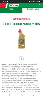

This could be the right one at least that's what Castrol reckons for our car

I used this in my tipo
It's a 75-80w so not 100% right but within the original range and compatible with both gl4 and gl5
Thanks for the replies.. it confirmed I'm not missing something obvious... 😅
I found some of the text-book correct Petronas/Tutela Trans Technyx 75W85 albeit at £16 a litre delivered, which is twice as expensive as the non text-book options... but there's only 1.6 litres in there and I won't have to change it again for about 5 years (cue a driveshaft etc. will fail now.. 😨 ) so not a complete disaster.
