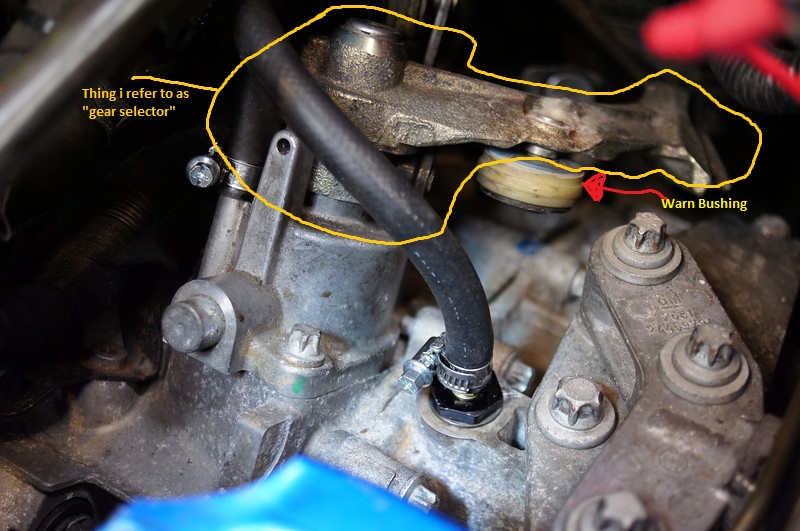

Had a mate shifting gears with the engine switched off and i was watching the gear box where the selector(on the gearbox) is actually moved by the cables.
I saw there is a lot of play in the plastic bushings especially in bushing 2 on picture - that would account for sloppy shifting and grinding feel.
It would seem the bushing only comes with the cables at abut 85 euro. Seems strange, because the M32 is used on multiple GM vehicles, but did not find only the busing on it's own yet. Searching for alternatives.
The selector itself has some kind of bushing on the piece that goes in the gearbox (not shown in picture ou will se what i mean if you look in ePear); also there is no grease on those parts - this where the "clunk" sound comes from on my Bravo

That bushing is a black plastic bit on mine, and it has a lot of play 3-5 mm
Look for the gear selector bit in ePear an d you will find it has a bushing that goes into the gearbox; also mine was way to clean - no vaseline /grease.

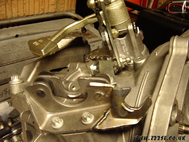

The view of the gearbox you actually get with it in the car (gear selector bit in yellow):
Courtesy of s130:
