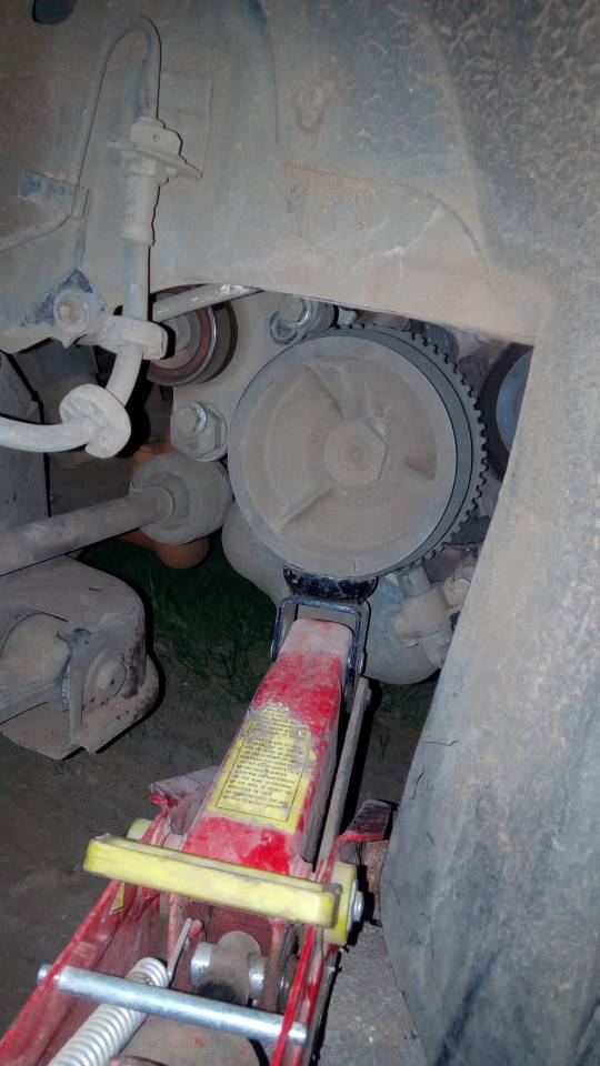

Alternator belt is okay, not snapped as well as the air-con belt it's fine. I got towed home and I started working on it, stripping to check if the Cam belt is okay... Must say it's a lot of work...
After removing all belts... I turned the alternator pulley and the water pump pulley to check of they aren't seized up, they run free... No noises as compared to the noise I heard before it went dead.

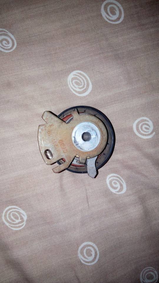

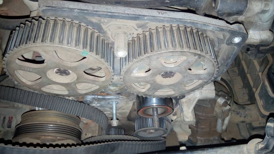

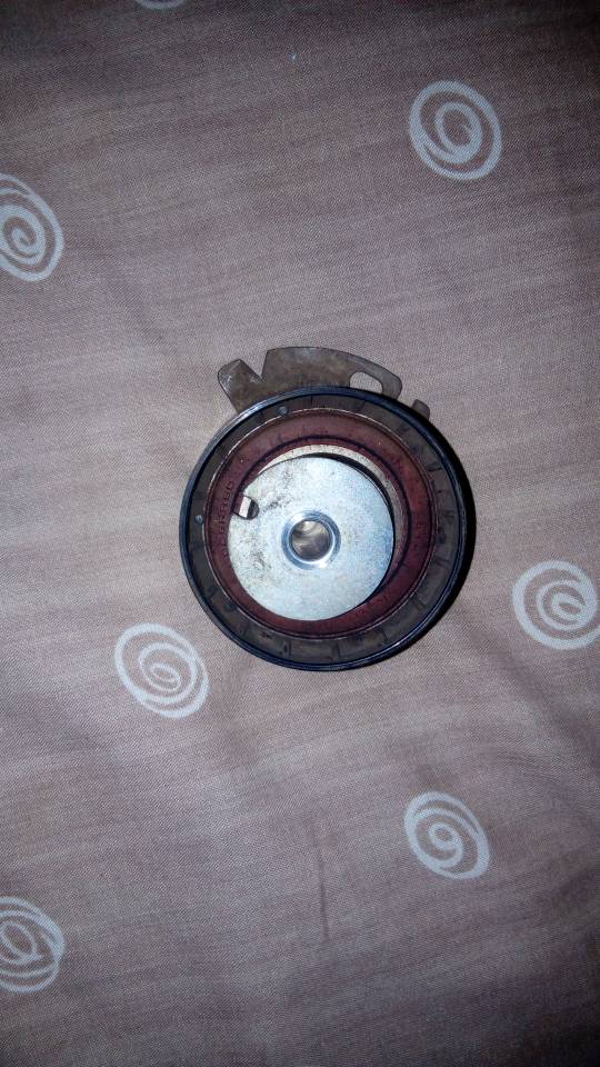

The tensioner is also running free not seized up... But I could tell after stripping the covers that the belt want under sufficient tension.
One other thing I picked up was the Cam covers they weren't fully tight... Upon removal, they were in pieces and the alternator belt had suffered some wear due to the cover and the cover has some damage from the belt.
So with the belt being intact... I don't know if probably my tensioner failed or what... I'll attach some pics

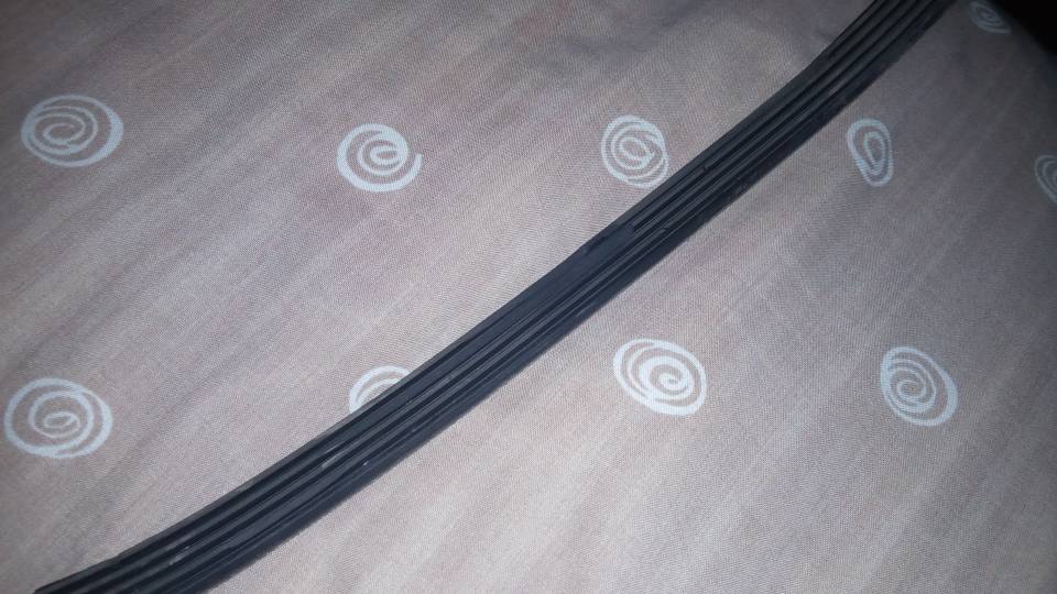

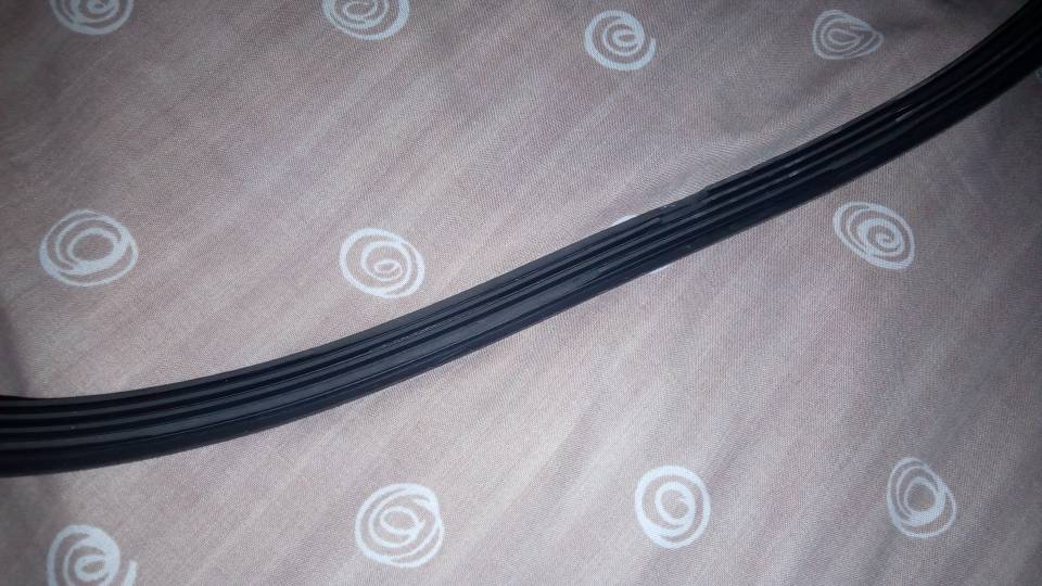

The belt in your pictures is not okay or fine, parts of the ribs are missing from it.
Is this the new belt and tensioner you fitted about 4 weeks ago? The tensioner doesn't look new either.
The alternator belt is new... Yes was fitted a few weeks ago. But the tensioner and Cam belts I never touched since the 3months of owning the car. So this tensioner is the one I just removed last night.
As you can see one of the Cam belt covers has a groove in it... It was made by the alternator belt as it was rotating so thus the alternator belt looks damaged, I'll conclude so...
So what I would like to know is what are the chances of my car having bent valves and how now to set the timing belt again??

Upon proper inspection this morning as last night it was late and I was tired... I just had a look at the tensioner and seems like indeed it is broken.

If the tensioner packed up and allowed the cam-belt to go slack, then there is a high chance that the cam-belt slipped, causing damage to the valves.
It's promising that the engine turns over without making any clonking noises.. but even a slightly bent valve would still need to be replaced. On the other hand, the car could be not starting because the cam timing has been thrown out but otherwise everything in there is still okay.
I would remove the cams (to allow the valves to close) and then run a compression test to see what each cylinder reads. If you have a cylinder with more or less zero compression, then it's bad news. :(
Don't crank the engine with the cams still in there. You might damage something that is at the moment okay.
If you know a good garage then it'll probably be cheaper to use them than taking it to a Fiat dealer. All of the above doesn't need any specialist Fiat knowledge. Taking cams out and performing a compression test is fairly routine stuff.
Also: Don't mix up the cams or the camshaft bearing caps. I would paint numbers on them in position before you remove them, so you know which one goes where.. and which way round they were fitted.
