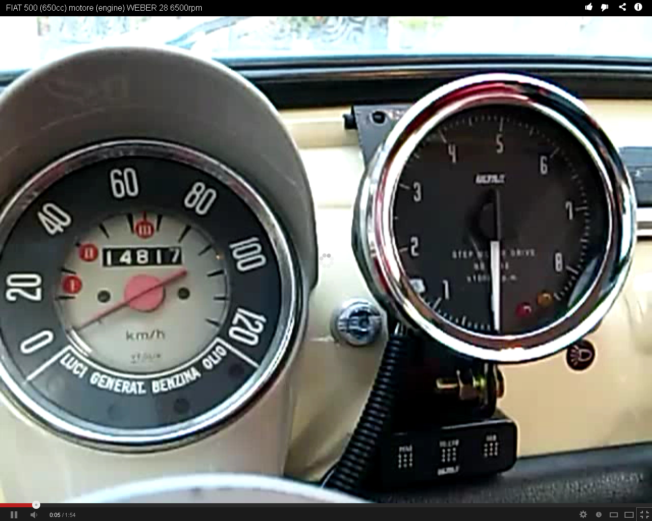

A tacho would be nice as well and I've seen a harness to fit one without altering much else. It looks a bit funny but once again preserves the original dash.

Chris, I really like your tach. Is it from Axel Gerstl?
Yes - I bought it prior to getting the other instruments. If I had my time again, I'd go with the black surround.
