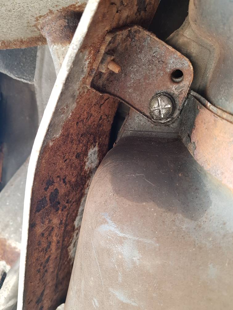

Does anybody else with a late model Panda (mine is a 94 Colour) have one of these fastenings on the strap attached to the heat shield?
All my screwdrivers / screwdriver bits are too small. Any ideas for undoing it?

Is this a standard fitting? Any ideas?
Thank you. I thought it didn't look standard. It's annoying because it held me up. And I couldn't find the Dremel. Turned out my son had borrowed it and I had forgotten. I will get back on it soon. Thank you.
Had another go at this today. Apparently it is a roofing bolt that has been put in there by somebody in the past! The head is quite soft so it is churning up very easily which doesn't help.
I can't get an angle on it to punch it round, or grind flats on to it beacuse it is sunk between the fuel tank and the heat shield . I think I will have to see if I can get the heat shield out of the way so I can come at it from the side.

But finally today I got back under the Panda and in the end had to drill it out. It was indeed a roofing bolt. Also I discovered the remains of what were probably the original tank straps underneath the more recent rusty tank straps!
