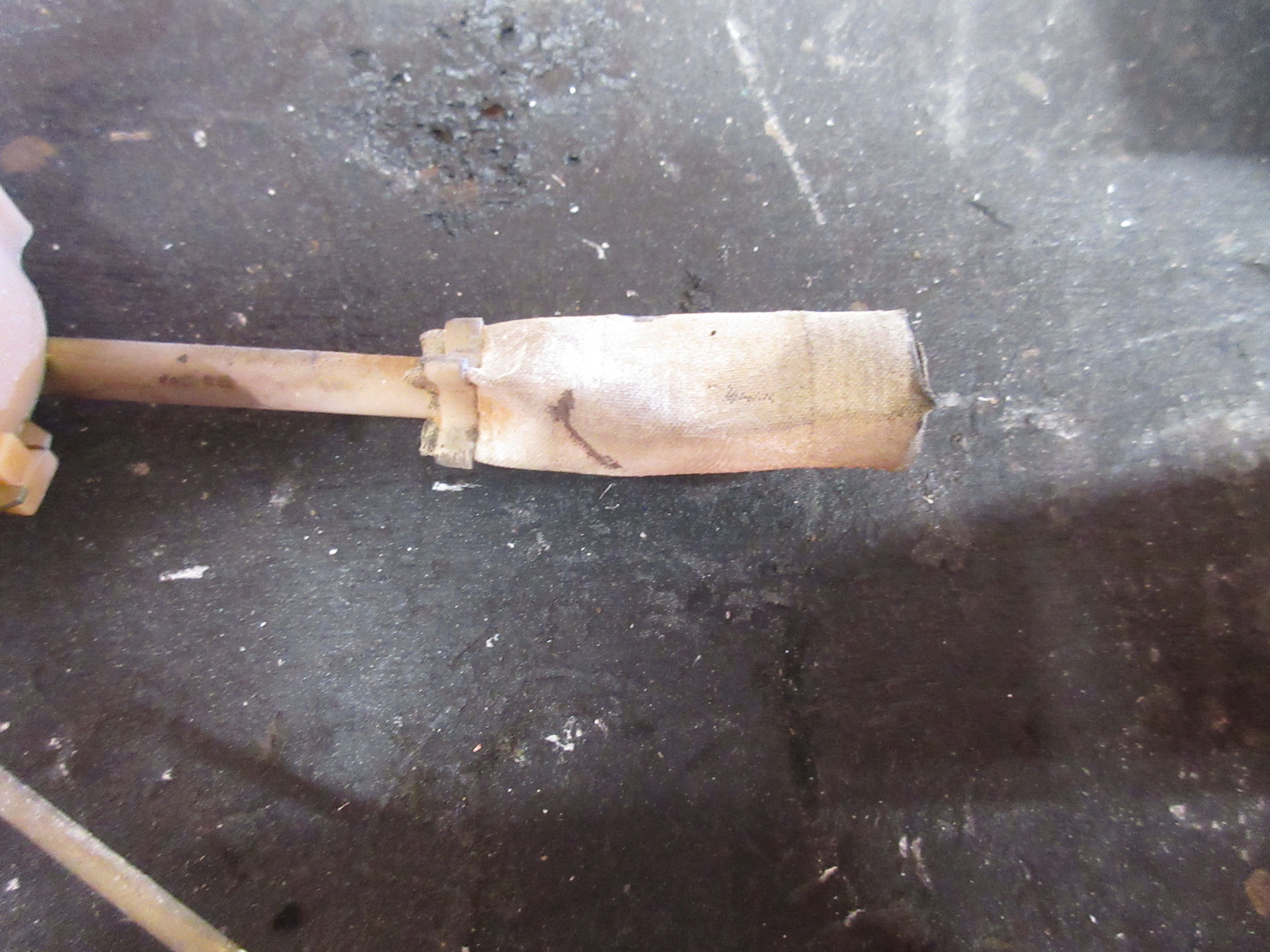

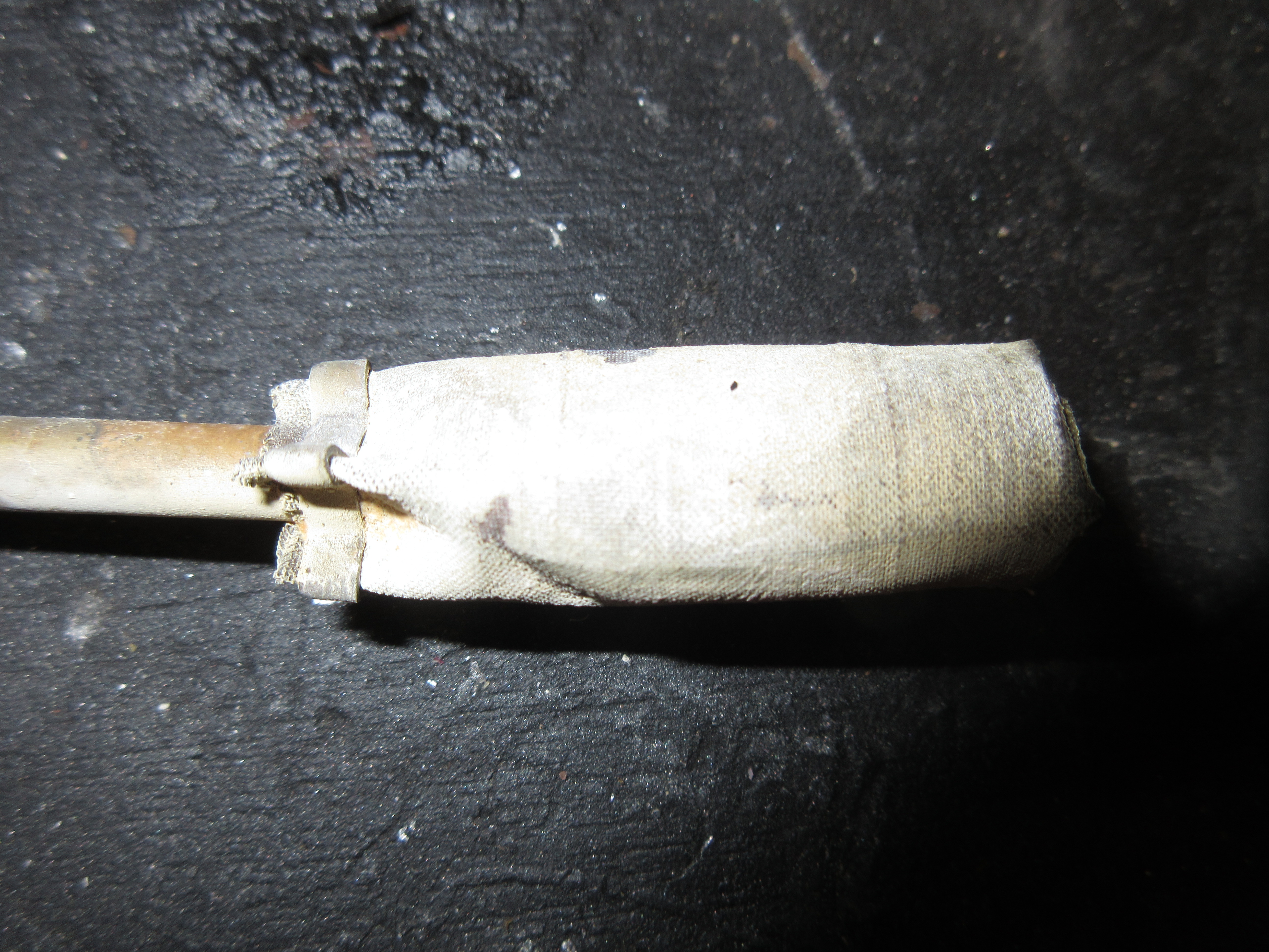

Whilst plumbing my new pump and filter I removed the sender unit.
The outlet has a filter on the end and mine was completely clogged up.
I blew it out with compressed air and took a closer look.
It is a brass contruction and fell apart when I touched it.
I removed it as I am running a Malapassi filter regulator after the pump - and a micro-fine filter before the carb.
This will effect fuel availability......
