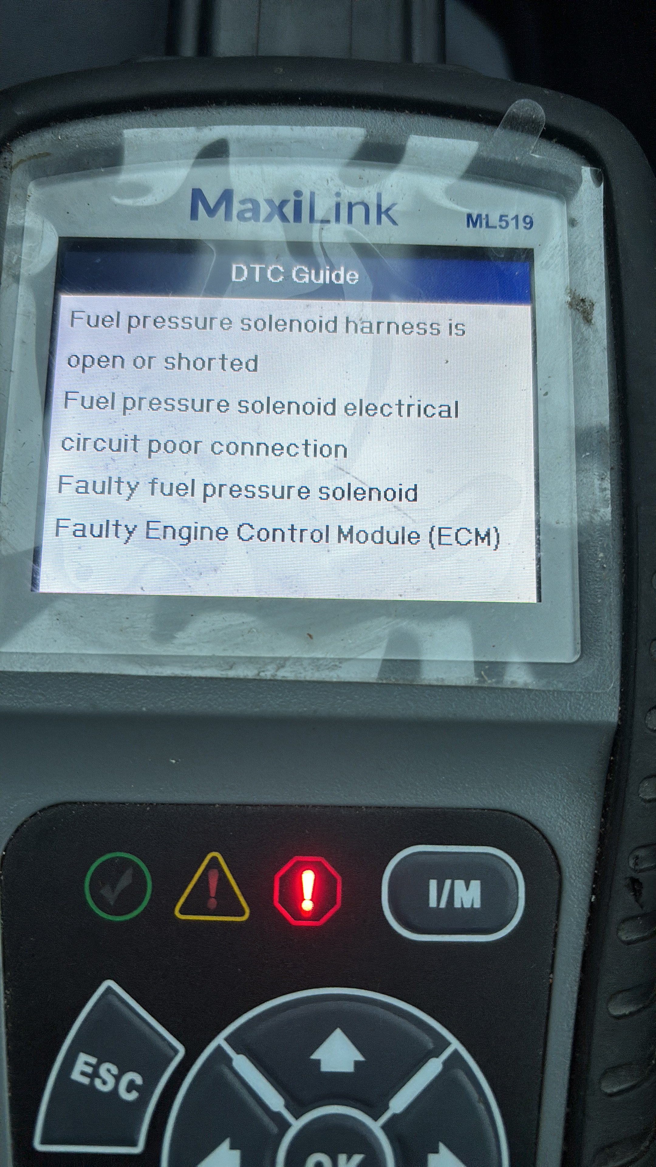

Hello again and thank you for the response, I thought I would get a message to tell me someone had responded. So apologies.
I have replaced the solenoid. With albeit a cheap one. The original Bosch one looks good, but one of the 2 orings was missing.
I will test it as best I can.
Problem persists.
In fact the problem is now more stark. Vehicle over fuels with black smoke and cuts out. But I have to say the engine and performance was excellent when running right!
The fault comes up immediately now but only after extended driving before.
Is it worth changing the sensor on the rhs side of the rail? At least it's relatively accessible.
Hello. Files are uploading
