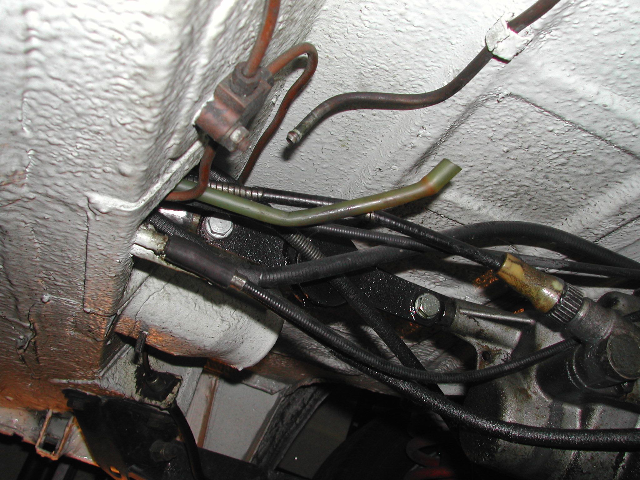

To be specific about your questions, you need to remove the rubber mat or carpet over the tunnel, take off the black metal 'heater' trunking at the front and the flat black access panel at the rear of the tunnel. I have incuded a photo showing the connection of the hose to the rigid pipe from under the car.

You can see the fuel line exiting the tunnel, curving up to join the rigid line that is a coppery colour. This photo does not show a hose clamp that was added later.

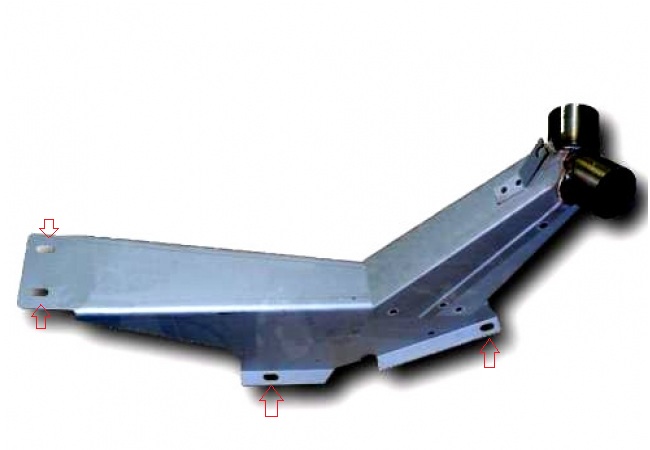

I just did this couple week ago. Easy job. You have to remove the center mat at least at the front end of the tunnel. The front end of the tunnel has to be removed so you need to take of the two heating tubes.
Remove the marked screws and the tunnel is free. There are 2 screws on each side of the tunnel, in the pic you can only see one side :). You need to also remove the hatch at the rear of the tunnel, 4 screws. No you can pull out the fuel line just be sure you have drained the line. And check the old routing carefully that it wont be scratched by anything.

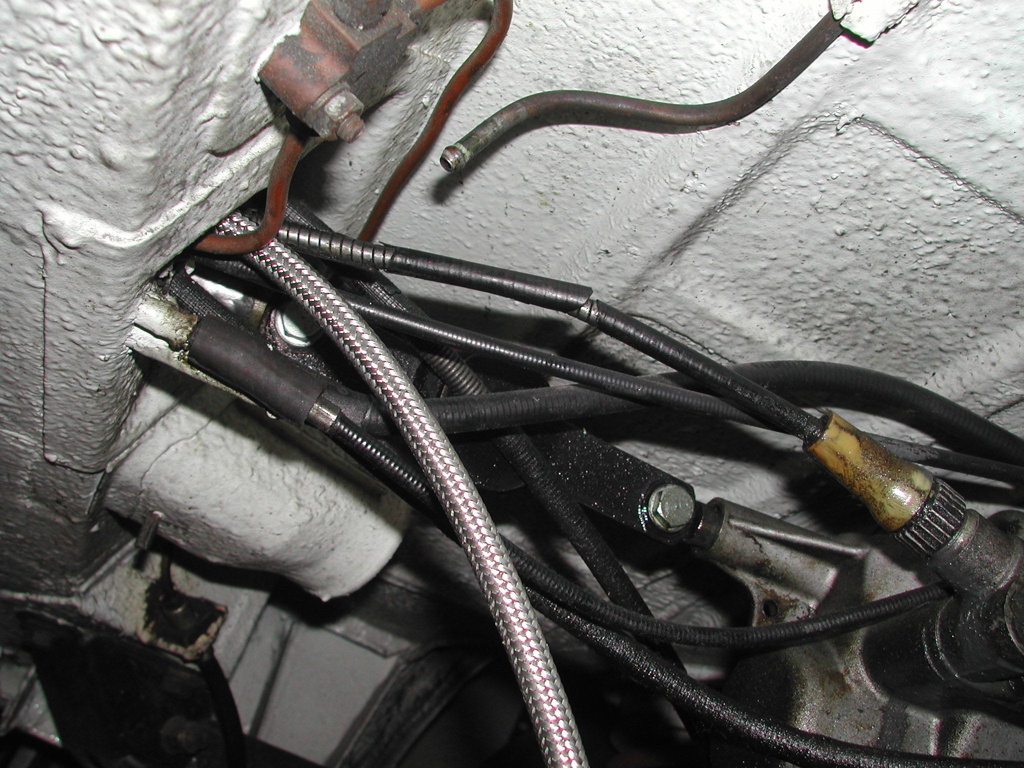

Hi jake, I hate to contradict anyone on here, but I have in the past replaced my old fuel pipe with braided steel piping by tying the new to the old with string and gently easing it down the tunnel. It's a bit of a faff but can be done (y)(y)(y) see before and after pics.
Ian.
Ian.
Ian, I replaced all the bits in the tunnel at the time when the bodyshell was on its side, so I had a good view of everything without straining my neck. It's not quite as straaightforward in there as the big space might lead you to think. Braided pipe would be a good defence to all the competing cables, but simply pulling the pipe through is risking that you are either impeding another function or putting a strain on or damaging the pipe itself or one of the cables.
A while ago I needed a bit more "give" in the heavy starter cable when I fitted the 650 engine. So I pulled through a bit of slack created at the front end of the car. A few weeks later I tracked down the cause of a sticky throttle pedal to the cable putting pressure on the throttle cable. It only took a few minutes to unravel the mystery by removing the heater-flap inspection cover, but things could have got very serious if the battery cable insulation had got severed.:eek:
Petrol, electricity and sharp edges do not make good bedfellows.
