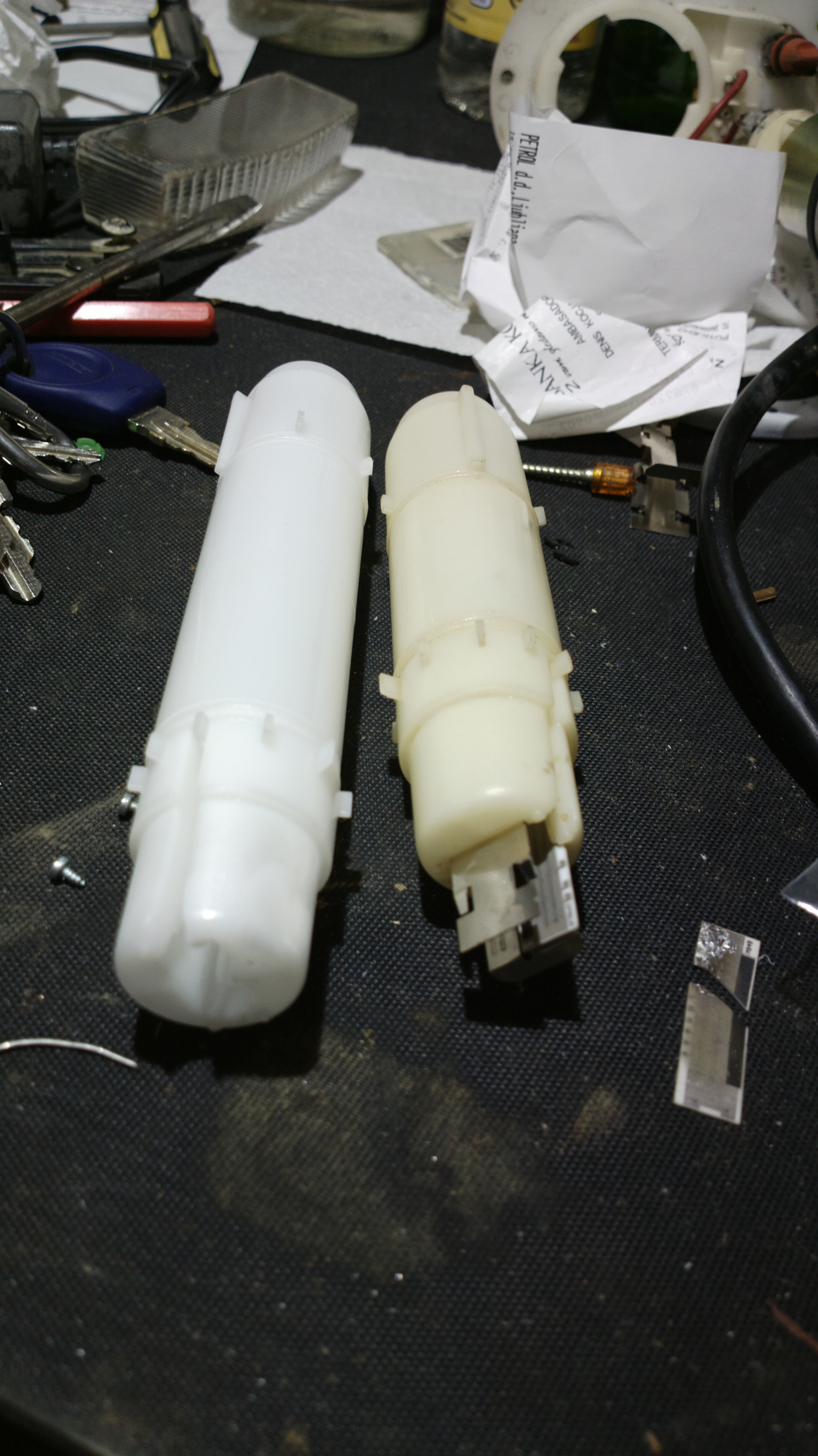

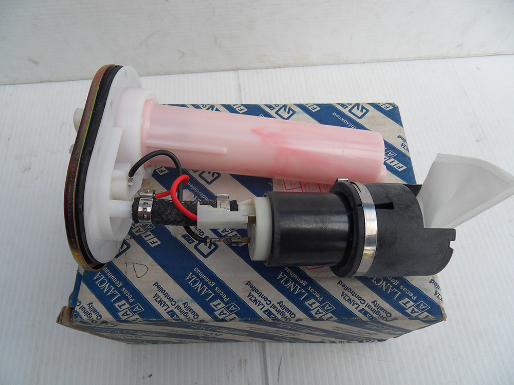

Pump looks like this, pink part being fuel level meter, with float and variable resistor plate.

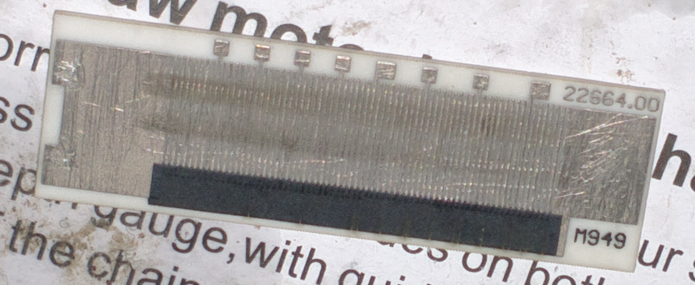

Second pic is removed resistor plate, which I think is faulty, as it does give rising resistor values up to one point, and then it seems to cut connection.
When manually sliding connected float over plate, I never get any reading on the gauge.

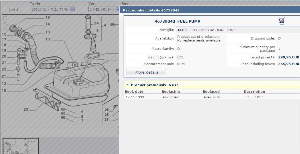

Well, this pumps are extra expensive, not deliverable by fiat, only on backorder with aftermarket stuff, with mismatching part numbers, while some do sell float part only, but there is also a mismatch between models, like panda's, uno's, punto's, Y10's...
Third pic is FIATs answer to my inquiry.

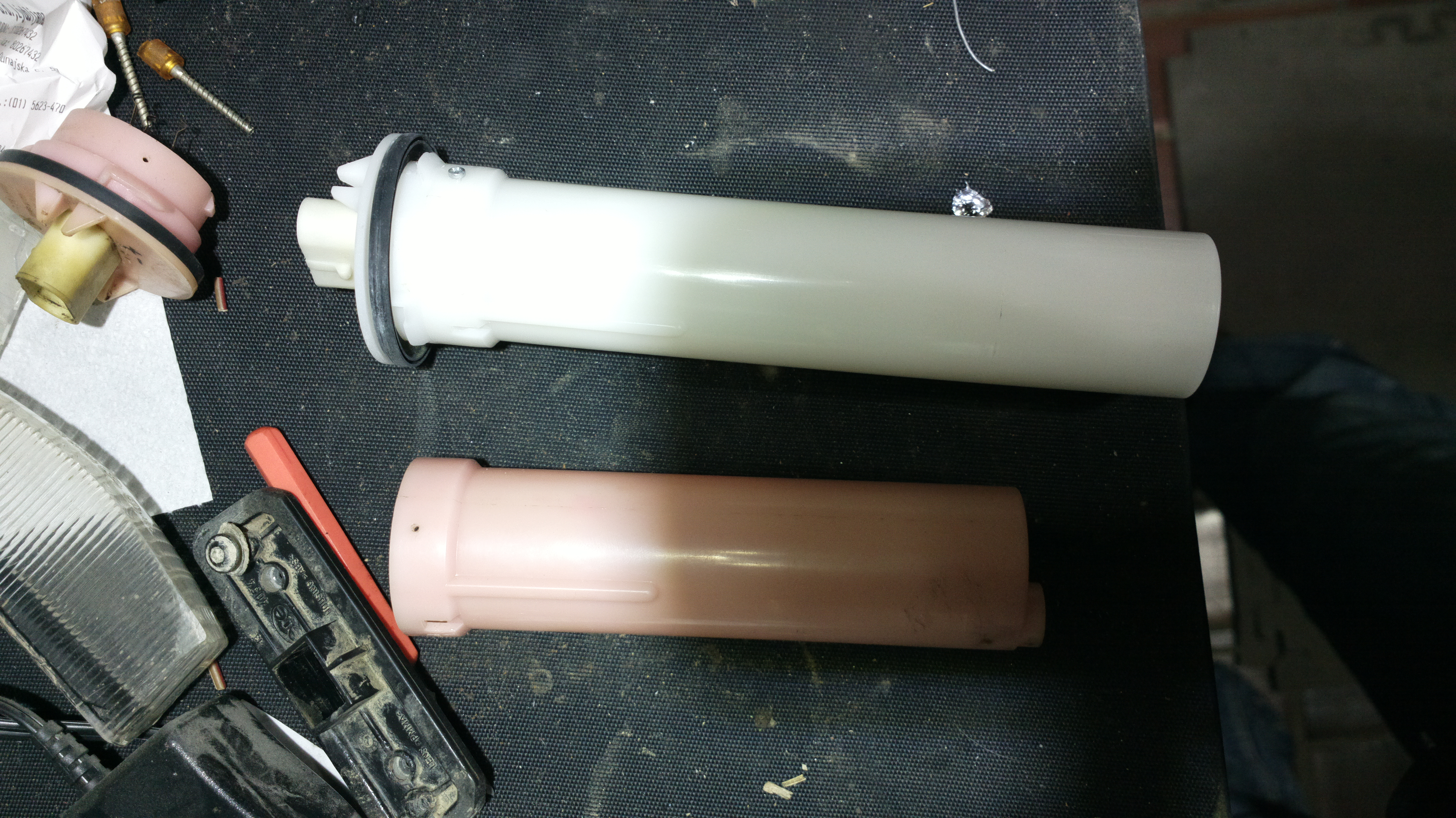

Will wait for the product code 7600544 confirmation to be correct, as exact model, panda 4x4, 1.1, 40kW is not listed, but it is very price conscious compared to ebay.
As suspected, this part doesn't fit at all, length and widthwise.
Luckily, resistance board and its carry plate are the same, well not completely sure on resistor values.
Opened the new donor unit and sourced plate and springs from it, to make old one functional again.

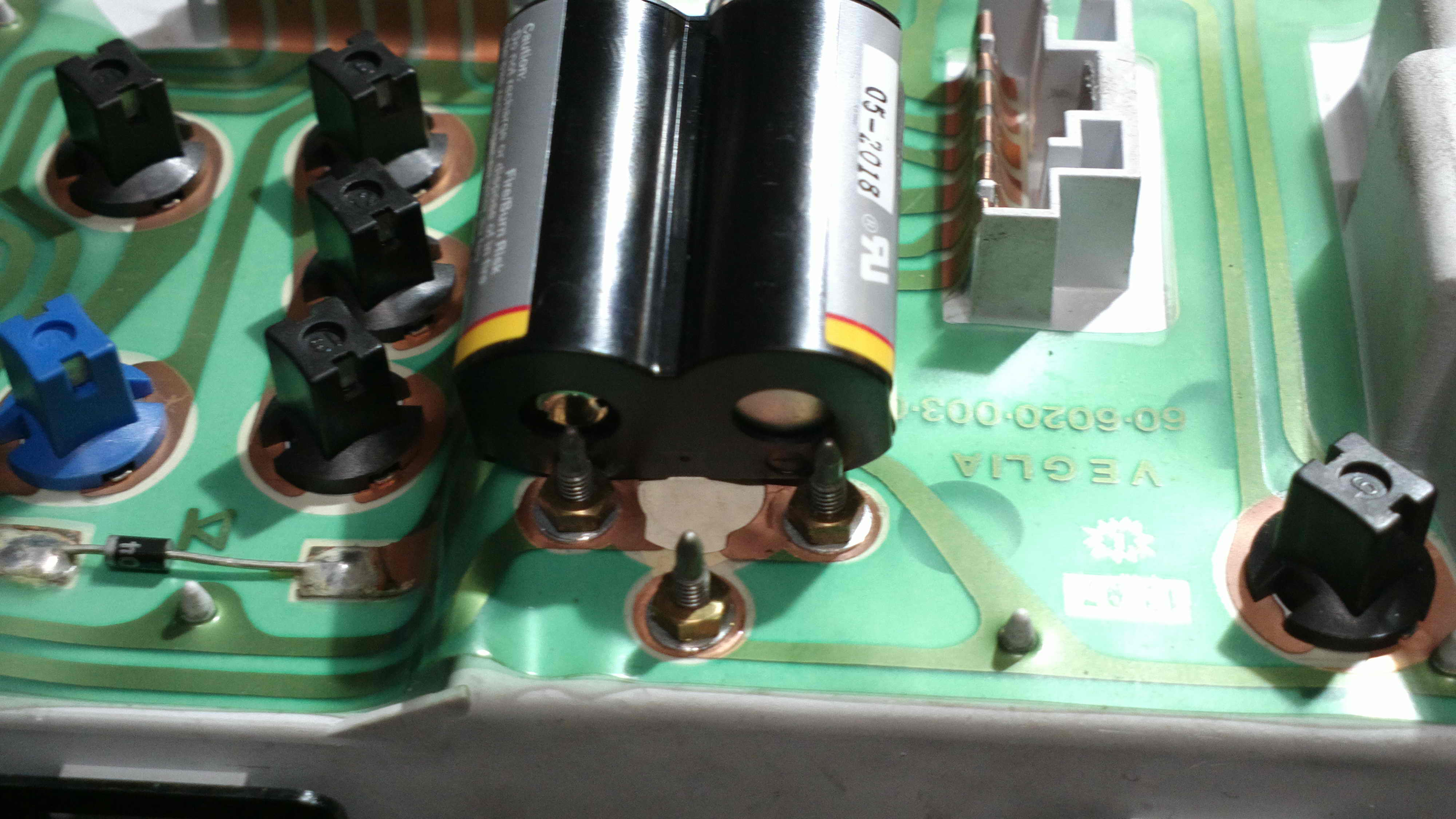

Tested gauge with direct 6V application, and it jumps to full level. (picture 1)
tested gauge with connecting 12V to where it gets current on dash connecting pins, and it also jumps to full.

Took gauge apart, and one of coil's four copper hair thin wires was snapped.
Since gauge has 3 options, as to where to solder it, it was a trial.
It paid off partially, because each of 3 options behaved the same, as in video.
Somehow, earth and "+" seem to be switched, because pointer moves to the left.
If i switch + and - on a bench, (via 6V battery), gauge meter goes to right direction.
