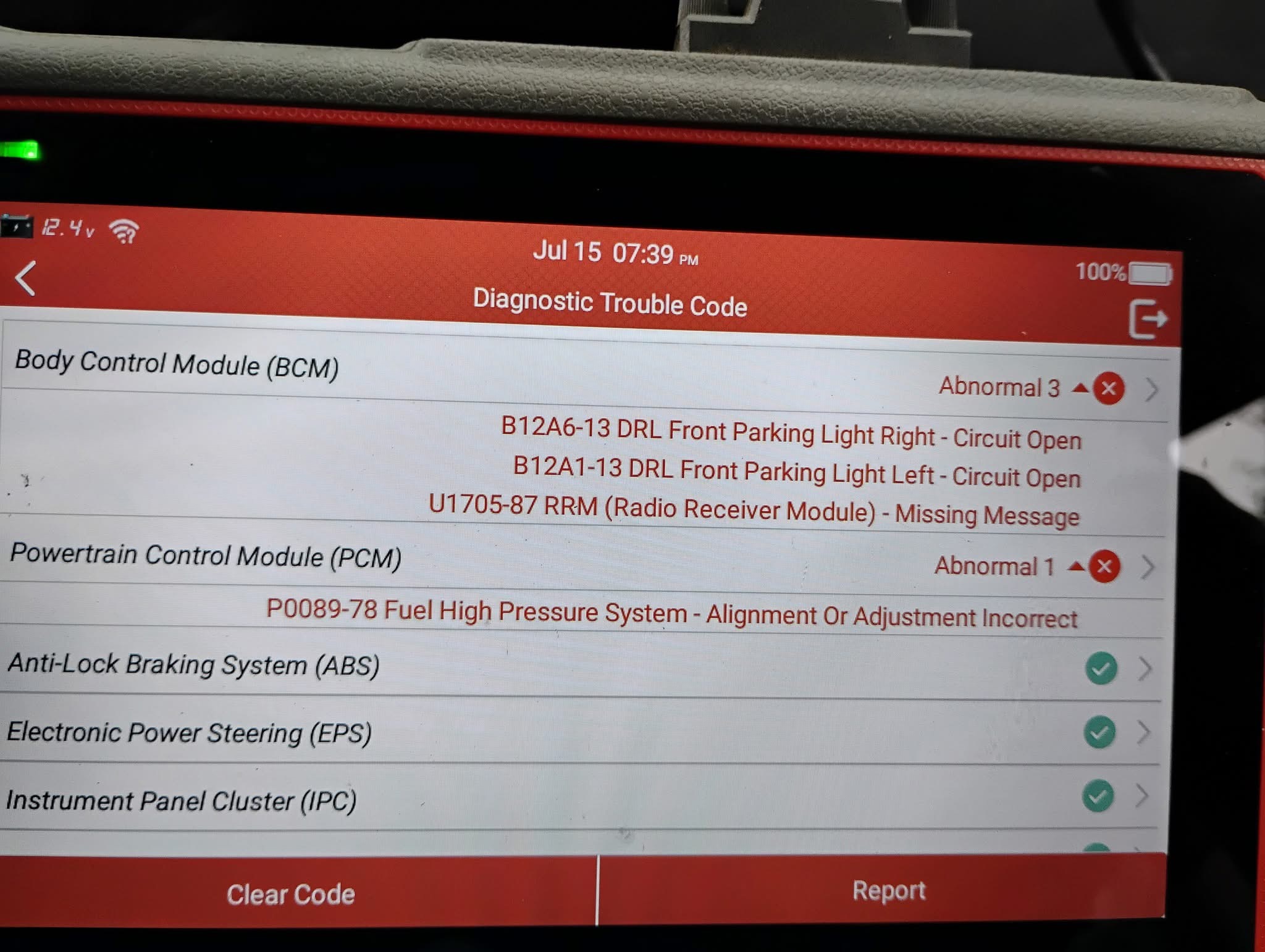

I have 1.3 multi jet diesel and recently it flashed up with fuel pressure issues. Would go into limp mode, then cut out.
I replaced the high pressure fuel sensor, then the regulator and now, a new high pressure fuel pump.
Fuel pressure is spot on, but after a test run, engine lights back on and ‘P0089-70 fuel high pressure system - alignment or adjustment incorrect’ comes up.
Car still goes into limp mode and hasn’t cut out yet.
Any ideas?

Blocked fuel return?
