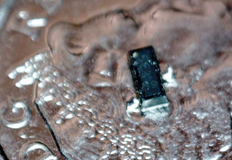

Spare Body Computer arrived so I had a look inside. The bad news is both the analogue to digital converter (ADC) and the CODE memory are in the microprocessor. This is a 164 pin surface mount device and while I have thee correct equipment to replace this device the chance of getting the one from my car off and onto the "new" BC intact are not good so I've ruled that out. At least not for just a faulty fuel gauge. I did try the "new" BC in the car and confirmed that it gave a "Vehicle Protection Sytem" error with a dead car. Just Getting the BC out is a pain as it is held in with shear head security bolts so you have to drill them and use a stud extractor (M5). Investigation shows the circuit was not quite what I expected with a voltage source rather than current with the current resulting from the tank resistance being measured across a 250 ohm (4x1k in parallel to be precise) resistor by the ADC in the microprocessor via a RC low pass filter. I was measuring 12V open circuit on the soures pin before so that ties with the voltage regultor being faulty- high. The resistors all checked out as did the pass transistor. The control transistor cas was cracked when I took it off (microscopic surface mount device) so could not check it. I swapped it with one from the "new" BC. This resulted in a "Full" gauge indication so I've either fixed it or broken it further.

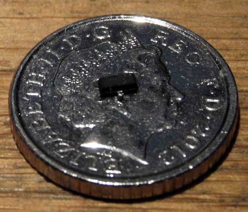

The faulty transistor is tiny (SOT-23) 2.9 x 1.6mm
Shown on 5p piece. It's not easy to replace, even once you have identified which one of the dozens of devices is the faulty one. I robbed the replacement transistor from another Body Computer.
