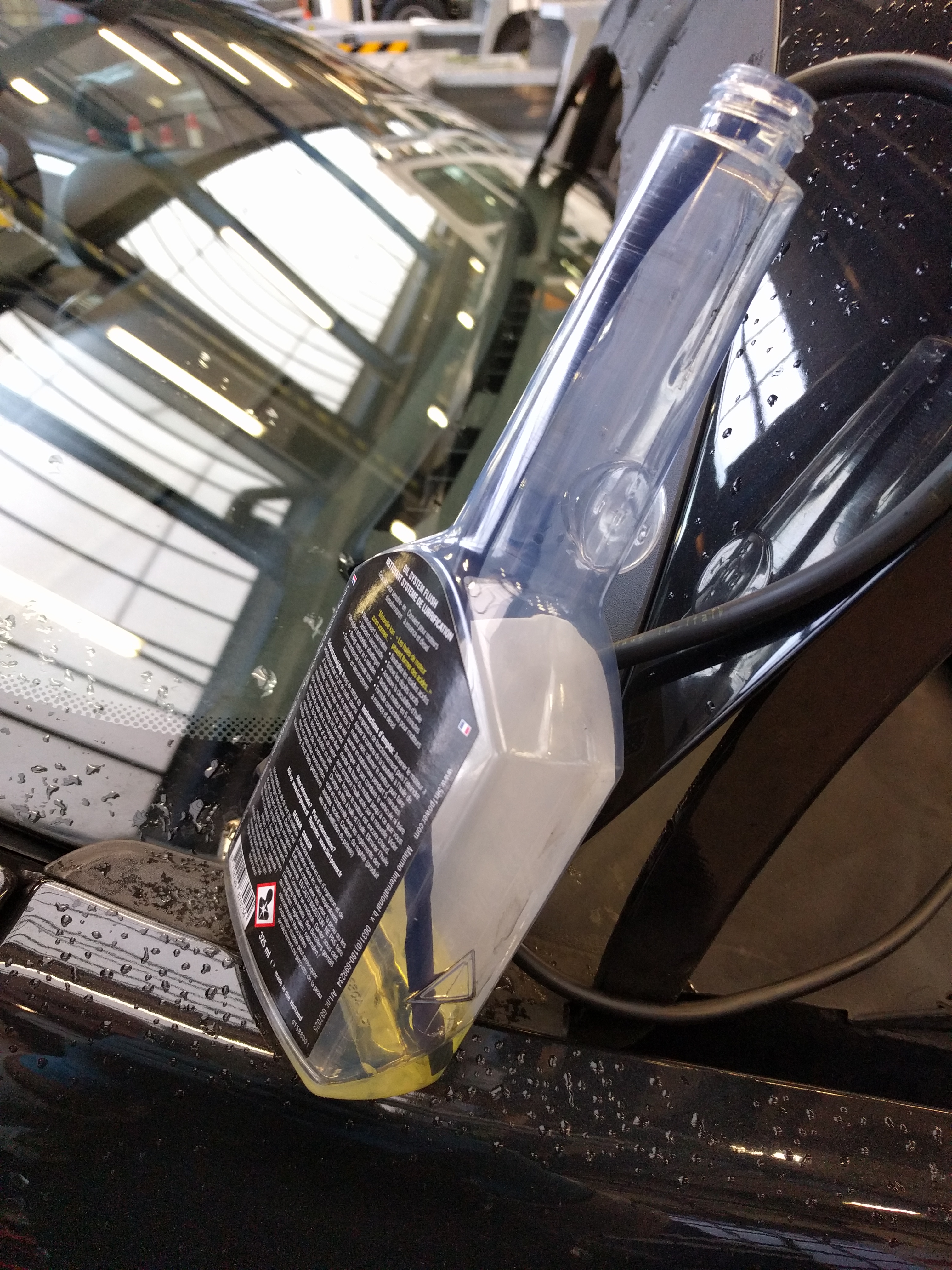

To do this I've unscrewed the ventilation bolt few turns (2x i guess), and connected a small flexible hose routed to a small bottle. This bottle was placed close to the windshield on a place where I could see from the driver's position.
To fill up the filter: turn on the ignition key and wait 10 seconds. do NOT crank!!
repeat the ignition cycle few times until you see diesel coming on the bottle. this means that the filter is filled in with diesel and has no more air in it.

closeup on the bottle with some diesel in it after venting the filter.
