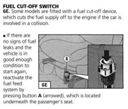

Can anyone confirm if a UK 1993 Tempra 1.6 spi would have had a Fuel cut off switch fitted?
This may be the reason I cant get my engine to run? I have fitted it to an X1/9 recently. The porter manual says 'some models' are fitted with a fuel cut off inertia switch... Cant find any legislation regarding when they started fitting the safety inertia switches.
Hopefully this is my problem...
Thanks in advance for any help
Check under the passenger's seat. If there's not an inertia switch there, the fuel pump will be controlled by a tachometric relay that relies on ignition pulses, or just a normal relay on the bulkhead.

Thanks Devran, this is the problem. I only have engine, ecu and engine bay loom. Bought it from someone who had had it fitted to an x1/9 in the past. It did come with an extra loose relay. As well as other random bits and pieces, nothing too obvious though. I have it all wired up and plumbed in, just can't get the fuel pump to run?
Crank sensor is fitted and connected. It's a stainless steel one. I'm expecting the fuel pump to pressurise/prime the system when ignition is switched on and I'm getting nothing. The circuit diagram in the porter manual does say there is a fuel vapour cut off (item 153 page 160) switch connected to the ecu. Which i don't have. I will check the wire colours tomorrow and presence of spark. Hopefully I will be able to bridge the connector and replicate a switch...
Ok we now have fuel pump priming with ignition. Have spark, but no fuel seems to be getting through, despite pump running. Getting closer...

From what I understand the 93 tempra didn't have an inertia fuel cut off but some other switch which connects 12v to the ecu. The porter manual calls it an inertia switch on one page and a fuel vapor cut off solenoid on the other (wiring diagram)

The problem with fuel supply was a seized injector. Probably overheated due to incorrect wiring for a moment or perhaps seized from being in storage. We put some current from a power supply on it and reversed the polarity a few times and it free'd up :)
