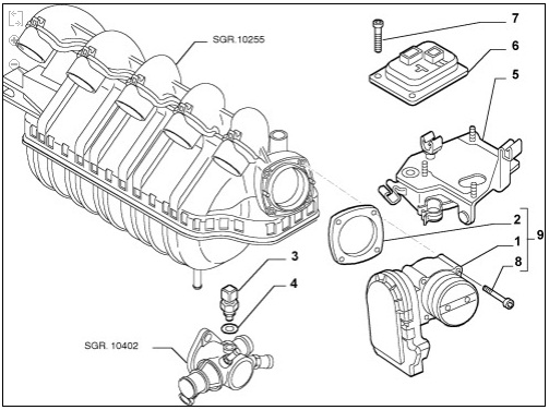

Is it item 6 in the diagram below?
Could it be the thottle body(item 1) thats buzzing?
If it is maybe you need to do the throttle re-learn proceedure?

I think he means the main ECU that sits on top of the throttle body - shown in the centre of this pic with the two black multi-point connectors on top:
If it is, then it isn't specifically related to fuel pumping, and I've never heard of it 'buzzing'.

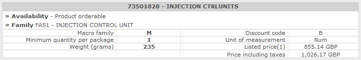

The ePER lists it as a "Injection Control Unit" (its what most of us call the "Engine ECU" I think".
Agreed, it deffinately shouldn't be buzzing, don't think there's anything in it that could make a buzzing sound thats why I suggested it could be the throttle thats making the noise as the "Injection Control Unit" sits right on top of it.
Hope its not the "Fuel Control Unit" as they're over a £1000 new.

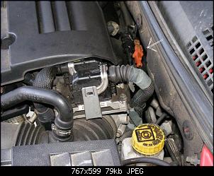

Hi cheers for the quick reply, and it's the number 6 on the digram which is making the noise and relearn proceedure ? And I will put the pic of what is making the noise.
And I just went and had another listen to it and it anit a buzzing noise but maybe either a shorting noise or liked a pump sucking air??
