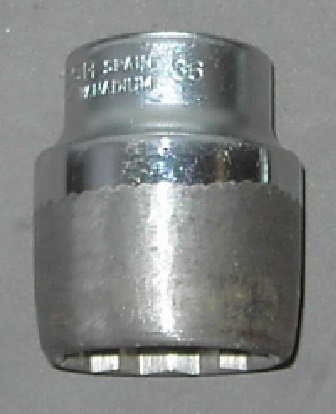

Yes... most difficult part is getting the hub nut off. I used a ¾" drive socket set and a 6 foot length of 1¼" gas barrel as an extension. You'll need a 36mm socket with its circumference ground down to fit in the hub flange. The nut is staked into a groove in the shaft, so you need to unstake it before removing it. When refitting it, you'll need a new nut.

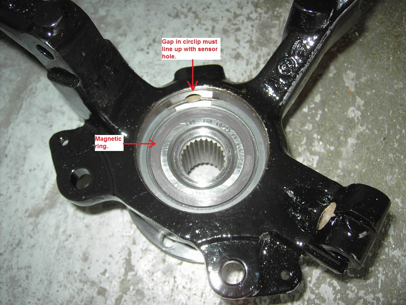

After fitting the new bearing, make sure the circlip is fitted in the correct position.
