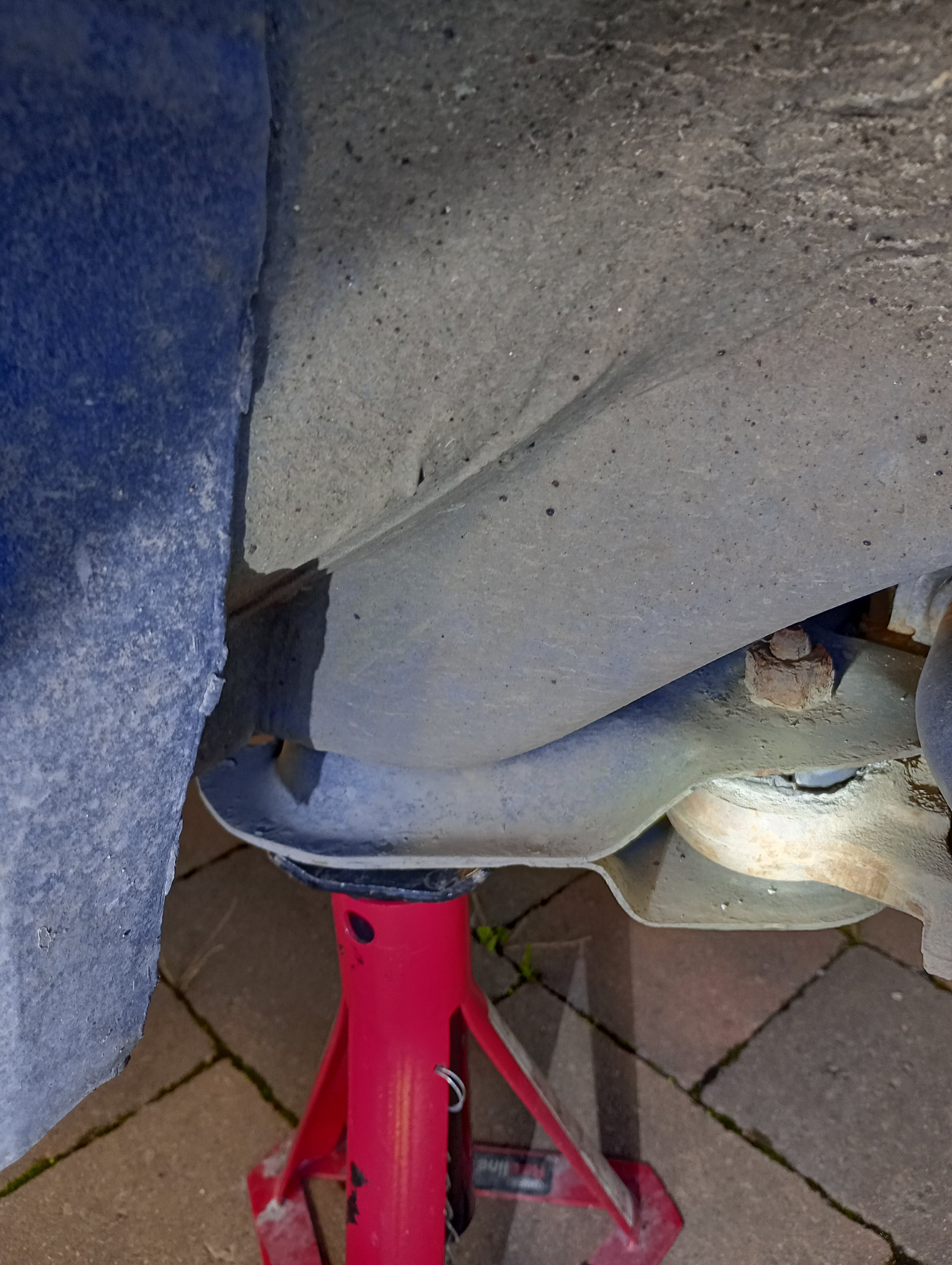

I've noticed that the large suspension bush on the right side of this photo looks perished. Is this the front suspension lower arm? Is it a difficult job to remove this arm to replace these bushes? Or is it one of those bushes that cannot be replaced and a new lower arm is required. Thank you.
I change an arm in under 5 minutes
Change a bush without a very large hydrolic press over an hour
I drill the middle out then hammer and chisel the alloy shell out
Need to be changed as a pair really
Thanks for the reply. I will replace them as a pair. I guess it's probably best to replace the arms instead of replacing just the bushes. I can get a pair of them on eBay for £50.99 so I'll probably get them from there instead of sourcing genuine Fiat arms.
You *can* get the correct bushes separately, and it can be worthwhile on a 100hp IF it has proper 100hp arms on.
Sadly, many suppliers list the standard arms as suitable for a 100hp (they are supposed to be different).
(Or maybe people mis-read the compatibility list and see ones that are suitable for a 1.4 natural power, which is a lower power 8v that can run on CNG).
Standard Panda arms will fit, but probably shouldn't be used (opinions vary).

I'm going to replace the complete arms but the difference in the bushes is interesting. Cheers.
I guess I need to check photos of arms to see if I can find some with correct looking bushes but not sure if suppliers photos will be that good!
Standard work fine
But less responsive
100hp
More responsive
Standard arms were fitted for some countries
As far as I know the special 100hp bushes were always fitted for the UK market
If I regular park with two wheel up a curb I would probably fit standard.
If I want a track car I would fit the proper ones
As I don't have a 100hp or do either above I don't know what I would fit

It's pretty obvious in a photo, bottom of this one
Registration number lookup for my old 100hp gives standard arms on many web sites.
Part numbers should be:
51857135
51857136
I have used various brands, but the only one which seems to have stock is Magneti Marelli.
Shop4Parts currently have them in stock, as do a couple of other suppliers.

Thanks for your help both of you. I've ordered the Magnet Marelli arms from Shop4Parts. Total cost was £112 incl. delivery so a bit more expensive than the £30 - £40 arms but I like the idea of having the proper part even though it's not a track car!
Ride hight will be different, just drop it back on to it's wheels to tighten the bolts that go through the bushes
I"d be soaking the bolts in penetrating oil now, and loosening the bolts ready
Pinch bolt might snap, there are very small, worth getting a spare if it's not been apart for a few years, I have never snapped on but others have
Nut should face the front
Jack one side at a time the anti roll bar gives you an extra few inches of clearance. Just bash it down with a 2lb club hammer or similar, your not worried about the old part
After I fitted new arms (Magneti Marelli) to the 1.2, I was surprised how much the wheel moves when moving forward and back while parking the car. I fitted the correct 100HP arms at a fair bit more money, but they have lasted 40,000 miles and still seem to be good. It's likely the cheaper type would have failed long ago as the wider wheels apply higher forces.
I replaced mine two weeks ago as it failed in MOT. It took me around an hour but I had a vague idea for what I was doing - first time doing one it took twice as long.
