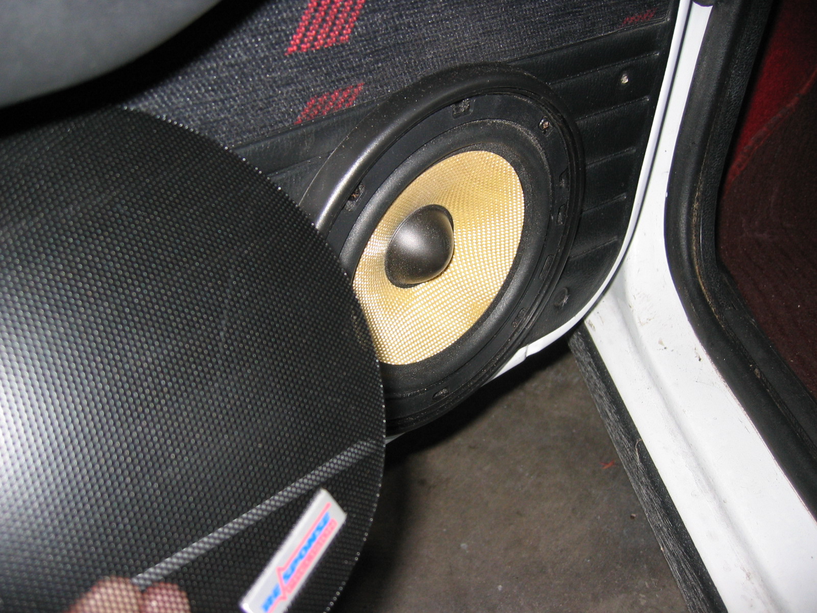

I cut out some 18mm-thick MDF to make supports for my 6.5" speakers - the pieces are screwed to the back of the door metalwork, then the trim card goes on, and finally the speaker goes in with long screws to go through into the MDF. It has made a nice solid mounting that really helps the sound.
Strangely I can't find any pics of the installation, since

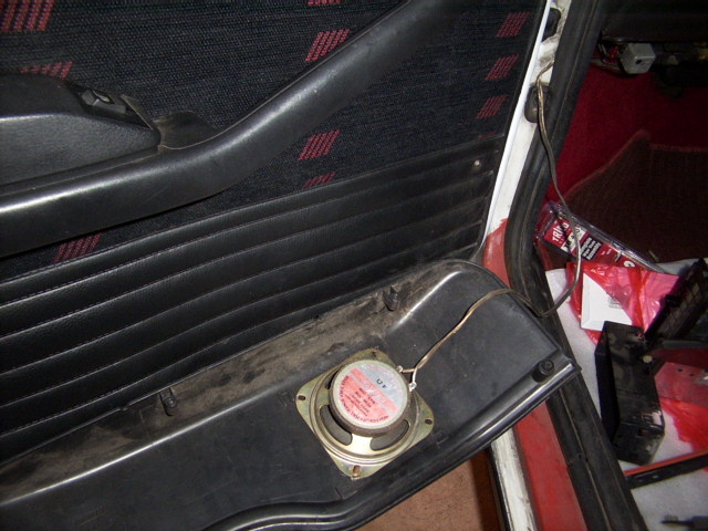

Here's a pic of what NOT to do... the speakers that were in my Uno Turbo when I bought it, four years ago.
And here's a pic showing the finished install. Note that the window doesn't go all the way down - stops about 4cm from the bottom when it hits the rubber-coated magnet ;)

Alex's front install is the best way for the front speakers. Unfortunately you're limited with sizes, as the gap between the front door cards, and window is quite narrow.

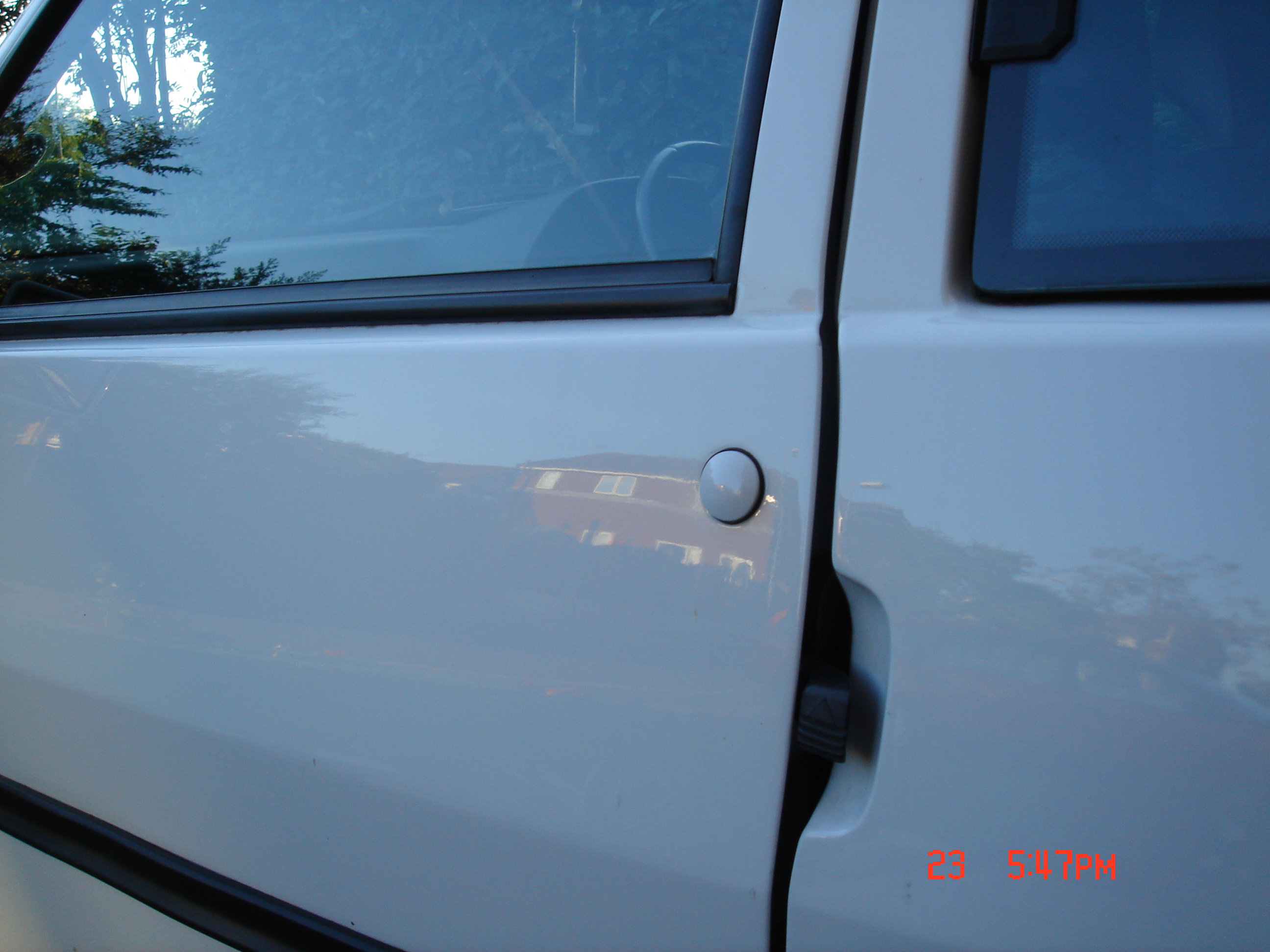

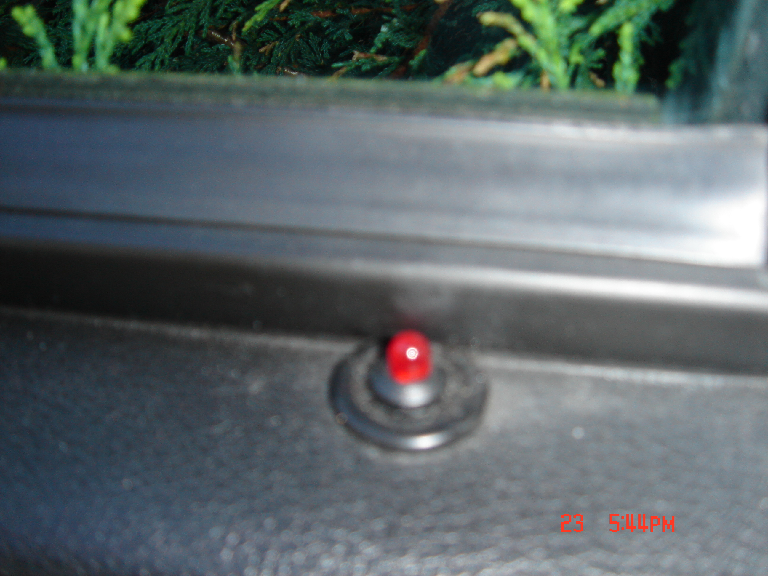

Personaly i would never chop into my original door cards or rear quarter panel cards, (not original and no going back) putting speakers where the rear passenger sits is a no no!! always ends up them squashing, damaging them with hips elbows etc, there is more than plenty of space behind the dashand the sound is aimed at the driver not your carpet! and the speakers in the rear shelf has always worked in any car and is reversable as i have a spare shelf, a few anti theft tweeks keep it all nice and safe eg cat 1 alarm, locks replaced with blanks (no screwdrivers) and door pins removed and replaced with flashing led's, (no bending the door backand pulling pins) and i'm never far away and pounce like a ninja!!! Ant!

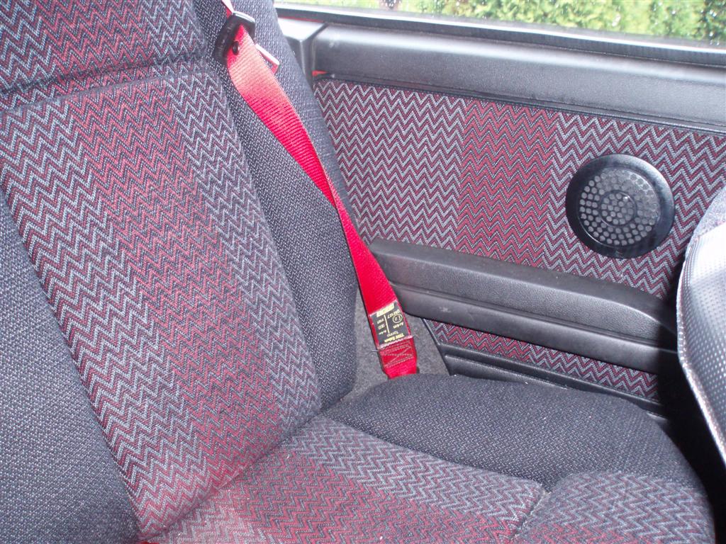

MK1 uno turbos have standard rear speakers in the rear door cards!
Ummm... 'standard' could mean 'fitted at the dealer's', given the lack of stereo/speaker wiring in the Uno when it came out of the factory.
Perhaps there is a cutout in the hardboard for them? I'd accept that as 'standard'. ;) If you look in the front door cards (a bit tricky on the Uno Turbo because they're covered in plastic on the back) you'll find some perforations (slotted holes) for a large-ish speaker in the bottom front corner. This is the Mk1 at least.

The rear card speakers were a dealer option.
As standard they were only fitted with front speakers in the UK, but a lot of the Fiat dealers recognised that wasn't really going to cut the mustard with the potential younger buyers of the UT.
When I bought mine brand new in 1989/9, it was an option available for me. But I decided against it only that I like the look of the rear card without a speaker on it, I also thought about fitting something myself instead.
