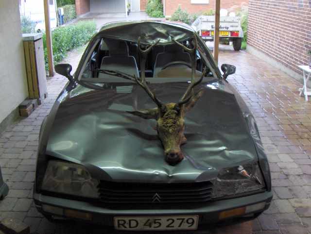

It seems that the hunting season in Europe just begun - compared to this Dane who had an encounter with a deer last week, I was really lucky:
