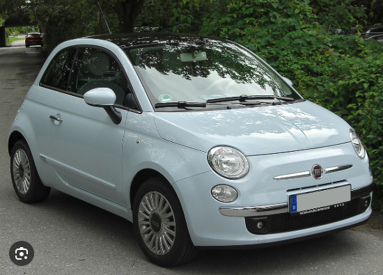

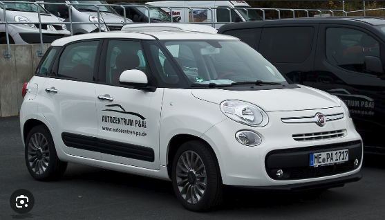

What car have you got?
A FIAT 500? or 500L?
This thread is in the 500L section, the other two in the 500 section. That makes a huge difference.
FIAT 500:
FIAT 500L:
Random pics from Wikipedia.

I've already checked what would be needed for the 500L, but realized that probably the OP has the 500 and posted in the wrong section. I've noticed that people quite often mistake the 500 Lounge with the bigger 500L...

As for what I was able to check during the weekend, there were 2 front bumpers available. The first one same as on the photo attached to my first post (the white car with the German reg), the other one looking differently (however this one was most probably available only on the Trekking version):
Can you please confirm which bumper do you have?
