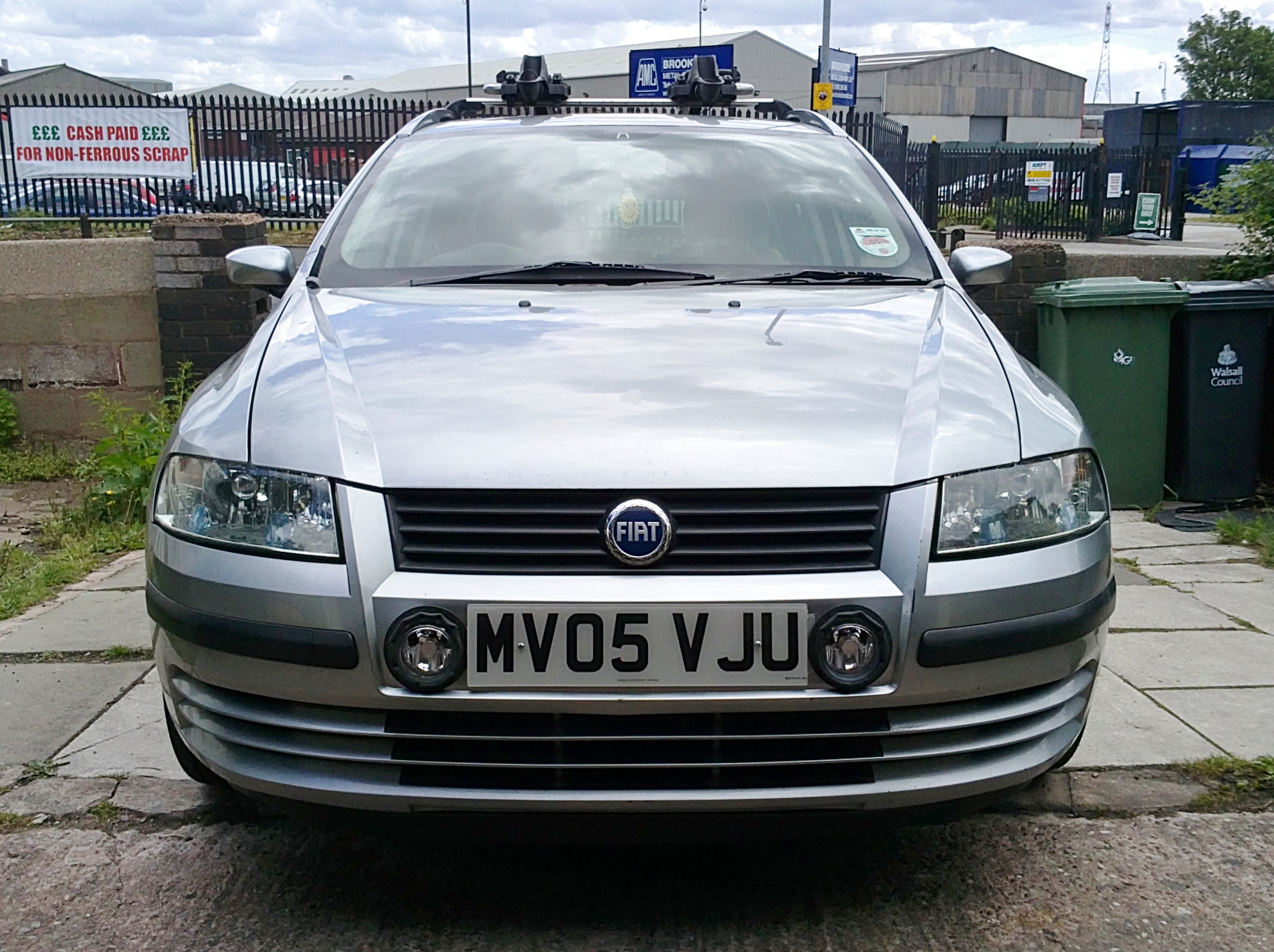

Here's the end result. Unfortunately the chrome trim I purchased to fit around the lights was too small so I used an old door seal I had lying around.
https://www.fiatforum.com/stilo/271475-stilo-bumper-lights.html
attachment.php
My car is a 3 door 115 JTD Dynamic and has the auto adjusting headlamps with the headlight washers. Well, I have been searching for the ones with the curve in it but no result. Plus I am only after real fog lamps but their problem in that is that the stilos didn't come with any.
shadeyman that looks exactly what I am after but without the black around them. In your opinion do they really make a big difference as stilo lights are not the best. My fiat bravo lights were much much better than the stilo.
