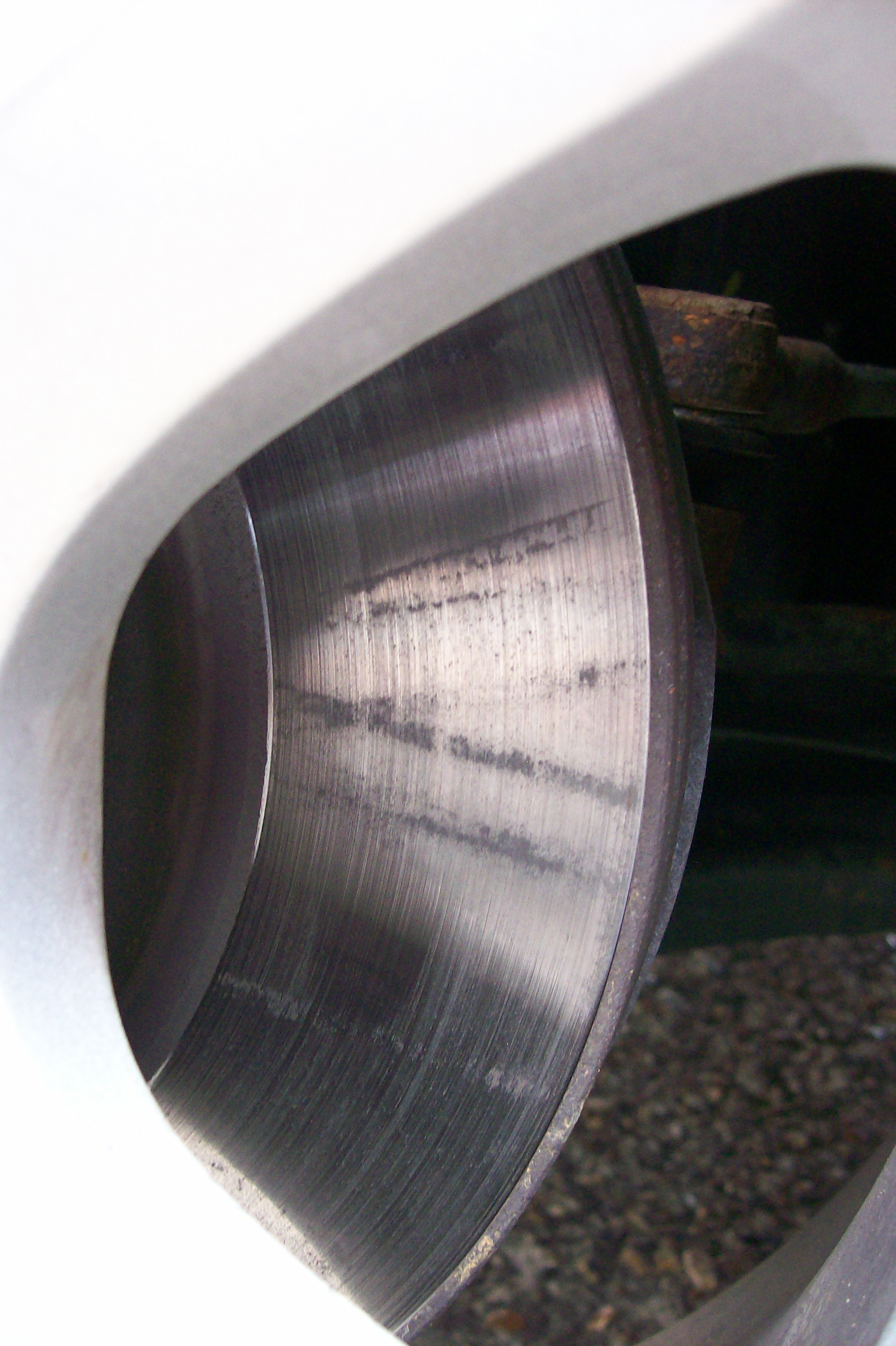

Anyone else noticed black coloured marks on front discs ? I'm wondering if this has been caused by overheating ? I've noticed a 'deep drumming' noise when braking from high speed & fully-laden otherwise brakes okay

The marks are where the pads have sat on a hot disc; the "drumming" is a sign of a warped disc; both are caused by keeping the brake pedal pressed while stationary when the discs are hot (meanwhile dazzling the poor driver behind with the brake lights); uneven cooling then warps the disc.

TT, appreciate your reply but I don't think my driving style is the cause ;-) The front discs on my other cars show no signs of overheating and I drive them the same ?! If the discs were warped then I would expect to 'feel' that through the steering under braking, which I don't. I think the problem is due to defective parts during manufacture but the difficulty is proving that ?! regards

The other possible explanation for the marks is electrolytic surface corrosion between dissimilar metals in the pad and disc; the pads always remain very close to the disc and if there is some salt water between them then this type of corrosion may occur....
