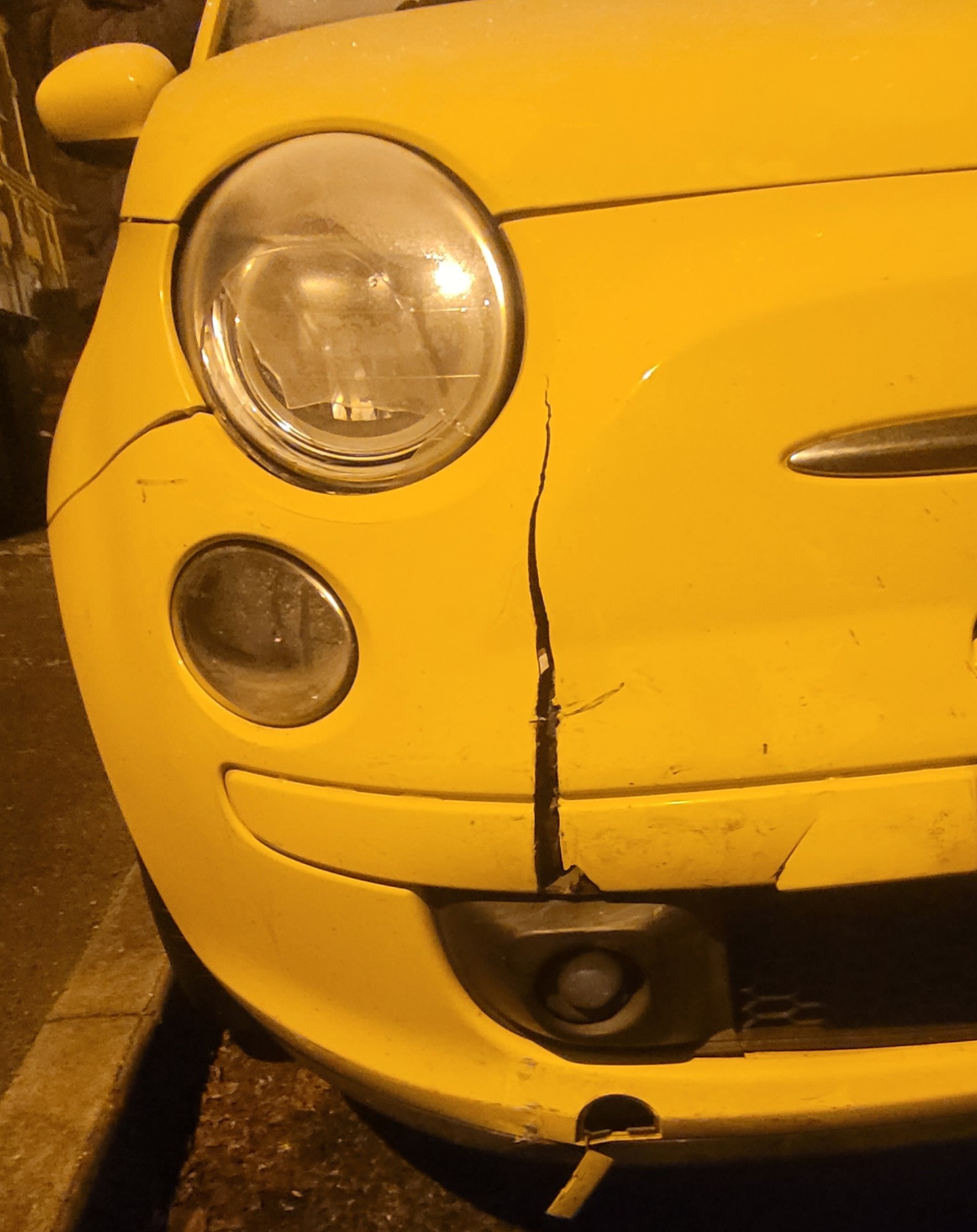

I had a collision a few months ago which left me with this:
I bought a plastic welder, took the bumper off and fixed it up:
It still needs filling and painting but whether I do that myself or take it to a bodyshop, it's saved me some money! Very happy withe results.
I posted a guide on how to do this here.

Pretty happy with the crack repair so far. The plastic welder will come in handy for other jobs so the money spent on that wouldn't be a waste even if I get a new bumper and it only took 4 hours which wasn't a waste as I put a new headlight on while the bumper was off.

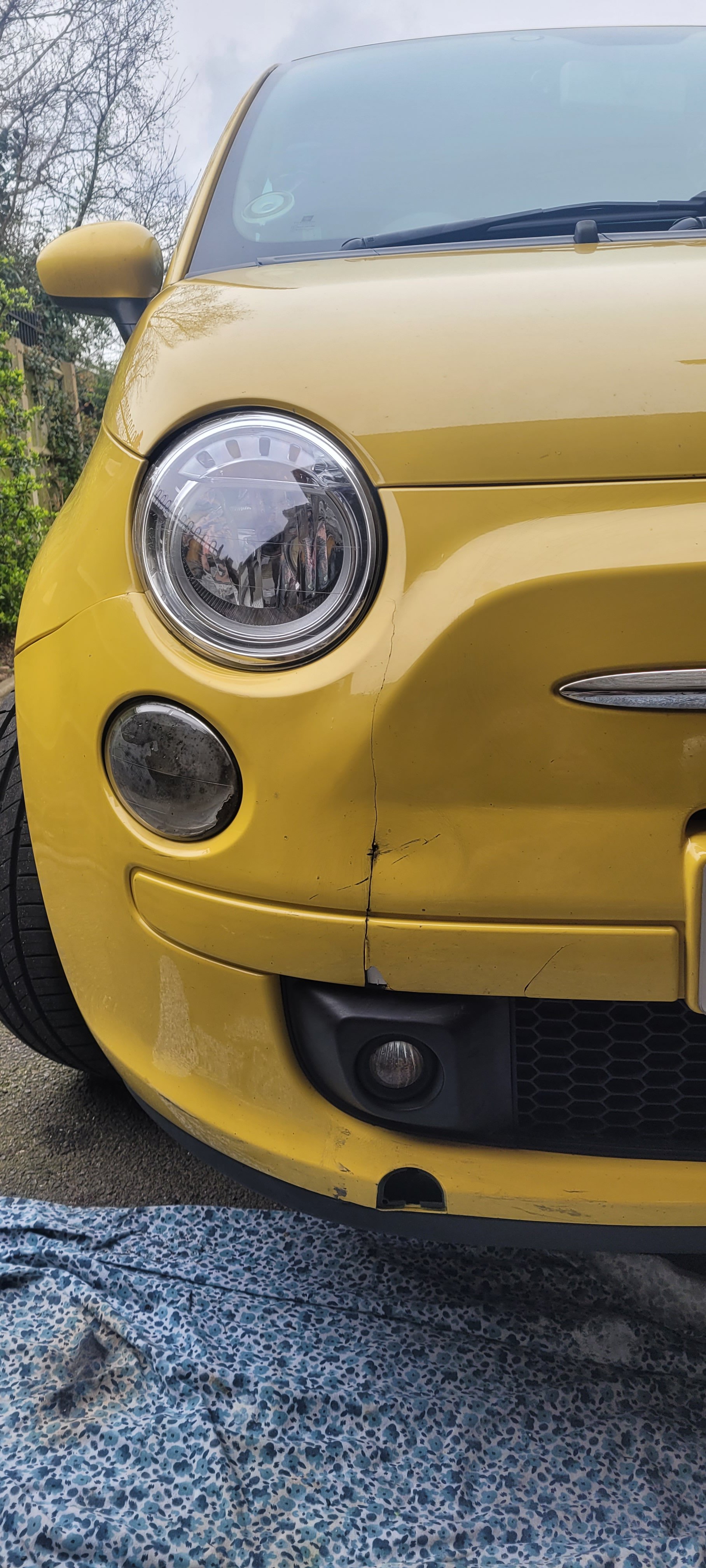

Thanks but I already got a new one and put it in. In the first photo you can see the cracked one and in the second photo a new (used) one. I do need to replace the daytime running lights though. The connector that the plug goes onto is badly corroded and two pins have vanished.
