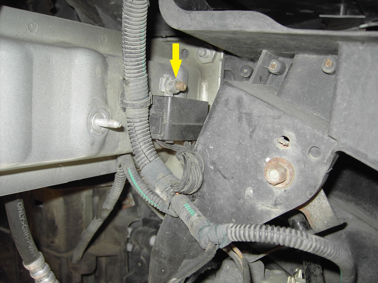

The right headlamp earth is in the multi earthing point under the right front wing in front of the windscreen washer resevoir. You will need to remove the wheel arch liner to access it.

Thank you. I'll do it at the weekend and give a feedback.
I cleand evrything and the problem sloved. Thank you very much.
