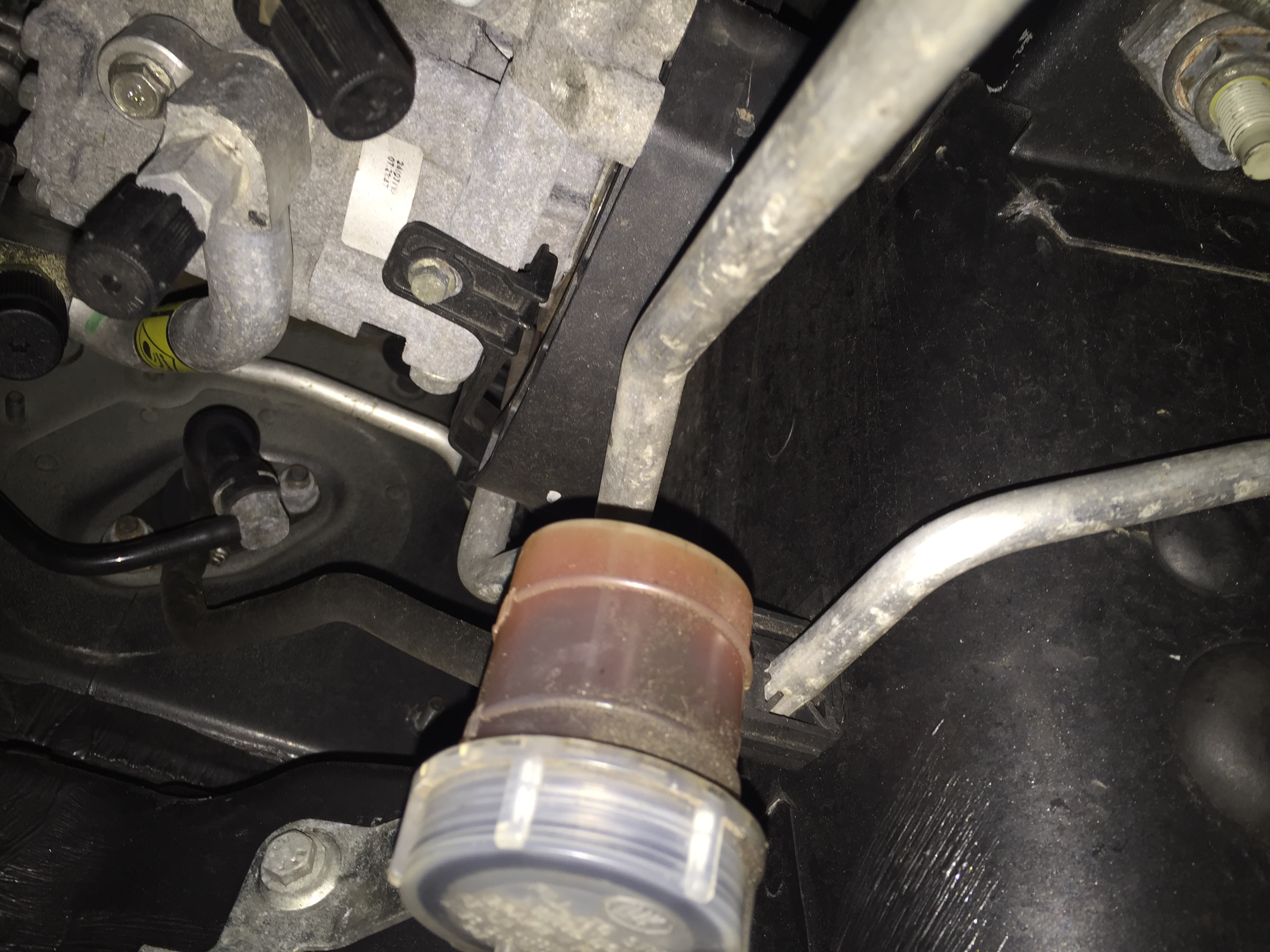

Hard to put car into gear is often a lack of clutch disengagement(as though you need to press the pedal more but can't), doubt its the clutch itself, so I'm guessing the slave cylinder(£17) or fluid/air in the system issue, will see if I have a photo but clutch fluid level is the small reservoir on the left looking to the rear against the bulk head with a pipe going off to the right. Can be checked at any time too

Have taken a picture of (what I think?) is my clutch fluid... it looks quite full to me, even above in between min and max. It looks quite brown, is that the colour it's meant to be?
Please let me know if fluid looks wrong x
