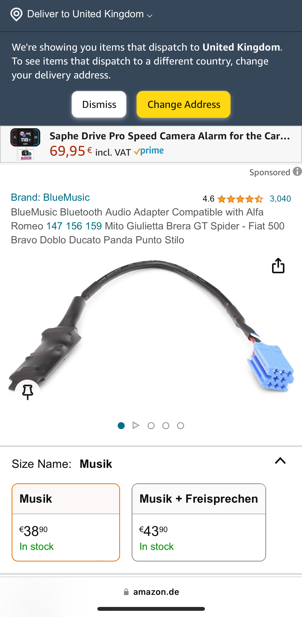

You can get a Bluetooth dongle that goes into the back of the original stereo and also get the adapter to keep blue & me going (there is a YouTube video somewhere)
Installed mine some 18 months ago, I also now have the 16 and works a dream! Can play Spotify to my hearts content ☺️
The black bit with blue is the Bluetooth, to use the blue and me voice command you’d need the multi plug adapter too. (Partner figured it out but in short you pull the blue bit off the multi and put the blue bit from the blue tooth and plug in that way)
