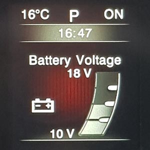

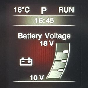

Aren't the built-in voltage gauge readings enough for the assessment? If I'm reading it correctly, the gauge shows 16V at idle and 12V with engine off. Admittedly, it's not the most precise gauge in the world, but still...

On face value your alternator voltages look normal.
