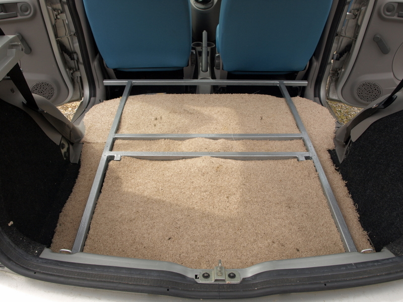

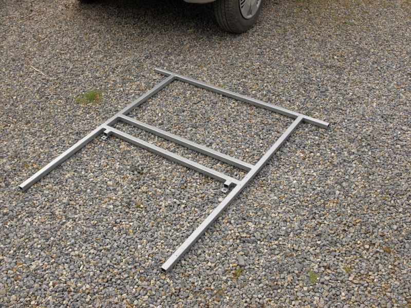

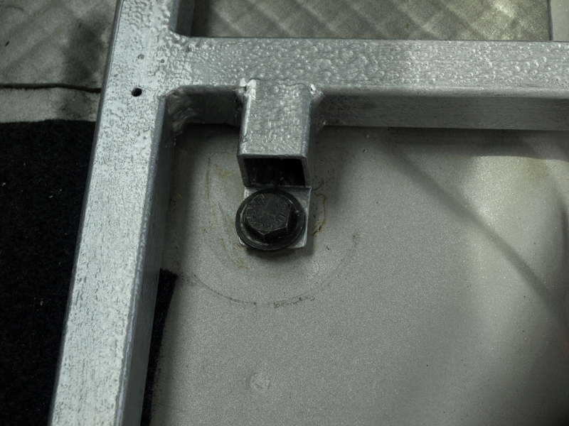

We needed to move some beehives (they were occupied but we have ways of making them escape proof) using our Panda multijet. Although we have a trailer, the windblast and jolting they would have suffered meant it was better to put them in the back of the car. But the rear seat doesn't fold down flat. So I unbolted the seat back and the seat cushion, (they are easy to remove) and the floor thus exposed is sort of flattish. I then got some 25mm square steel tubing and with a MIG welder made a flat subframe that bolts onto the panda rear floor using two bolts which normally hold the seat cushion in place. It's painted with hammerite. I used some old carpet, cut to fit between the tubing to keep the road noise down as much as possible, then cut 9mm plywood to make the floor. It's in 2 sections so you can just take the back half out if you want to get at the spare wheel & jack. The wooden boards sit on the tubular subframe, and the carpet covered spare wheel. They are held in using M4 screws in tapped holes in the subframe. So we now have a flat floor, with access from tailgate or rear doors, and it can all be taken out and seat replaced as normal when needed. The bees are doing ok, and none escaped on the journey.

It's 116cm (45 1/2") front to back, and it was made to fit with seats as far back as either of us ever wants to put them. The seat backs tilt backwards a bit though so you can't put anything tall right at the front of the floor. Plenty of room for 4 beehives though! Also, if you open rear doors you can put valuables in the rear footwells under the floor. So "chummy" can't see them.
