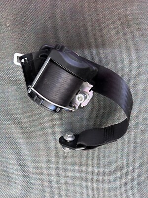

Could someone point me to a formal reference to part numbers for the rear seatbalts on the 2008 panda?
I sold a couple of seatbelts and the buyer is stating that their mechanic says they are wrong and that they are the front belts - this is imposible as the front belts are still on the car!
Also the part numbers I have (3303 1764, 3303 1765), which are shown in the listings match the part numbers for other listings for rear belts.

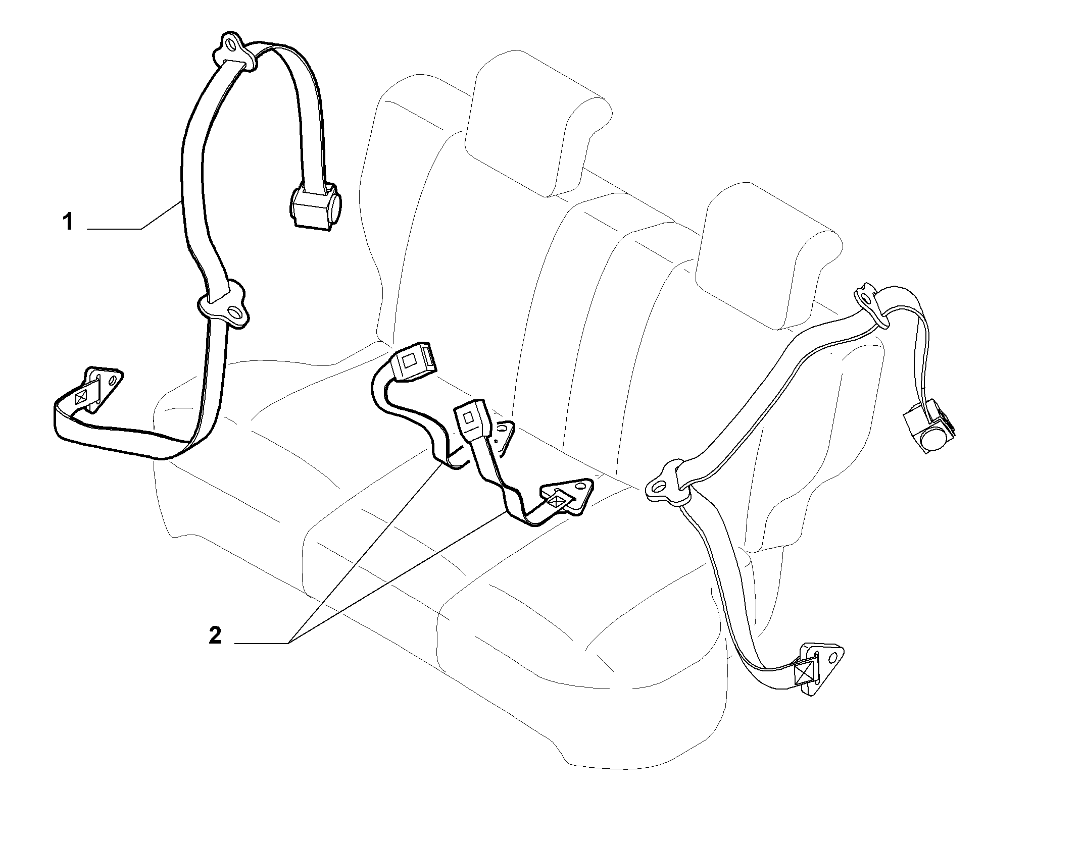

This generation FIAT part numbers usually start with a 7 and are 9 digits (like in the screenshot posted by koalar), but I tried adding the 7 in front of the numbers you've posted and ePER cannot find those neither :(
I can see there are 3 different subcategories for seatbelts on 2008 panda, depending on the trim level:
Then, the sliding seat, the static or with refurling reel have different part numbers. Which makes many combinations. But still, all of them start with 7 and are 9 digits as far as I can see.
The stickers don't look like FIAT ones, perhaps those are TRW numbers? And as there are no FIAT stickers on them, no one is referring to those...
