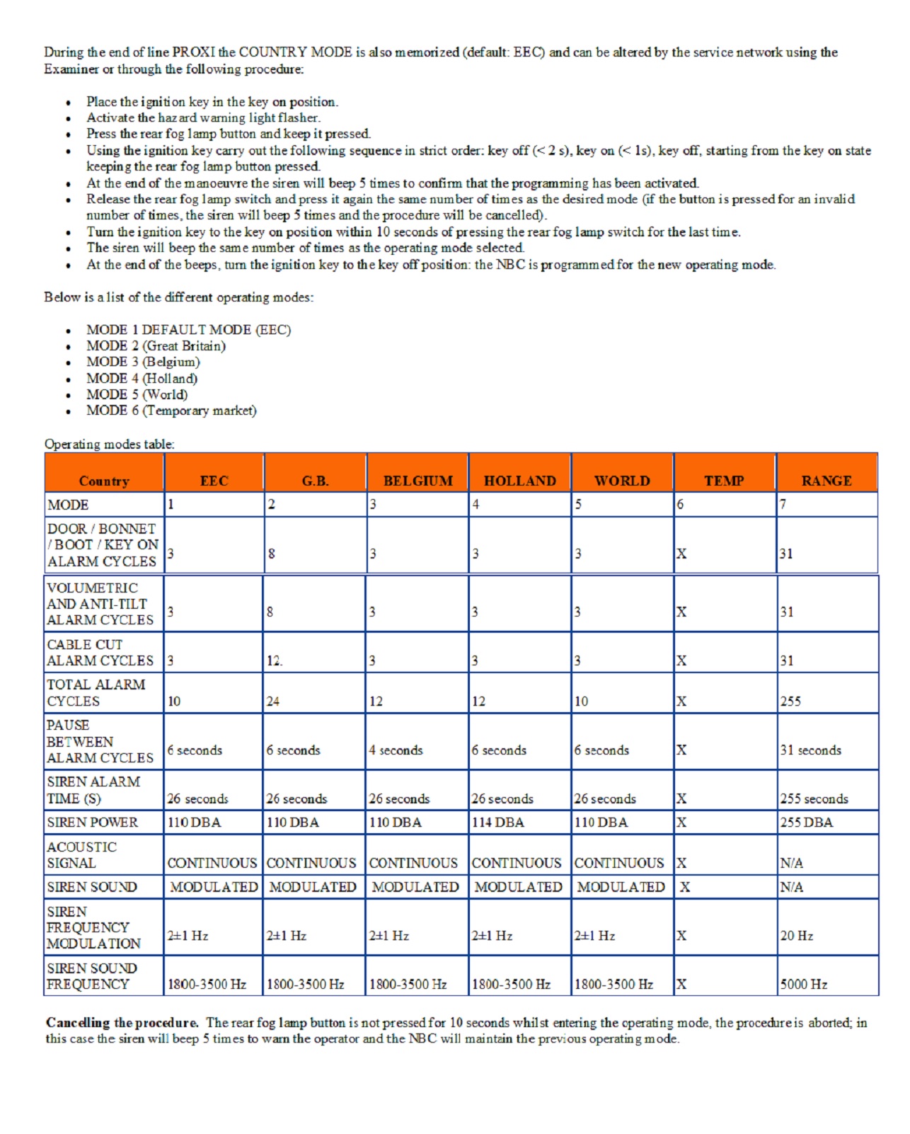

For cars with the factory fitted alarm, you can change some of the settings with MultiEcuScan, or manually by using a combination of the ignition, hazard and rear fog lamp switches.
