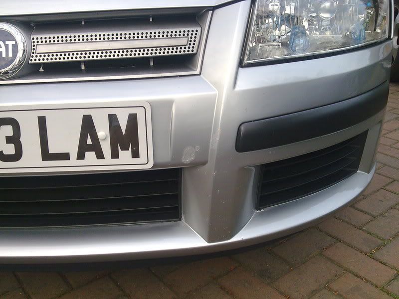

As the title states, i went to the car wash this morning as i always do every sunday.
Once i got her home, i got out and had to admire her but then i saw this...

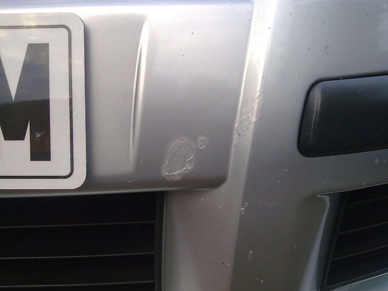

A closer look...
To say i wasn't happy is an understatement! I've been halfords ro pick up some touch up paint and i've gone over it but its still clearly visible as the damged area is quite big.
Any suggestions as to what i should do?
Its only an 05 plate so i don't understand how the paint can already be peeling.
Someone help me! :worship:

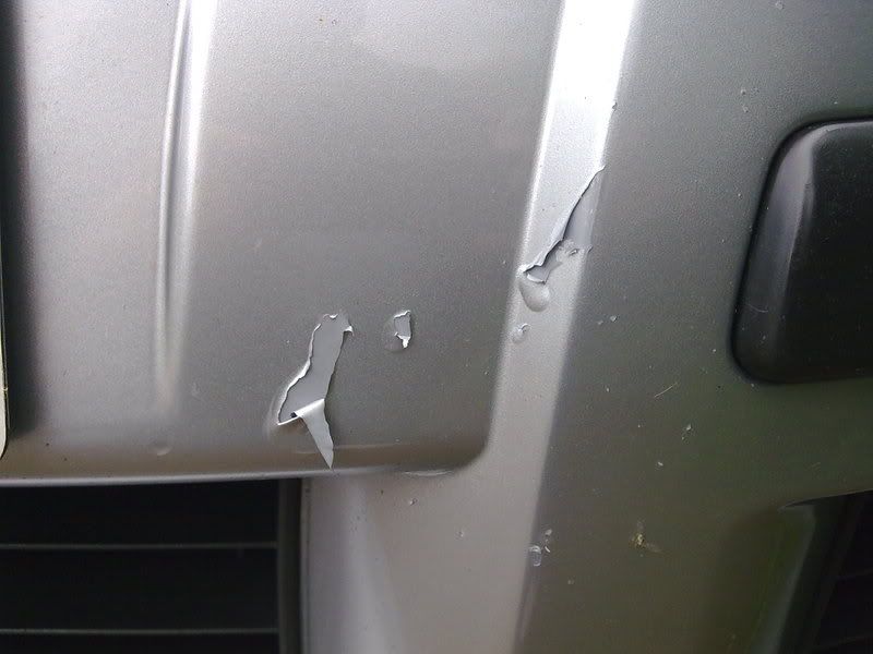

I've had this on one of my sills, i used a jet wash and got a bit too close, the heat had obviously softened the paint and the pressure just blasted a piece of paint about the size of a 50p piece clean off leaving the primer underneath.
Yours looks more like something has actually scratched into the paint ulling it away???
To get a good repair you'll need to sand it down and respray im afraid.
Can you be sure this has never been 'repaired', like have you had this car from new?

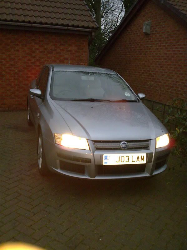

This is how she looks now:
Thats from using touch up paint mixed from Halfords.
I do like your grille on your stilo, Where did you get it or is it a standard one.
How about a picture of it in full please.
that seems really bad if that is "fiat paint" flaking already. try the dealer for the paintwork warranty - think this should be covered. the big negative is that - understandably - you've tried to repair it yourself. may be a massive own goal as could invalidate any claim that may have been there....

i have seen this before, i have a hole in the laquer on my rear bumper that was a tiny mark but jetwash ripped into a hole just smaller than a 5p.
personally, i wouldnt have tried to touch up the mark and spoke the carwash people, i feel the holes could have started with tiny stone chip and they got too close with jet wash and pressure ripped a hole in the laquer
Thanks Dibbers, may have to call local fiat dealers and get one, looks so much nicer than mine.
Yes its the updated grille which i retrofitted myself. Cost just over £40 from the dealers.
I think this grille only suits silver/grey stilos only.

this has happened me in the area above the front number plate. pressure washer was to blame again tho i only ripped the laquer so the paint is still underneath
raging to see that happen. it looks like its a possible repair job that the paint or primer hasnt been applied to properly as flat areas like that shouldnt really suffer this sort of damage, its usually ends or sharp bends on panels (like mine)
no bodywork shop will just do this wee bit, it will have to faded into something so it'll prob be an area like an 18" circle masking the grilles and headlights.
