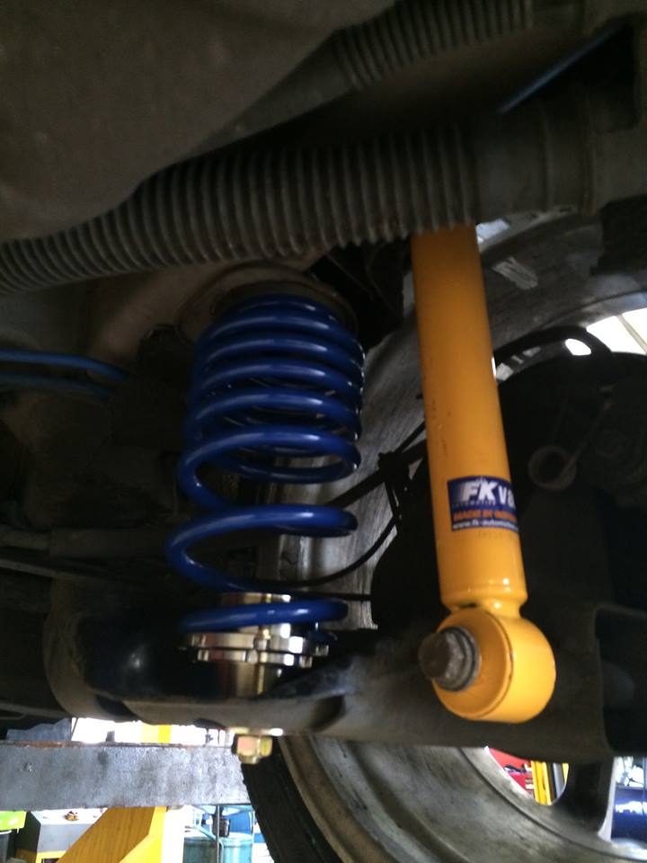

Thank to Wegi I am now the very excited owner of a FK 'coilover' kit for my Bravo :devil:
Just inspected it and it looks excellent, includes KONI dampers
the rears are not actually 'coilover' they are spring platform with seperate dampers - this is a similar arrangment I had on the 500 (y)
can't wait to get it fitted and set up, report to follow
Finally got the kit fitted and very happy with the garage that did the work FoxGarage Camberley.
After a little tweaking raising the front 12mm I am now happy with the stance. Front is -35mm, rear -20mm. Shocks currently full soft. Car feels really good but a little under damped on certain surfaces so should be even better when alignment and stiffness optimised. Feels like driving my old Fiat 500 Sport! Big grin.

Looks fantastic Rob! What kind of adjustability do these offer? Wish I could get more stiffness in the rear
