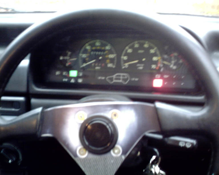

Hi guys,
Sorry to bring this thread up again!
I managed to get SX dials from Poland cheap, on the downside they were KPH.
I fitted white MPH dials & upgraded all the bulbs to LED`s & added 2x green 25cm SMD strips inside.
I transferred my old speedo into the new pod (so the mileage would be right) & had to fit the KPH speedo face (as the original is about 2cm bigger).
I finally got round to fitting it today & have 3 problems..
1. With the sidelights/headlights on, the fuel gauge over reads by 1/3rd.
2. The indicator warning light is now only working when indicating one way (but they are all working fine outside the car).
3. The main beam tell tail isnt working (it was when tested indoors), & when you flas the lights, the rev counter & fuel gauges `jog`slightly, suggesting an earthing issue. (the main beams do work though)
I didnt have either problem with my old pod!
I checked the connections & earths, all seem fine.
Other than that (& a bit of light bleed round the fuel gauge where the paper isnt on straight!), I like it! (y)
I havent wired in the rev counter yet as its just stared hailing.. Hopefully it works after all this.. lol
Any ideas guys?

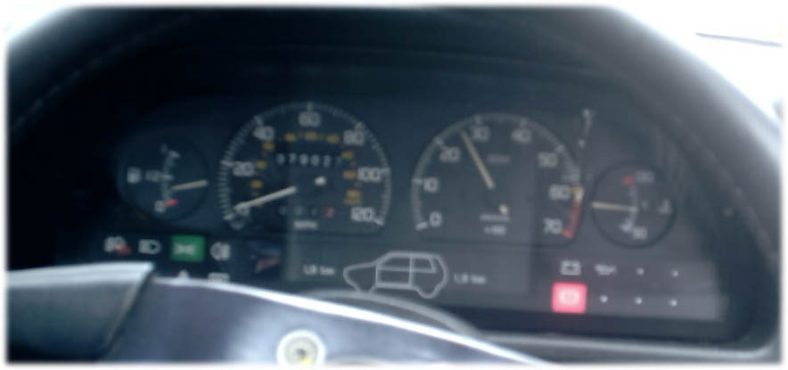

Stopped hailing & raining for half an hour, so popped the wiring on, & I can confirm the rev counter does work & seems accurate :slayer:
The other things are still happening though..
Heres it working & the grommet, behind the fuse box, I put the wire through:

Hi ya,
It may just be the camera but the warning lights in the dash look too focused - like they have been replaced by LEDs too :confused: I'd try swapping the bulbs from your old dash and see if you still get more fuel when you turn on the lights :D.
Other than that I'd try earths and also have a look inside the pod at the pcb for caroded paths.
Alright Louie,
Cheers for that.
I did swap out all the bulbs with LEDs, I also did one repair on a burnt section of PCB.
Its odd that its only affecting on a few of the circuits though, especially the indicator tell tail only showing on one side.. Strange..
Maybe I should have checked it on the car before stripping it..
