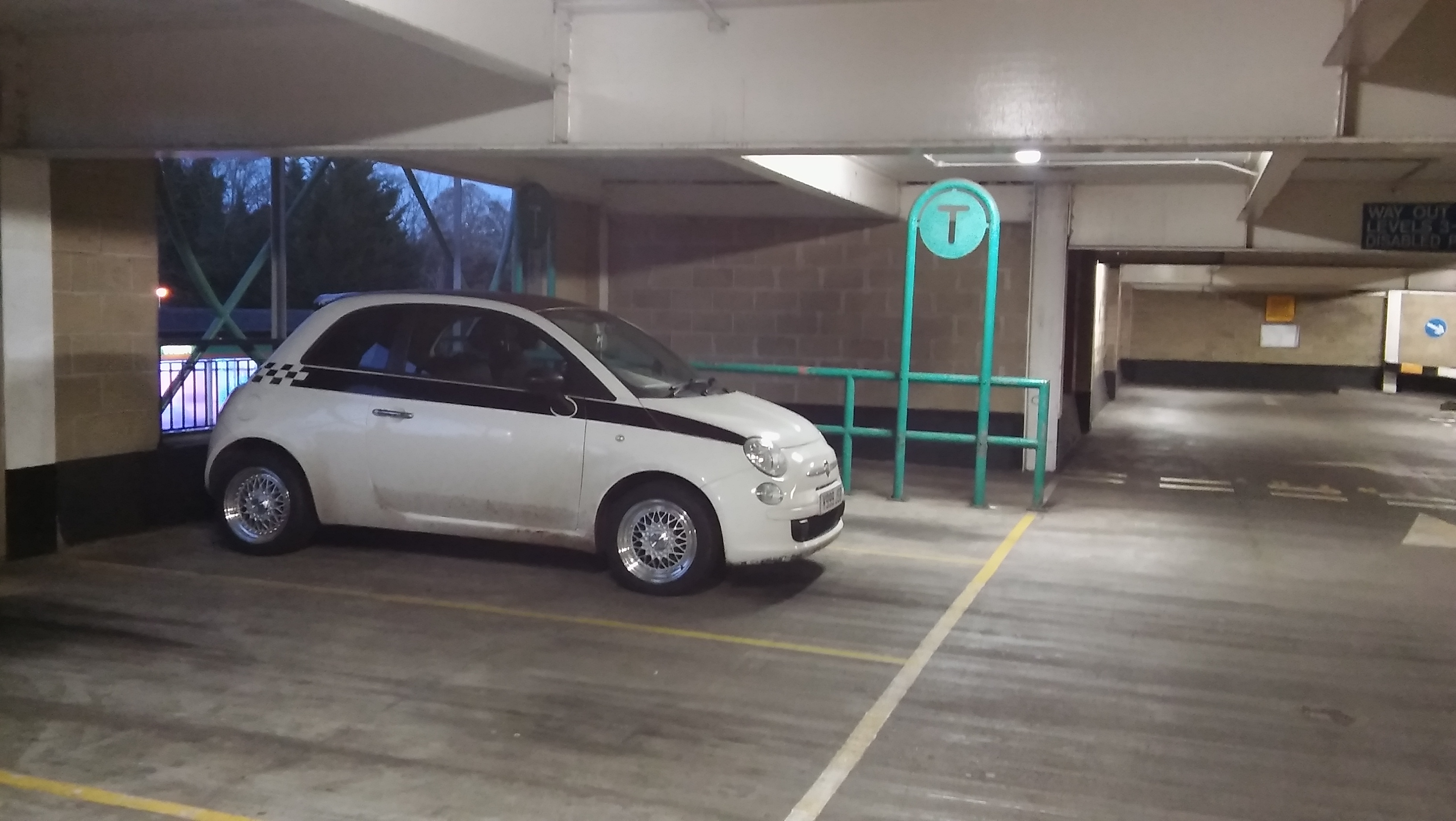

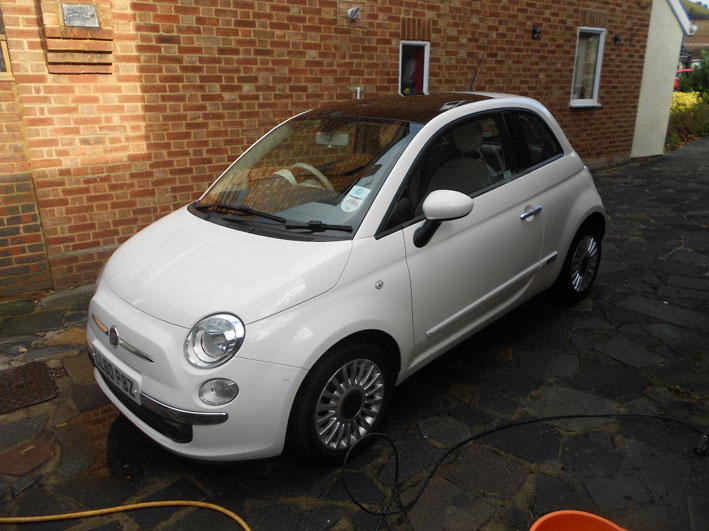

Pictures attached. Before the stripes and after the stripes. I think the white cars look much better with them.

I think if you had rubbing strips and big stripes like mine it would be different, but I think that looks really good!
How did you get them dead straight? Also it looks like it's a straight stripe across the door hinge and doesn't stop for it! :p

They are lined up with the crease that travels the length of the car. Because they went on wet it was easy to slide them around to get them dead straight.
I actually took the picture before I trimmed the edges. I don't wrap them around, I cut them about 1mm short if the end of the door both sides.
