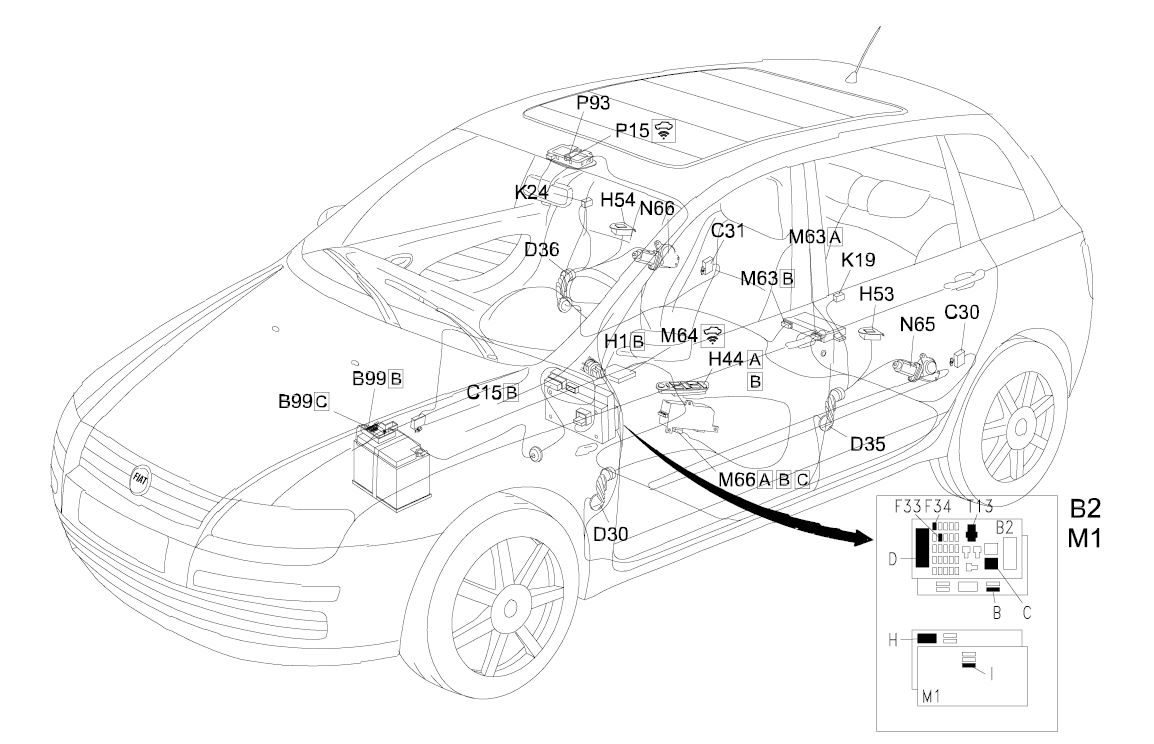

Both rear door electric windows are controlled by a single module (M63 on the diagram below). The workshop manual parts location diagram shows it as under the left rear seat, however the only diagram is for a LHD car, so it may be under the right rear seat.

Problem solved. Thanks to Davren for the location, fitted it and all windows now work. Thanks for all the replies.
It was behind the passengers seat but more to being in the centre.
