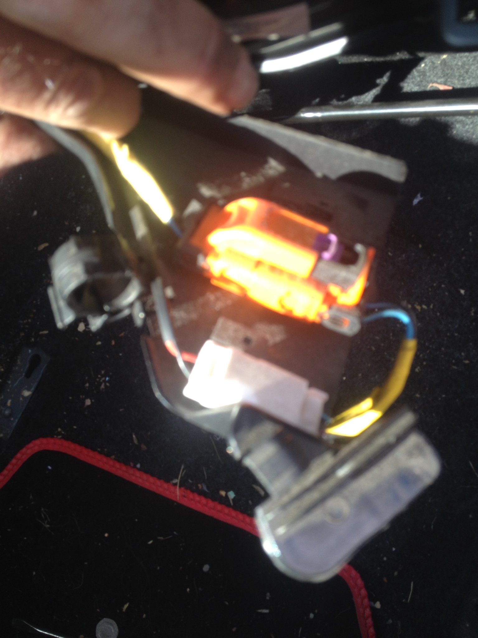

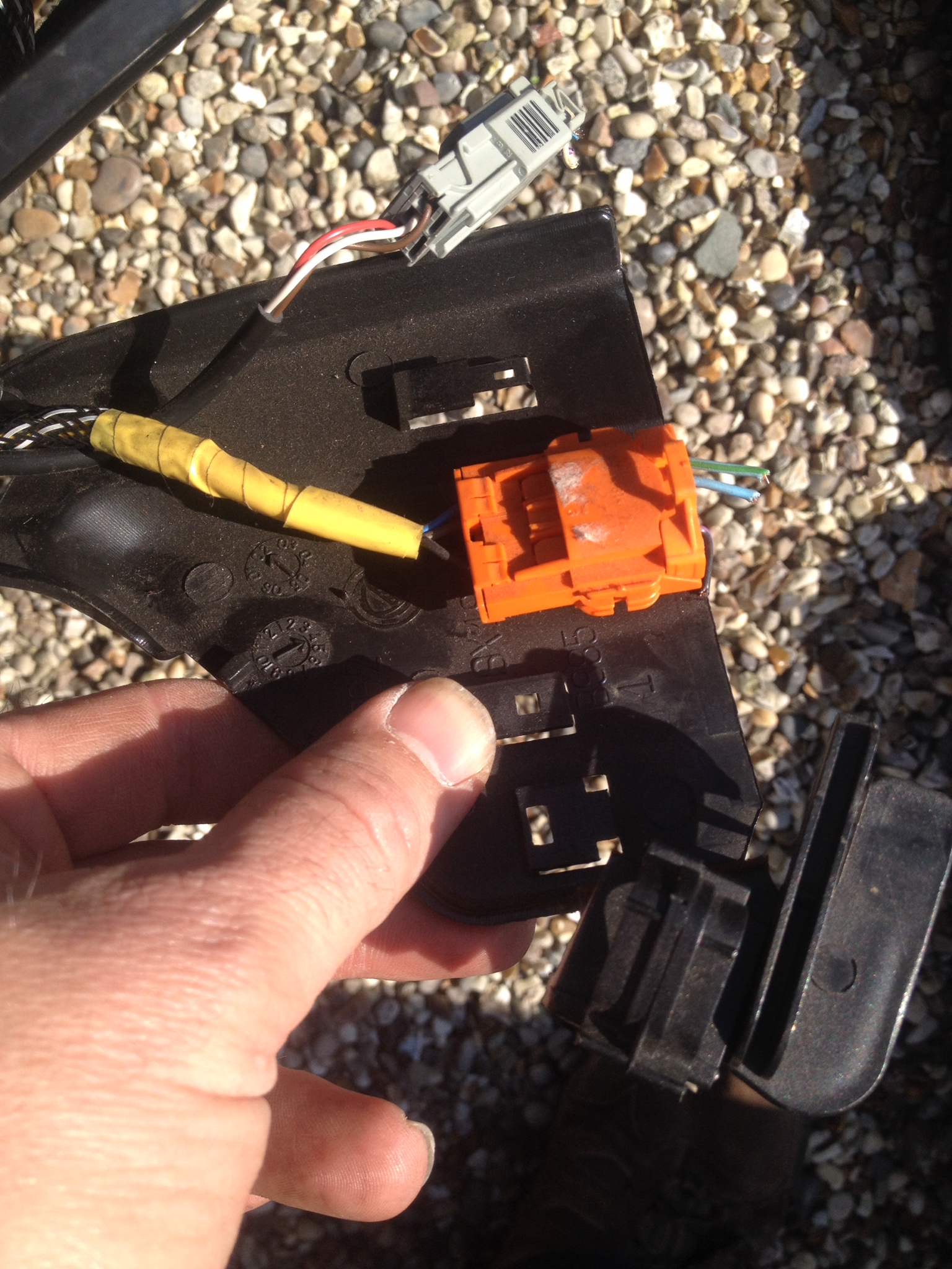

Right went to fit seats today, got the rears swapped, but the fronts have different connectors :confused: for the airbag etc...they have a sticker saying built 2002 (although I was told there newer) my car is an 05 plate.
Any advice?
What's different about the connectors?
The only difference I can think of between the early and later versions, is that after about mid 2003 the front passenger seat occupant classification sensor (OCS) was omitted. That had a 3 pin grey connector under the seat.

Hi
The physical orange connector is different. I'll upload a pic.

I have an 05 plate 3door for which I have managed to get a set of leather seats. The sticker on them says 02. I have fitted the rear, but the fronts have a different airbag socket. Can I chop and solder the connector on the car loom, as I have both parts on the new seats. Or will the actual airbags be different and throw up errors?
I have read the posts on hear but unclear about compatibility.
Thanks
is there a wireing diagram for the different years available?
I have had a look and the wireing appears to be the same colours, so I guess I can resolver the connectors, what is the big black connector is that the heater!

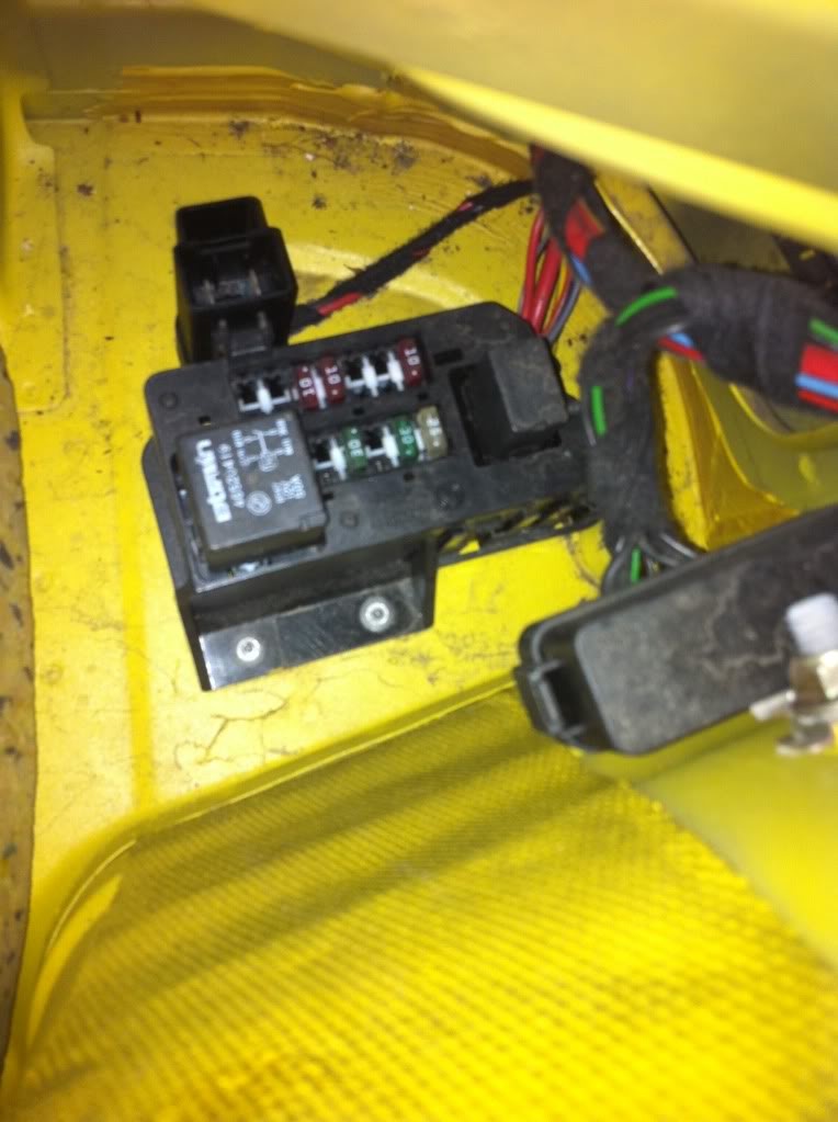

Rear fuse box
Do all 3 doors have a rear fuse box? As I want to wire up my seat heaters? If so where is it as I can't find it!
Ta
