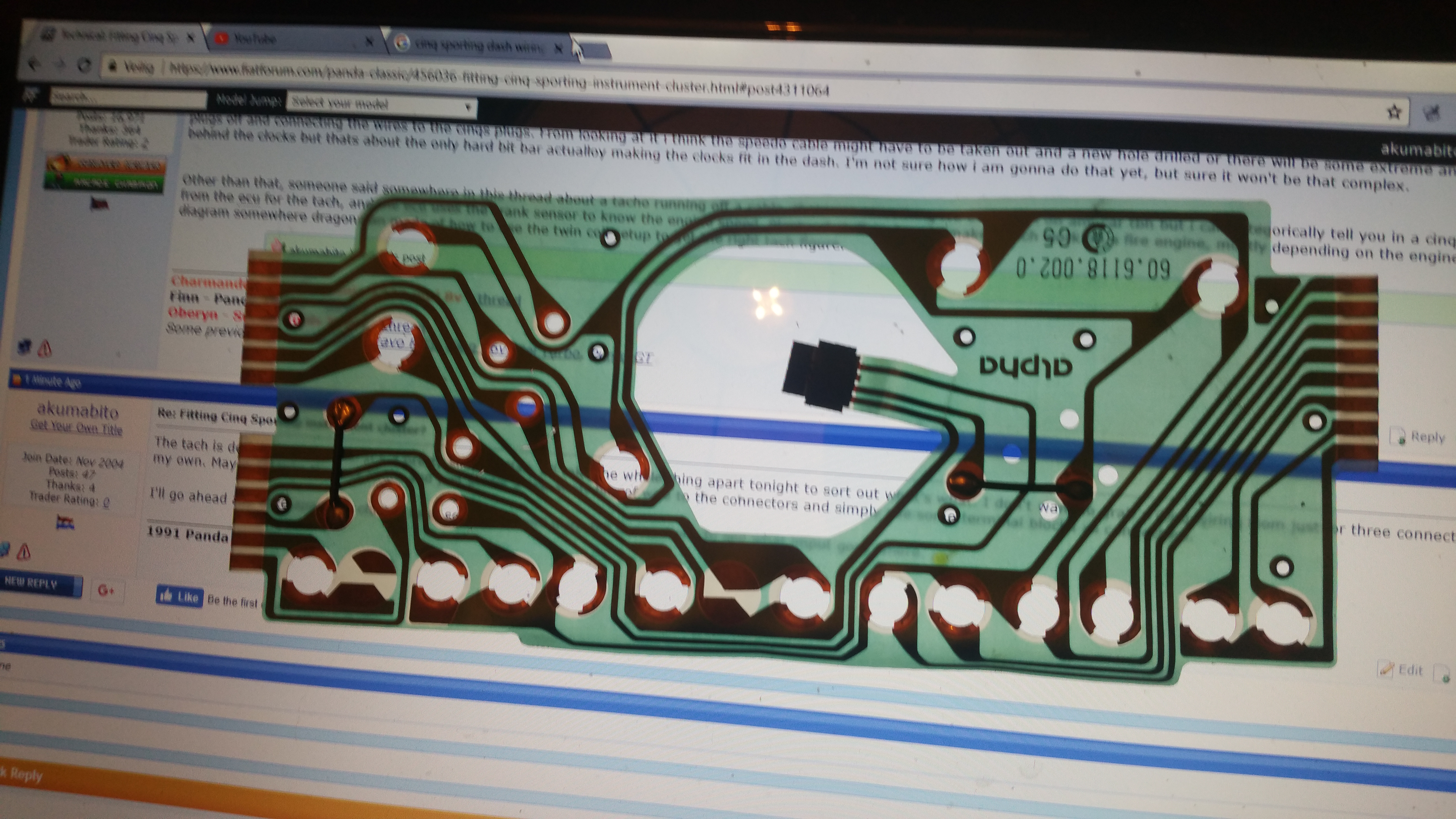

I'll go ahead and take apart my cluster, take some pics, and trace the connections to see what imput goes where. :slayer:
I just took some time to trace the circuits on the 'circuitboard' on the back of the cluster. I've attached a picture so you guys can follow along.
The connector on the top left side connects to:
Pin 1: C1
Pin 2: L1, C2, L3, L4, L5, C8, L14, L13, L12, L9, L8, L7, C6
Pin 3: L11
Pin 4: C3, L11, L10, C9, C4
Pin 5: L10
Pin 6: L2
The connector on the bottom left side connects to:
Pin 1: L9
Pin 2: L8
Pin 3: L7
Pin 4: C7
Pin 5: L6
Pin 6: C5
The connector on the right hand side connects to:
Pin 1: L15
Pin 2: L15
Pin 3: L14, L5, L4, L3, L1
Pin 4: L13
Pin 5: L12
Pin 6: L16
Pin 7: L17
Pin 8: L17, L16
L1 = Dash light, fuel & water temp gauge
L2 = Warning light - fuel level
L3 = Dash light, speedo
L4 = Dash light, speedo, tacho
L5 = Dash light, speedo, tacho
L6 = Coolant temperature too high
L7 = Heated rear window
L8 = Rear foglight
L9 = Direction indicators
L10 = Brake fluid low or handbrake on
L11 = Code
L12 = Hazard lights
L13 = High beam headlights
L14 = Side lights on (numberplate, instrument panel, cigarette lighter lights)
L15 = Injection system malfunction
L16 = Battery low
L17 = Oil pressure low
C1 = Fuel gauge, top connector
C2 = Fuel gauge, middle connector
C3 = Fuel gauge, bottom connector
C4 = Temperature gauge, top connector
C5 = Temperature gauge, middle connector
C6 = Temperature gauge, bottom connector
C7 = Tachometer, top connector
C8 = Tachometer, middle connector
C9 = Tachometer, bottom connector

That's the idea, Blu! :)
I don't have the time to disassemble the Panda's dash at the moment, but I found some good pictures of the back of one of these units on eBay.. It's a little trickier not having the real item in front of me, but I'm sure I can figure out what's going on just from the pics.
