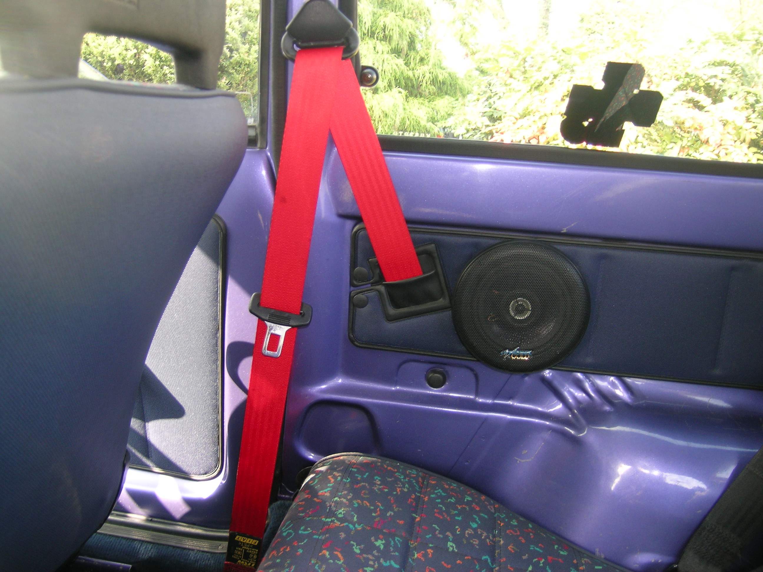

How about some red cinq sporting seatbelts to set off your seat nicely??

Remarkable like those actually! ;) Although mine have the (Patent Pending ;)) wavy seams..... Adds to the chilled out look of the Panda!
Ohhhh Pretty seat belts! (y)

You mean like these??....:devil:...Only kidding..I know what its like when funds are tight!!
