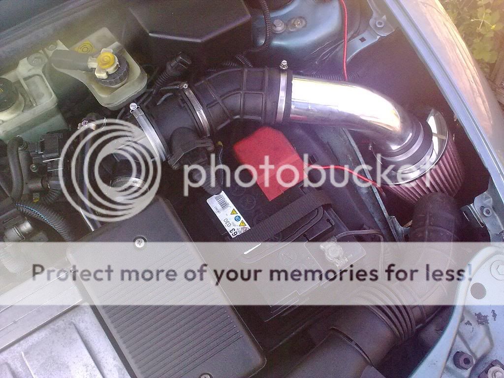

Came this morning, only ordered it yest about half 1 so realy pleased with the service.
anyway its on mow, bit of a pain to do but sounds sweet now. aint been out in her yet but will let u know what its like.

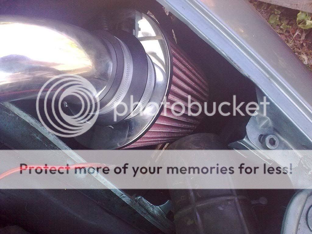

Kirk, I would advise to cover the inner wheel arch vents with something there mate. ( I used dynamat myself(cut down on the induction roar to a nicer note) or when you splish splash through the puddles, it'll get flung up on your nice clean 'breathable' filter and clog it. Maybe even ruin it.
cheers for that mate.don't mean to sound thick but what is dynamat?and where can i buy some?
Kirk,
Dynamat (name brand) (other available) is a sound acoustic absorber, usually sold in a self adhesive mat form. Car shops, or Maplin. Check prices as its good, but not cheap.
